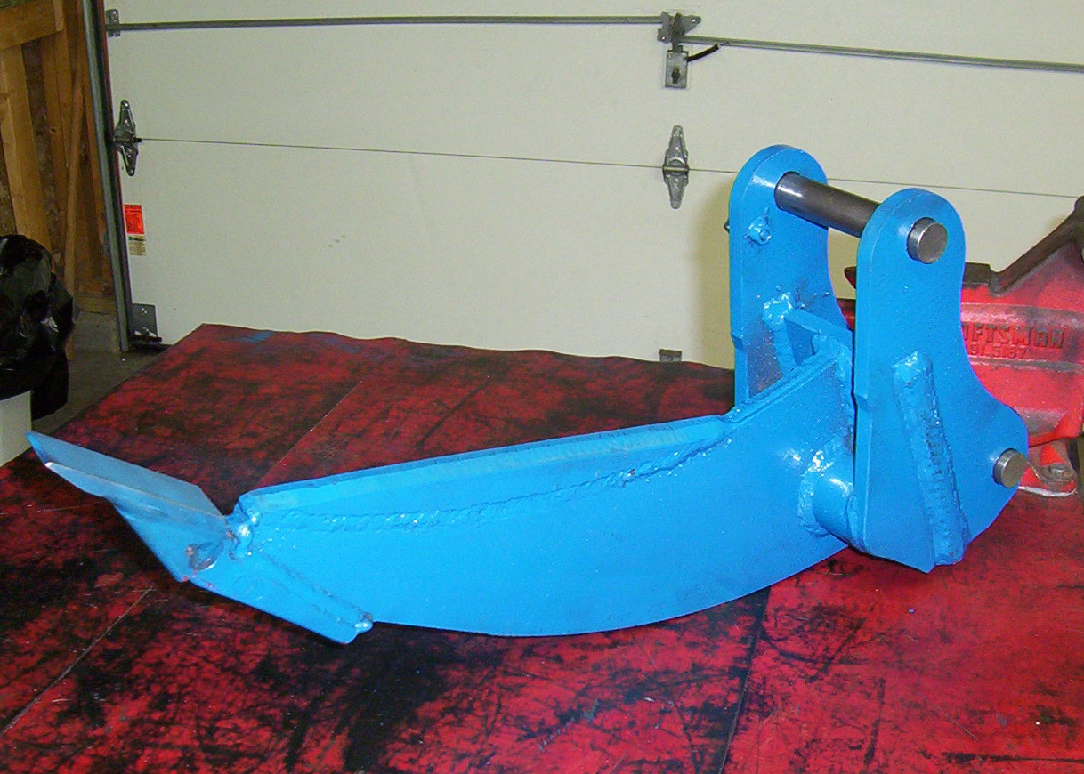

I bought a Ripper Kit for my Woods BH. Used it for plucking out small stumps and such, so I didn't tear the dickens out of everthing. They were quick shipping, and everthing fit perfectly. I'd definately buy from MetKit again.
