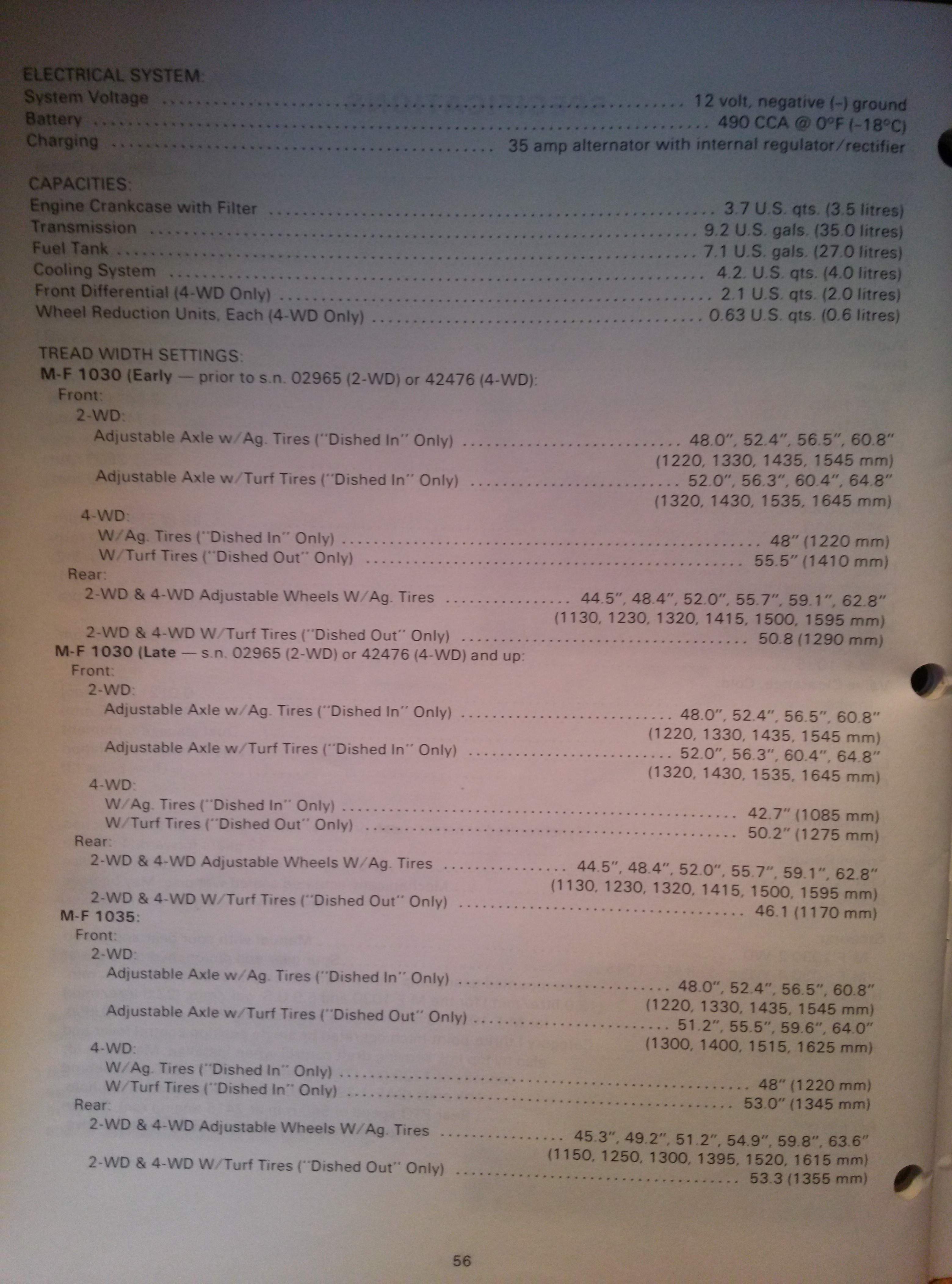

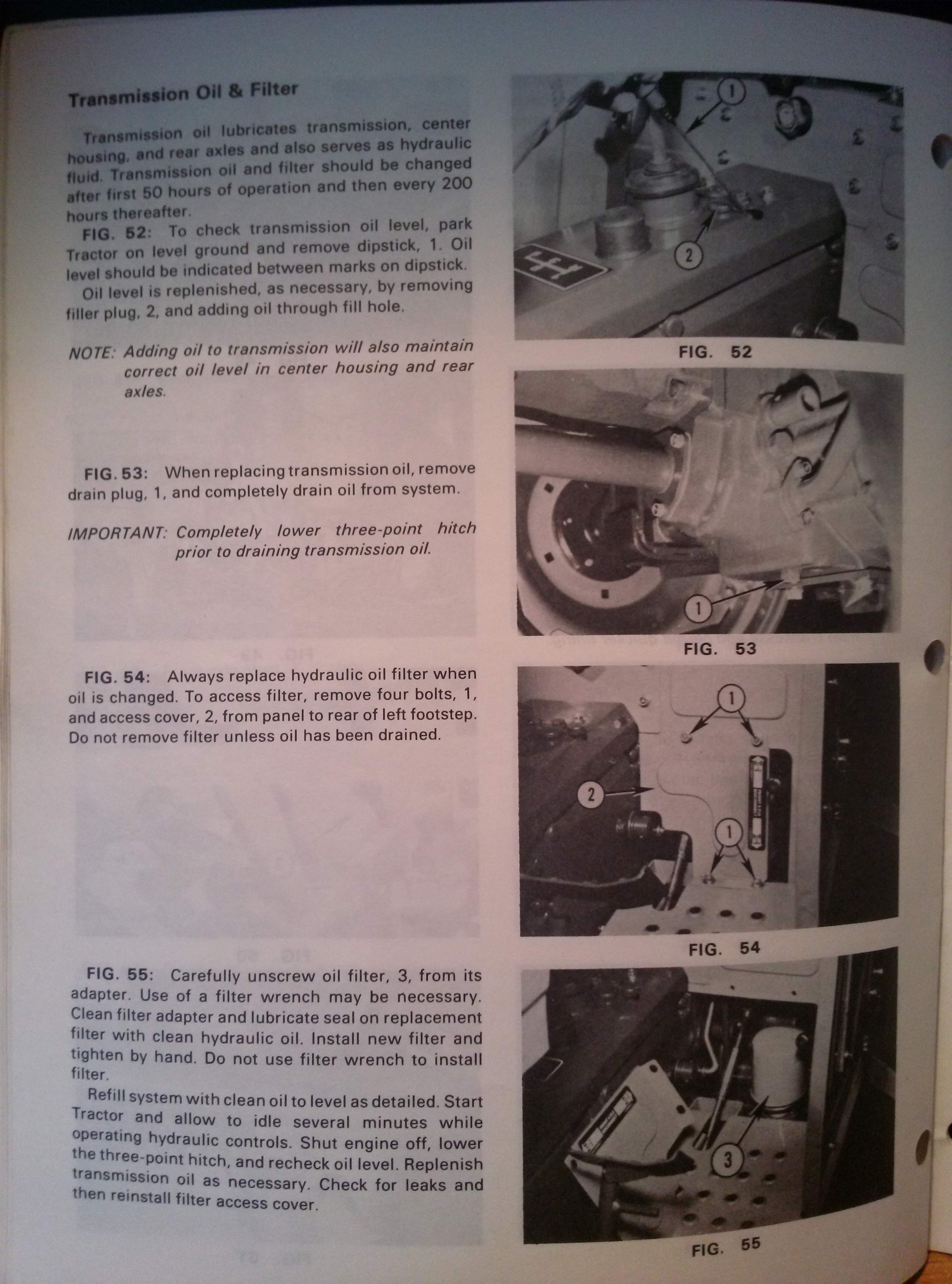

:tractor:I have a 1035 and my book says Permatran III for the Hydraulic System. Capacity is 9.2 U.S. gals, mine is a 1990 and it refers to the permatran III superceding the previous Massey M-1129A lubricant. I dont know if that would apply to the 1987 or not. This info is from my owners manual but there is little difference between the two machines. Not sure what you can use to flush it but have heard kerosine works to clean out stuff like gear boxes etc.. Hope this helps

That large rubber plug should be the filler location for the fluid. On my 1010, it just pops out. Note that it's almost impossible to get all of the old oil out, so you may not need as much to refill as the manual calls for. My tractor is a 1010, and it called for 4.5 gallons I think. I had a gallon left over when I was done.
If your 1030 is built like my 1010, the drain plug for the fluid is at the back of the tractor beneath the drawbar sleeve. Wherever your drain plug is, make sure you are parked on an incline so most of it can drain out the plug hole. Have several 5 gallon buckets handy too!
