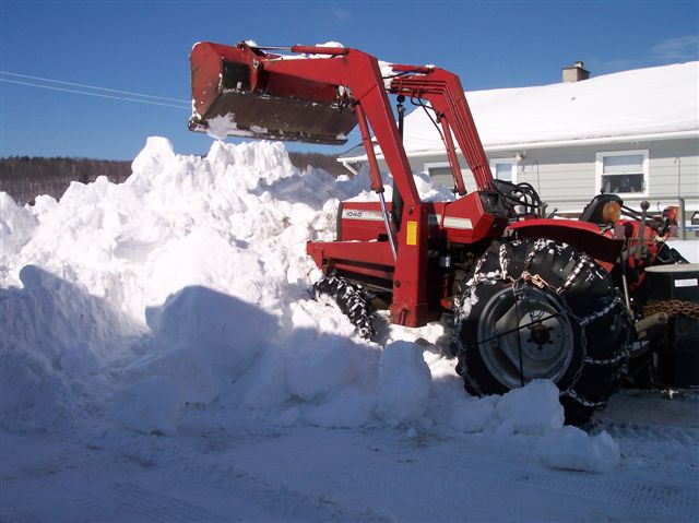

As I said over on the Massey board, the MF 1030 should do what you want but Im in favor of a bigger tractor with more HP and weight for your purposes. My MF 1040 is 3800 lbs without the loader and Im guessing about another 1200 lbs with the MF 232 loader. I have about the same amount of property as you and I wouldnt want to go any smaller than I have now !
My vote is the bigger tractor!
