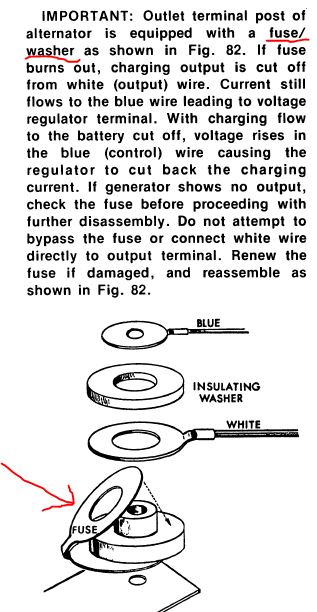

Hey folks,
So the charging system on the MF 1080 I recently purchased doesn't charge the battery. I knew it going in, and the previous owner used the tractor sparingly and kept the battery topped up with some small solar panels. I would like to fix it properly.
It has a relatively new rebuilt alternator on it. But still doesnt charge. Previous owner figured it was probably the voltage regulator but since as I said it got used minimally, didn't bother to fix it. I have purchased the voltage regulator, but in going through my shop manual, it mentions there is some sort of fuse washer that can burn out and will cause the battery to stop charging. It says to check that first. In searching for a replacement, I can't find it. The only place I can seem to see it referenced at all is in the shop manual.
Anyone know of these? Also, any tips or tricks to replacing the voltage regulator?

AGCO part number 513983M91 (Fuse Assembly) for alternator.
   / MF 1080 Alternator and Voltage Regulator
Spectacular, thanks! I couldn't figure out that part number for anything. Perhaps I need more practice in the Agco parts book.
   / MF 1080 Alternator and Voltage Regulator #5
On some parts you really have to look closely in the parts book, sometimes some parts aren't in the section that you would think it should be in. The fuse is listed in the electrical wiring section instead of the alternator section.
