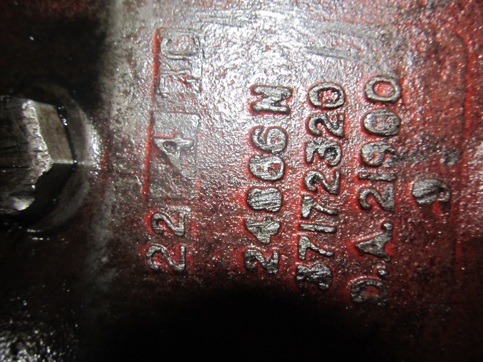

Just purchased a MF 135 3 cylinder diesel engine and need help identifiying the year made and where it was made.One of the block # is CKN1842, there is a small metal plate on the instrument panel that says 135 406947 the casting #'s on the oil pan are attached in the photo. think it might be 1972 but not 100% sure.
   / MF 135 Identification help #2
1964: 641000001
1965: 641001909
1966: 641014871
1967: 9A10001
1968: 9A39836
1969: 9A63158
1970: 9A87325
1971: 9A107519
1972: 9A128141
1973: 9A152025
1974: 9A182761
1975: 9A207681
The tag on the dash should have your year built #
That's our problem it doesn't ,the only one on the dash is 135 406947.

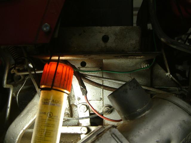

The S/N tag on my 1964 MF135 diesel is located on the right side of the battery tray. You have to remove the air filter housing to see it.
Good luck
   / MF 135 Identification help #6
Suppose you have a English built tractor, the serial number is on the dash.
