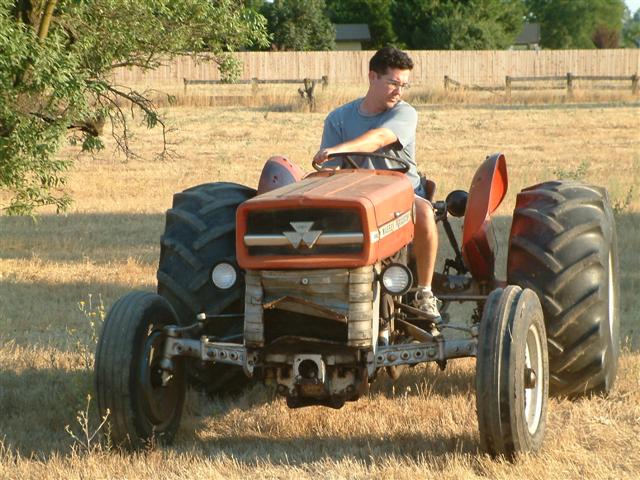

If you're buying that 135 because it has the FEL, then I'd pass--the price is high and the 135 is not a particularly good FEL tractor (the 135's front axles are not strong--the MF150 is a better FEL tractor).
I paid $3600 in Jul06 for my 1964 MF135 diesel deluxe with multipower. You can see from this photo how spindly the front axes are.

Also, you really want power steering on an FEL tractor. The 135 has power-assisted steering--a poor man's power steering, not very powerful--you still have to wrestle the steering wheel quite a bit even without an FEL attached to the front end.
Unless you really, really want a 135, I'd say pass on this one and keep looking.
