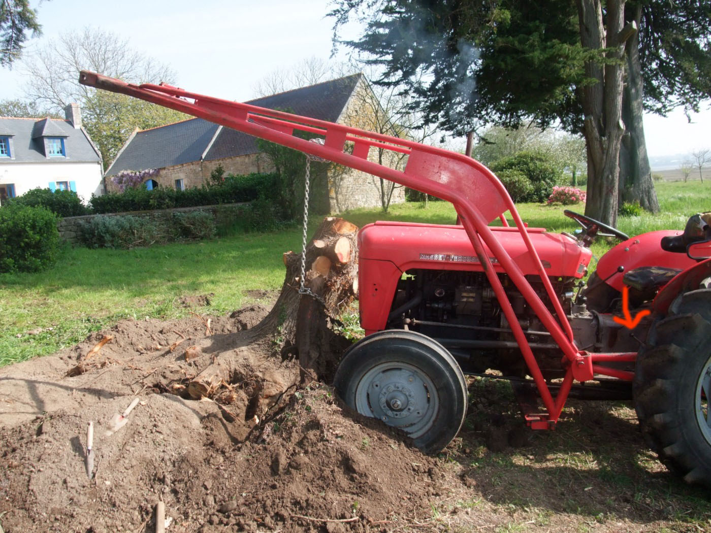

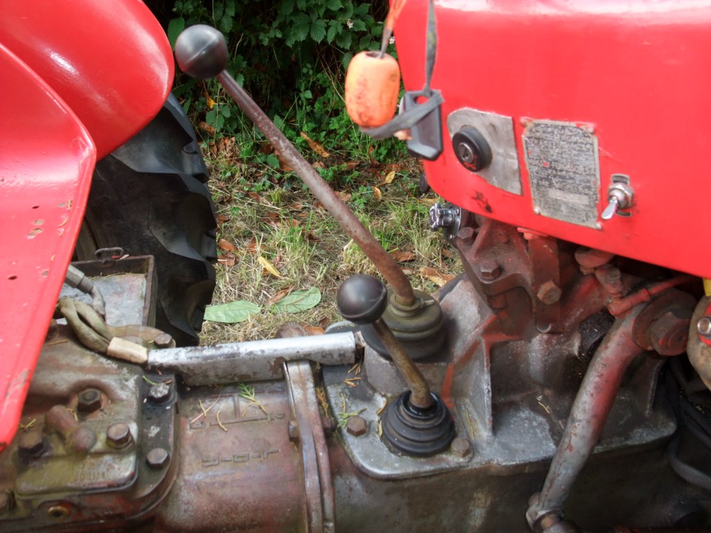

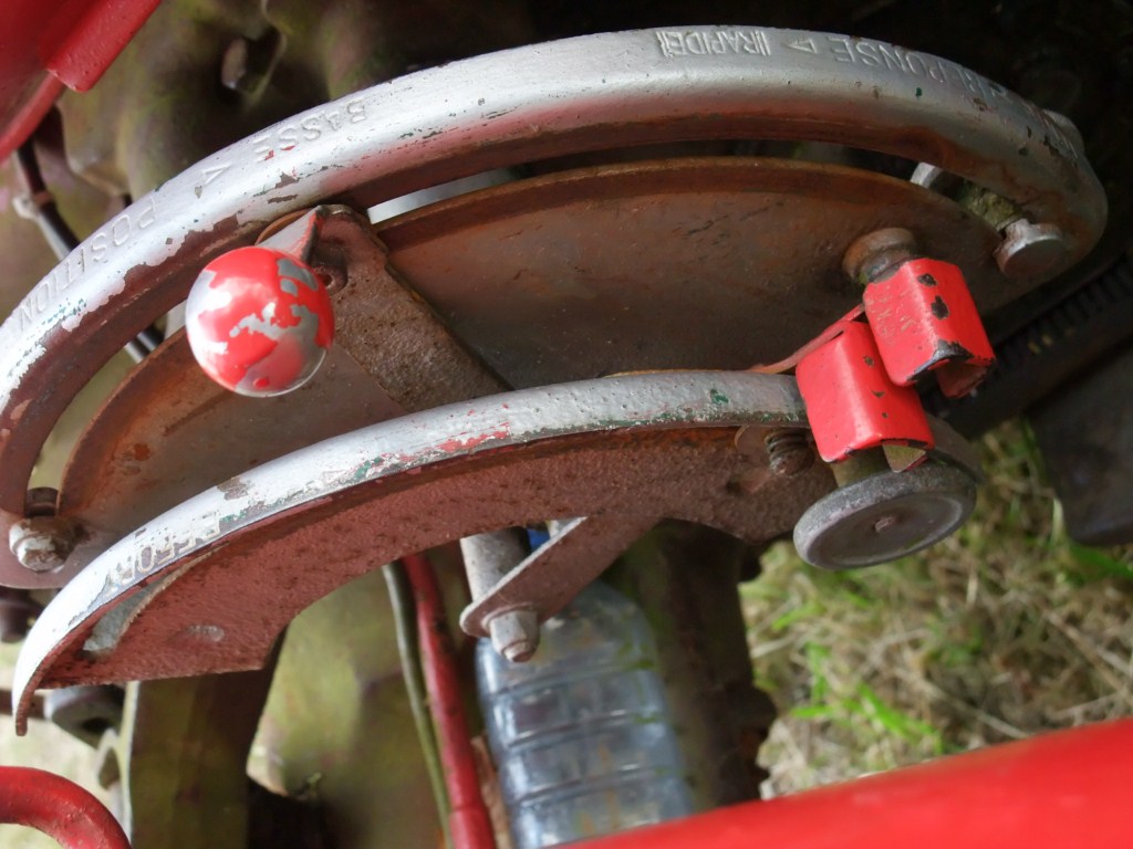

I have an 80s model 135,,,can some one tell me how to set the ign. timing how to fill the hydralic and the transmission,,,,,,,,,,,,also i cant seem to shut off the pto??? and what areall the levers are for??

Pic one shows the 2 gear levers, the long one for three gears forward and one reverse, the shorter one to switch between high and low gears.
Pic 2 has a red arrow pointing towards the lever for the PTO, engine speed, wheels speed or stopped.
Pic 3 shows the 2 levers working the 3 pt hitch.

In pic 1, sitting in the seat, if you look beside the left shifter, you will see a plug, that is how you fill the teams. Only 1 fill hole as it is a common reservoir.
