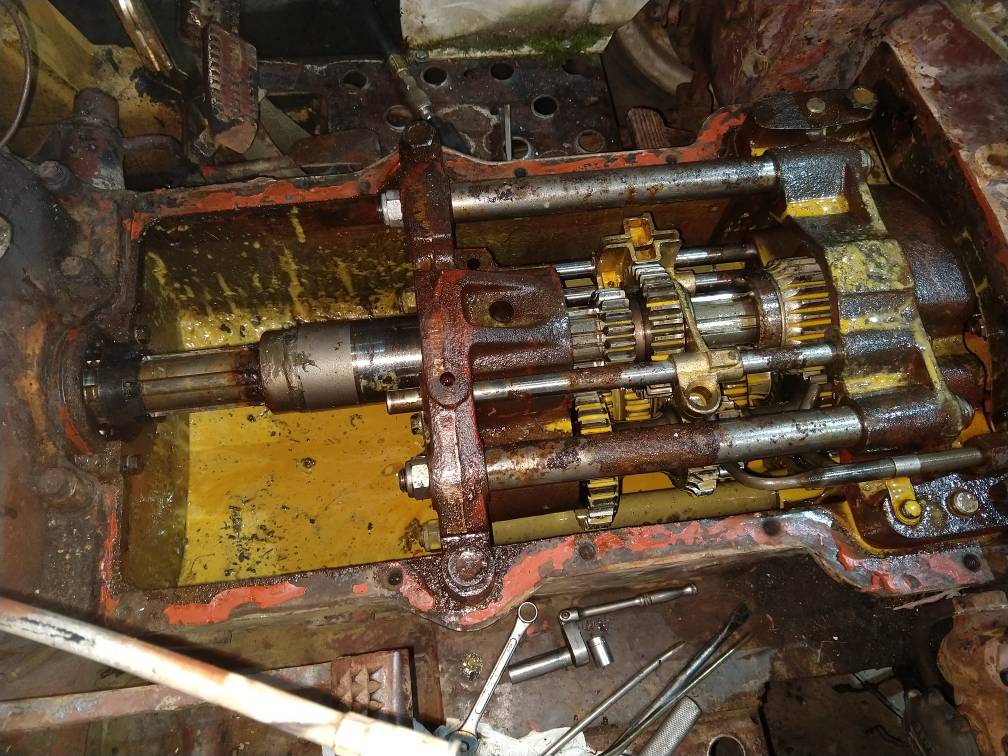

I have a 1968 mf135 deluxe gas 6 speed that if I put it in neutral while the tractor is still moving will lock up the gear train. I've fixed it by opening the transmission oil filler plug and using a bar I can move the gear free. I make a habit of not moving the gear selector to neutral until stopped. My question is what do I need to fix?

Worn ball of the gear lever, weak springs on the shifter axle, you must lift the steering gear and splitting it between gear box and center housing.

could it be a bad shifter fork?

Agvg the gear is always forced forward towards the steering gear casting and gear slides back easily on the rail once impingement is relieved
It's possible, it is more likely to be the ball on the lower end of the shifter or the ball and socket that the shifter mounts into.
If those are sloppy it will let the shifter fork slide back and forth more than it should which will let it jam into multiple gears at the same time.
Here is a picture of a fairly simple six-speed transmission, 3 forward gears and a reverse gear (far side of the transmission) and high/low (near side of the transmission):
If your transmission is a more complicated one, say an 8-speed where there are 4 forward gears and reverse gear, you would have three sections on the far side not just too and when they are not engaged, unused gears are held in place by the little detent on the shift rail. If that detent is not still holding firm it could slide into gear while you are still in another gear.
