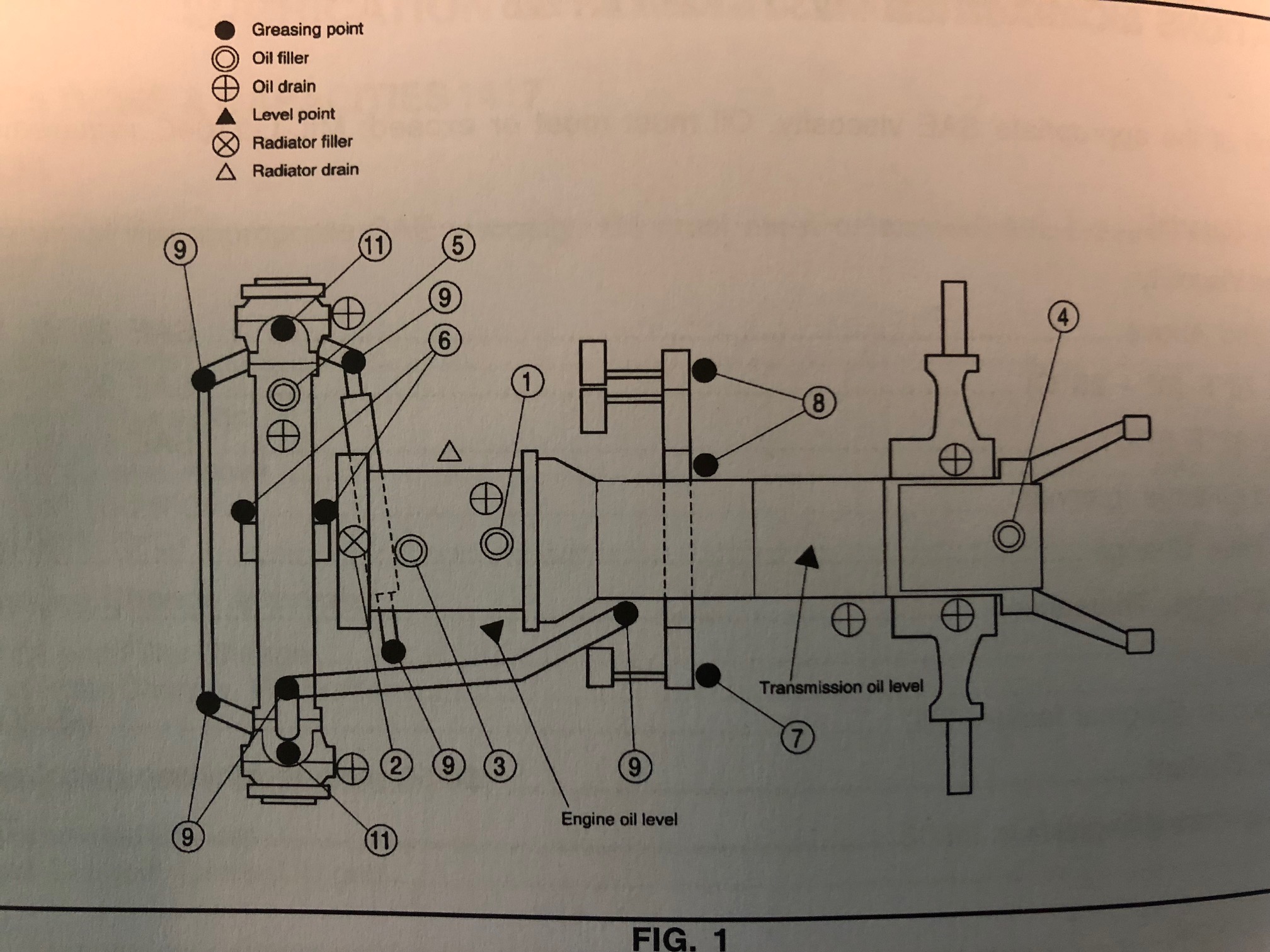

I ordered the service manual and it has an arrow that shows "Transmission oil level" which looks like it would be right in front of my seat, but I don't see anything on the tractor.
Here is the page from the manual:

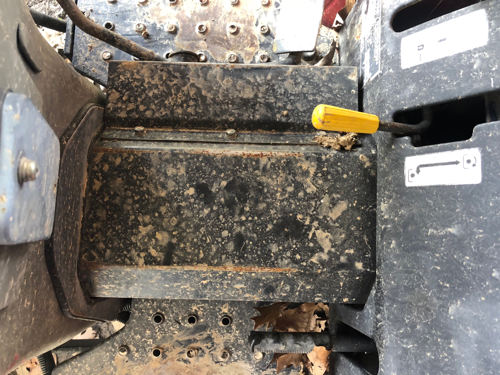

Here is a picture of the tractor right in front of the seat:

Permatran III is for the hydrostatic transmission it is totally different than SAE 80. SAE 80 might be used in the manual transmission. You can get Permatran III at NAPA. See if there is a dipstick for the transmission behind the seat, by the 3 point lift arms.

There may be a sight glass on the rear end of the tractor or on the side of the gearcase to check the oil level rather than a dip stick.

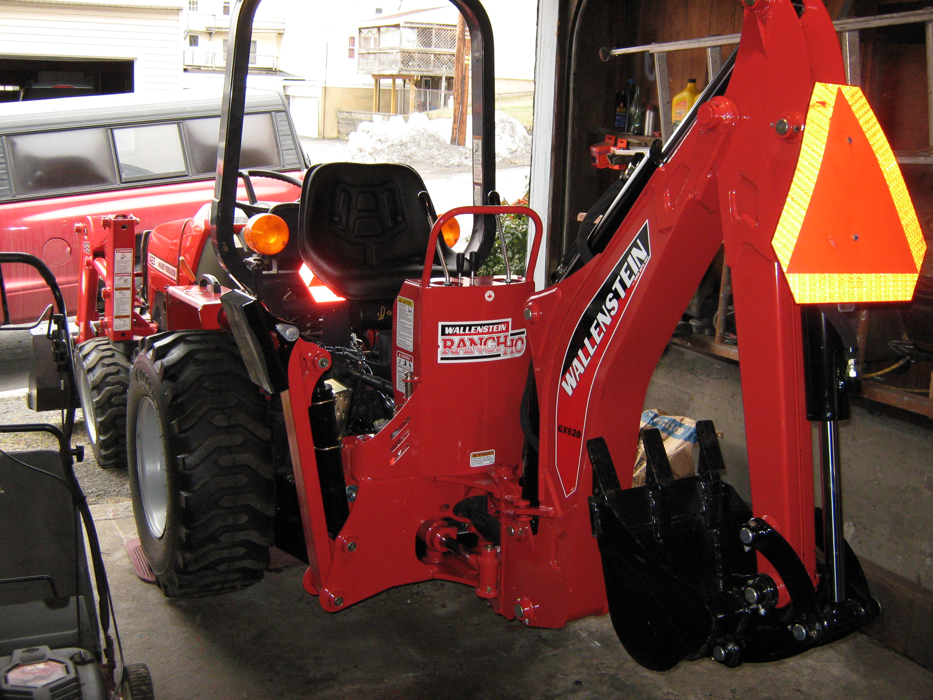

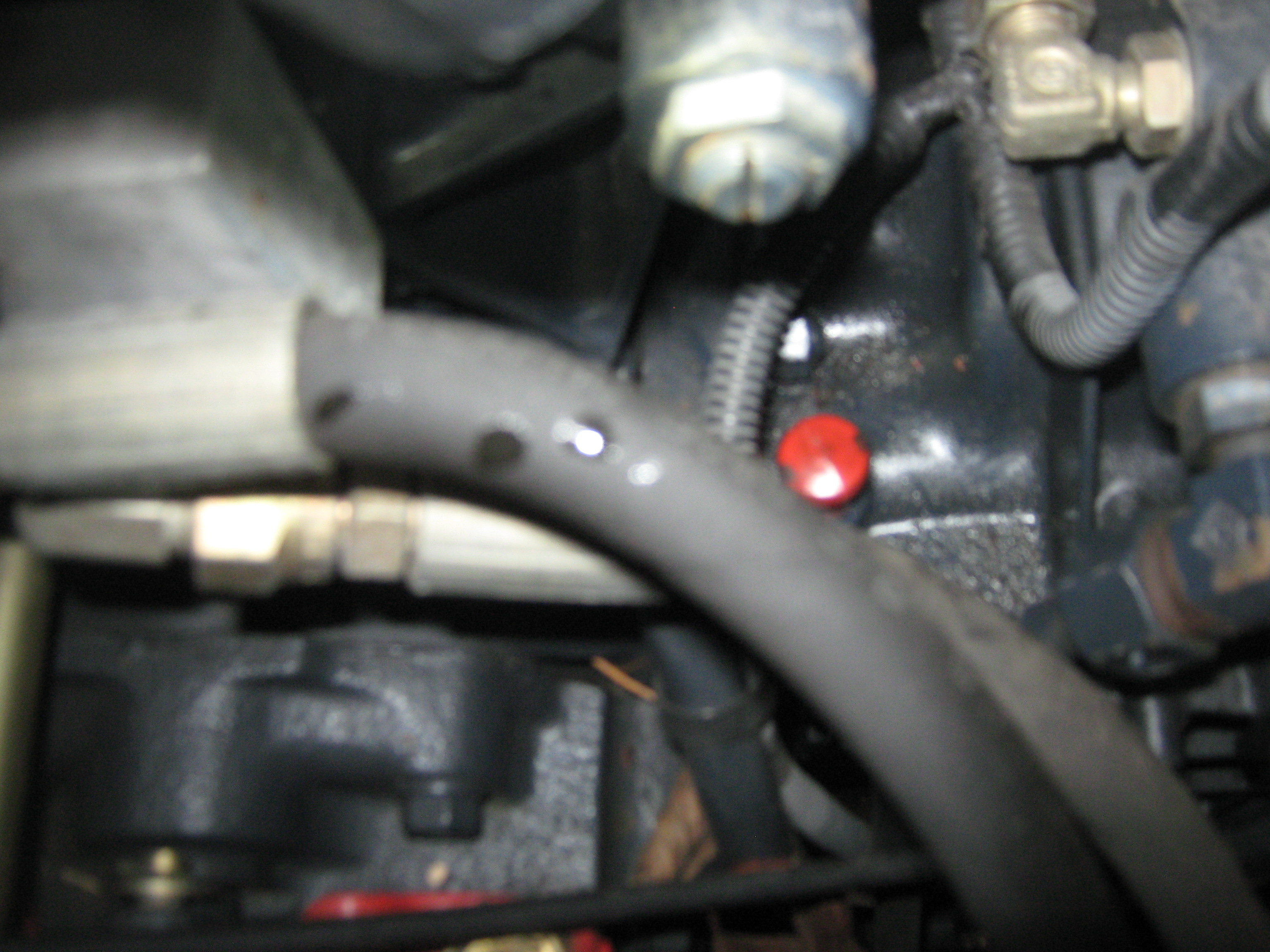

I can show ya . It's on the right side of the seat. the dip stick. I can show ya a picture , when I get out to the tractor . Copy of Copy of wallenstein gx620.JPG
   / MF 1423 Hydro - Need help with hydraulic fluid
   / MF 1423 Hydro - Need help with hydraulic fluid #9

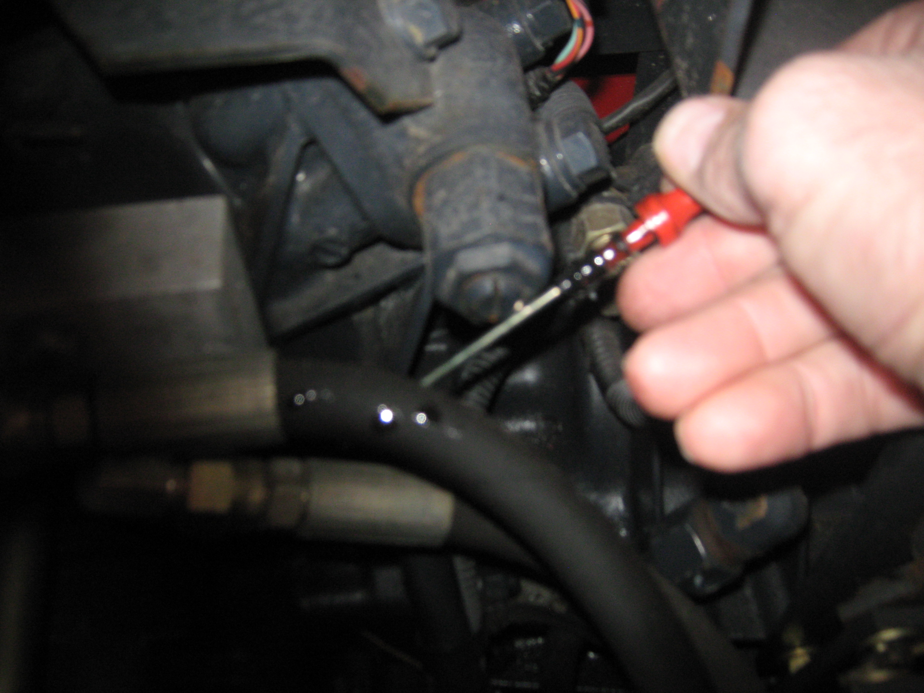

IMG_1692.JPGIMG_1690.JPGHere is some pictures congo. First picture you can see the knob.
   / MF 1423 Hydro - Need help with hydraulic fluid #10
