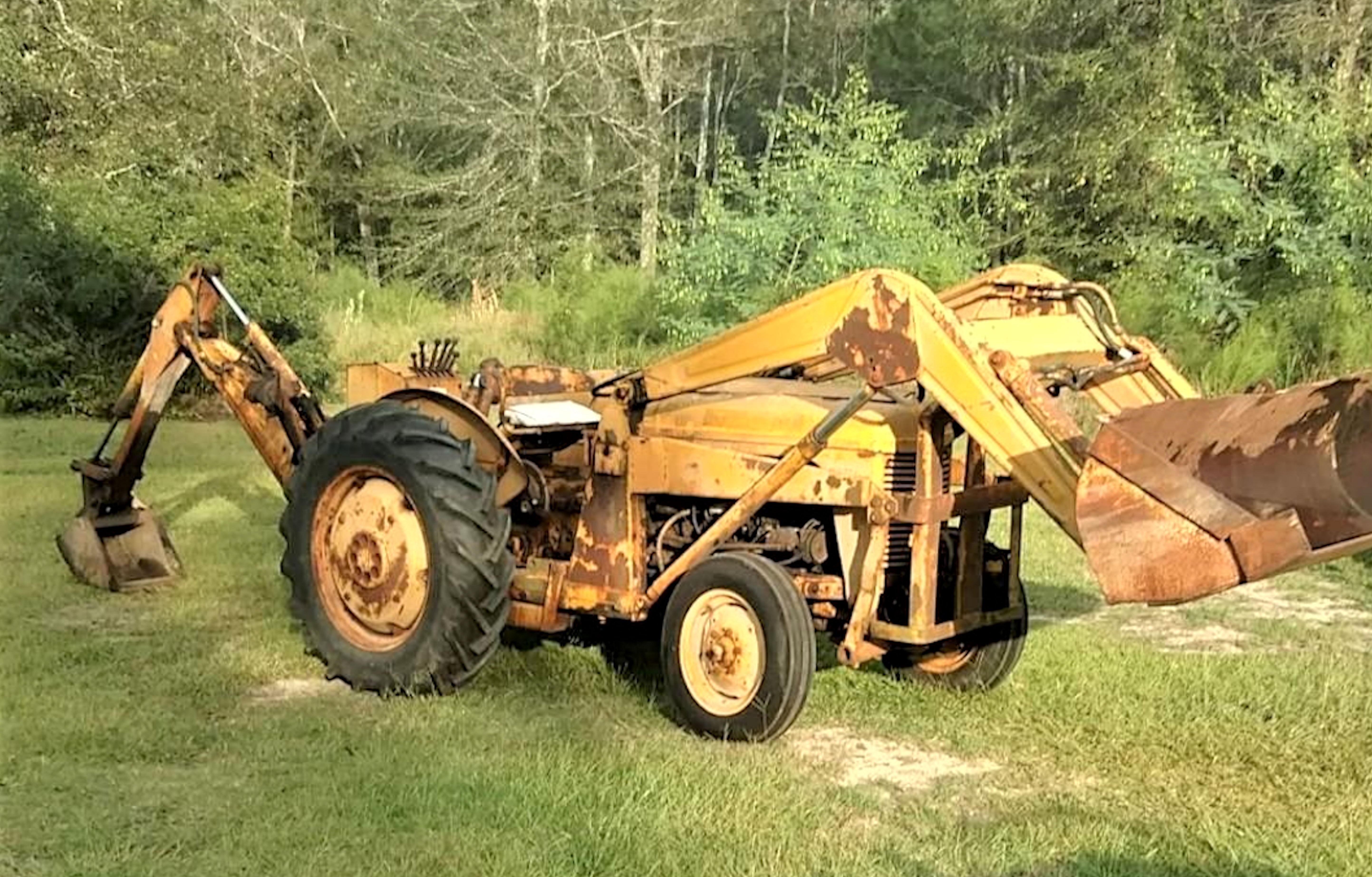

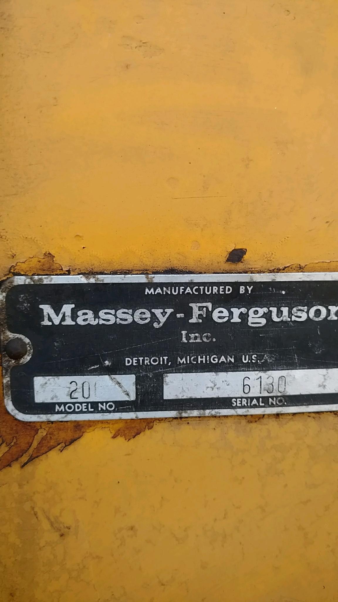

I have not gotten a book on this yet and since the flood I had to drain it. Does anyone have an idea what type of fluid and roughly how much it would take? It is early 60's so it could be motor or hydro oil.
   / MF 200 loader attachment Model 201 #2
I use AW-32 Hydraulic in mine 6 gallons but with a backhoe on back should take 9 gallons
