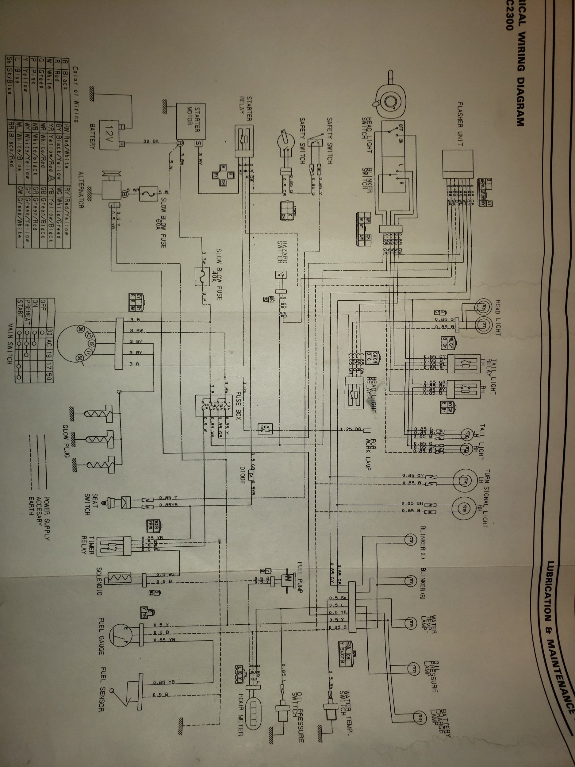

Hello, I have a mf gc2300. Recently while using the tractor I shut it off and it would not restart. The 40A slow blow fuse to the starter was blown. I could not find a short in the wiring on either side of the 40A fuse with a continuity tester. I checked all of the wiring visually on the tractor looking for a short or bare wire. I replaced the fuse and used the tractor all day with no problem, on and off the seat but never shutting the tractor off. When I parked the tractor I shut it off and did a restart with no problem but i noticed that the fuel gauge was quickly going to zero and the lights no longer worked, then the tractor would not shut off.
I shut the tractor off with the plunger switch on the fuel pump and found the 40A fuse blown again. Again I could not find a short with a meter. I then removed the ignition switch and found the back with the wires completely corroded. I have read most of the posts on this site and understand that the ignition is a common problem. I am leaning toward the switch shorting causing the fuse to blow as it happens during a starting operation.
The question is, Has anyone had luck cleaning the wire corrosion and reusing the switch or is the problem internal to the switch? I am trying to avoid buying a new switch.
Also, I think that I have determined that the wiring diagram is inside the repair manual and not in the operator's manual. Can anyone confirm that the wiring diagram is in the repair manual and if so, is the diagram readable? The diagrams that i have found on the internet are unreadable when i zoom them enough to be able to follow the wiring. It looks like the diagram may have a box at the switch location showing what connections should happen at each switch position.
Any help appreciated,
thanks

Unfortunately my tractor is normally stored outside and the tether for the plastic ignition switch cover broke early on. I figured the way the key is made, leaving it in all the time would keep water out of the switch. It did last about 15 years. Recently I did have to replace the switch because mine was corroded and would pop fuses or just not work. I didn't use an MF switch and had to make some mods to get it to work.
My operator manual has the wiring diagram near the middle but I took a picture. Hopefully it's legible.

Thanks Lou,
I am going to try to clean up the switch and cover it in dielectric grease before I order a new switch.
The diagram that you provided is the most readable that I have seen so far.
JM

I looked at the schematic I sent to refresh my memory.
Other than the smaller fuses, the 40 Amp fuse's main point is to feed the starter and the glow plugs.
So if you have confidence in starter, I would check resistance across the starter when cold and hot also to ground. The glow plugs resistance can also be checked but I don't recall what it should be. I believe there is a connector on top of the engine to disconnect the glow plugs. Keep in mind the glow plugs are active when starting. Disconnect battery and check resistance to ground with ignition switch off and on.
When my ignition switch crapped out and the contacts rusted out, the glow plug pin wire on the switch would short to ground sometimes.
Hope this helps.
Lou

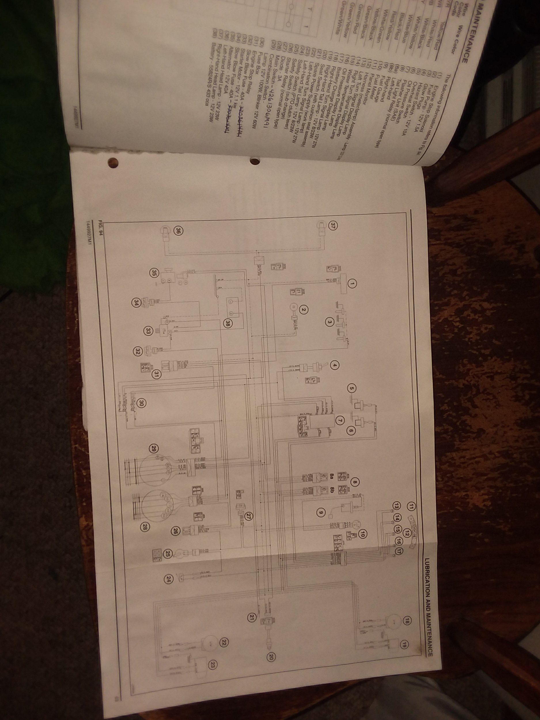

Lou, I see what you mean.
My schematic is a little different than yours, probably due to s/n. my s/n is JPA20652.
The schematic in my operators instruction book is a bit confusing. the drawing shows two different fuse numbers for the starter and alternator but when you follow the two numbers back to the drawing key they are both 40A. And The page in my book just before the schematic says that there is a 60A SB at the alternator.
Do you think that the starter relay has any thing to do with the problem or is it protected in some other way?
thanks again.
JM

Looks like you found your schematics, unfortunately I am unable to clean the image enough to read yet. I will work on it more.
Lou

Lou, 2nd attempt at schematic upload.
JM

I do not have a DC current clamp. I was re-checking some voltages and testing the glow plugs when I noticed smoke coming from the bowels of the tractor. I started removing panels and parts and tracing the glow plug power wire under the motor until i found the short.
The short was at the metal spring steel that wraps around all of the wires holding them to the motor. The vibration had worn through the rubber coating on the spring steel and through the harness loom and then through the glow plug power wire which seemed to have a very tough teflon insulation. I made a repair to the glow plug wire.
I also replaced the ignition switch because at least once the tractor would not shut off while not having a blown fuse and the switch was very corroded.
That was a real head scratcher. The tractor seems to be back to normal.
Thanks for all of your help.
