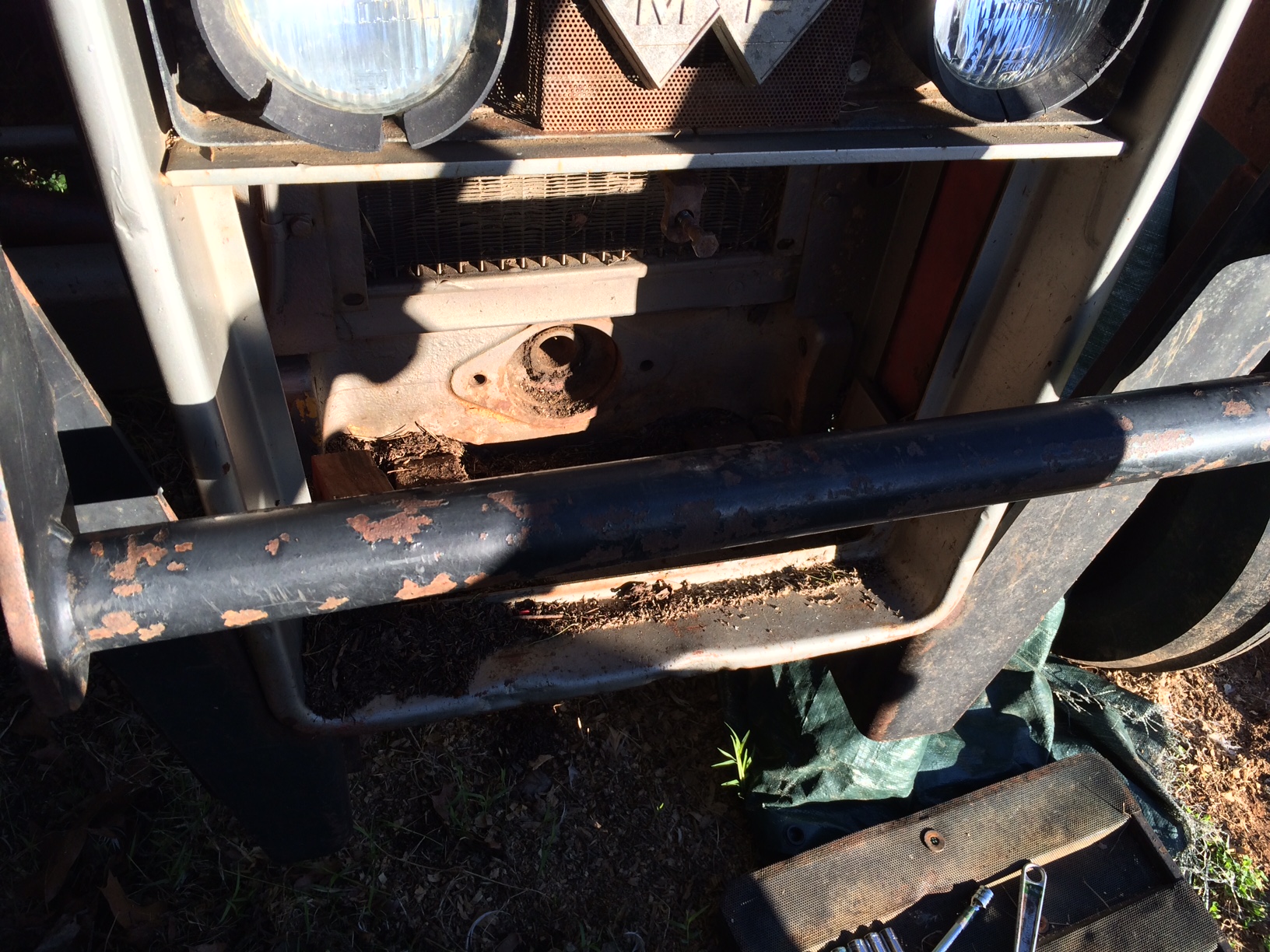

Hoping someone can help me with two things:
1. What size hydraulic pump I need
2. Where I can buy one that will bolt on to factory holes
The tractor is a 1979 MF 245. The loader is a Woods 1020 (pretty heavy).
I want to mount a front pump as the between the legs pto switched line is not enough to pick up much at all. The prior owner was trying a PTO mount pump and it blew the line during the test drive when I was buying it.
Can anyone speak to the size pump you would recommend for lifting the Woods 1020 and a load? I have a reservoir and can handle hoses, etc.
Attached are pictures of the front mount. Can anyone recommend a make/model/solid supplier. I have contacted some already and not found help.

The internal hydraulics should make plenty enough pressure to lift it but would be slow. Most MF industrial loaders used a 17 GPM pump but I think for a farm loader something around 12 GPM would be fine with a 2000-2500 psi relief valve. An MF dealer should have the pulley, shaft and coupler for mounting a front pump. A&I or another aftermarket parts supplier may have them as well. A good hydraulic shop should be able match a pump to fit the holes and coupler.
   / MF 245 Paired with Wood 1020 #5
You may find a pump on surpluscenter.com, like above 17-25 gpm should be fine. You could make an adapter plate if you have to.
   / MF 245 Paired with Wood 1020 #6
25 GPM would be too fast and likely require high flow spool valves.
   / MF 245 Paired with Wood 1020 #7
The pump only produces it's maximum output at maximum rpm, given that situation the oil only has to pass through the valve, the operator selects how much to pull the control lever. I think you may be speculating.

Yes, correct sized pump and valve. 25 gpm would also require a larger reservoir. The industrial tractor loaders also used heavier duty components than a farm loader. If you try to use a farm loader like an industrial loader you're asking for trouble. I think a pump in the 12-15 gpm range would be ideal. 25 gpm would be serious overkill and require everything else to also be bigger. High flow is relative but I didn't pick a number out of thin air. I based it on what the industrial version of the same tractor(MF20C) with factory loader came with, a 17 gpm pump.
