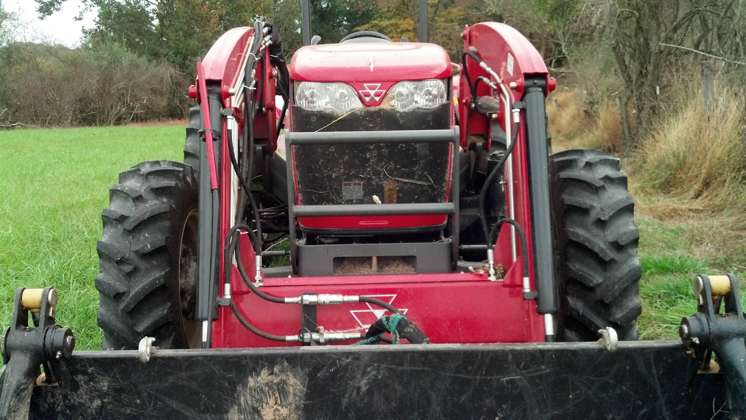

I have not seen aftermarket sources for MF grille guards ... but that means very little. Take a look at TractorData website on your 2607 and there is a picture showing a grille guard on it which looks very simple and has only one cross bar to it. The photo is not good enough to use for info on making one. My MF 2660HD is probably very nearly the same frame construction as yours. It uses 2 cross bars and is very strong. See photo below. Don't have a better picture and am a long ways from the tractor but it is just bolted to the frame on each side. Mine was added when the loader was installed by the dealer. You can bet one thing -- you will not want to pay the price for an AGCO parts dept version !
Mine has 2 fairly hefty bolt holes in the frame on each side. It would be a very simple project for a welding fabrication shop to make you one. If you do that, be careful to leave enough space behind it for the hood to open and various other needs and space in front of it to clear your loader, etc.
You can probably go to AGCO parts on line and find drawings of the one for your 2607.
