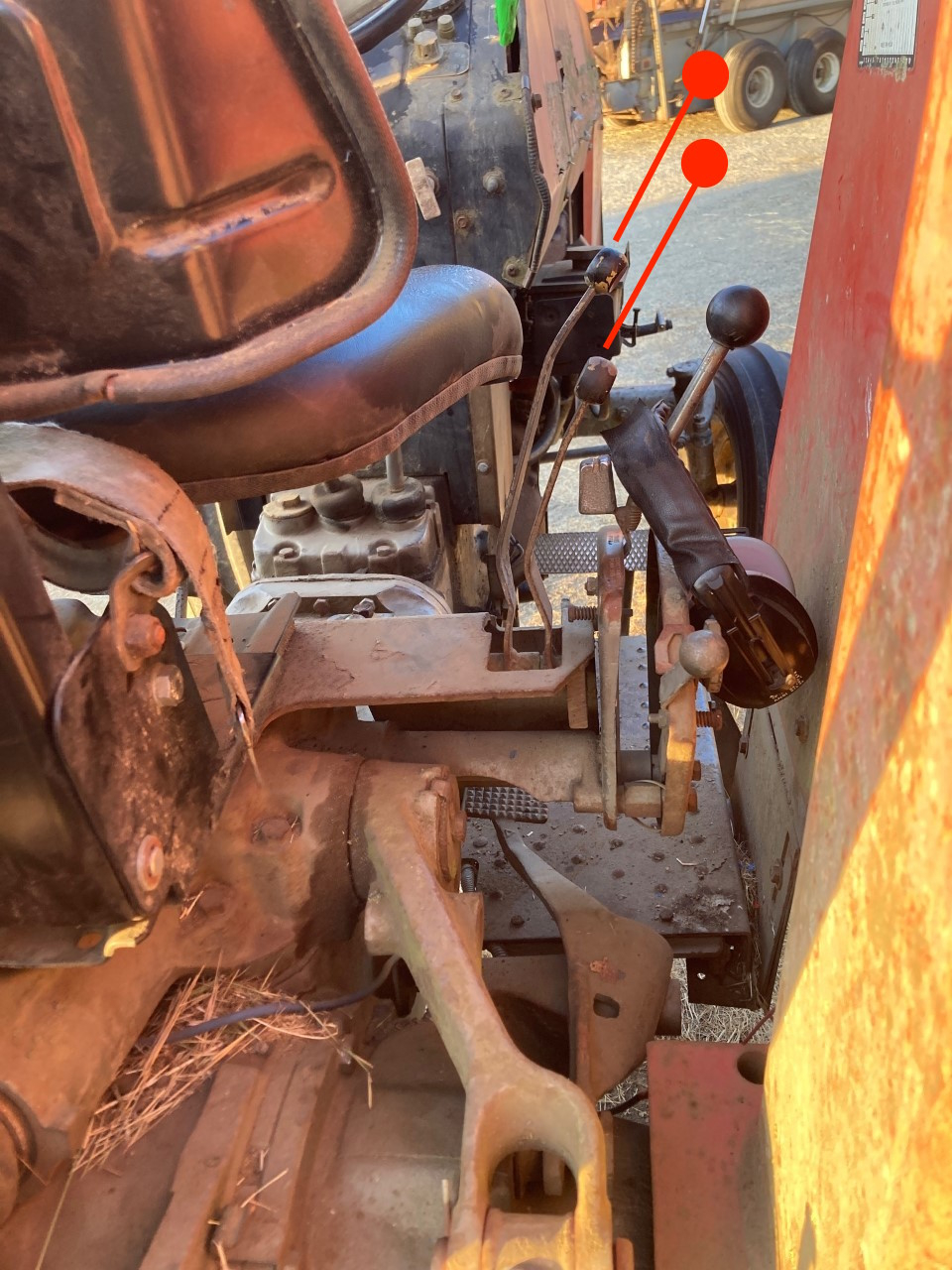

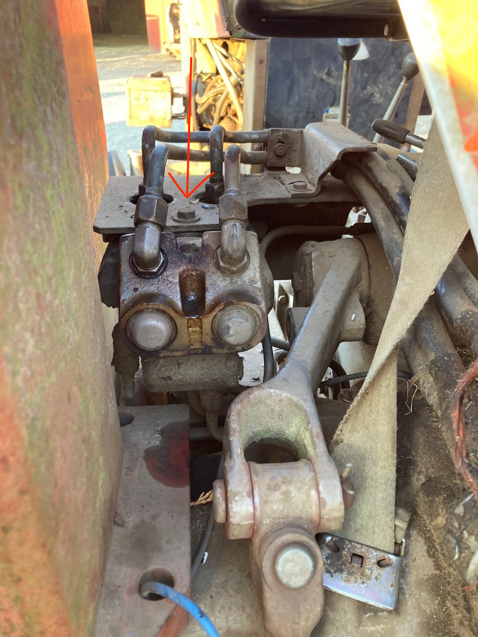

Hi All!
I'm working on an early series Massey Ferguson 275, in which both levers that operate the remotes are very hard to move. In the time I have used this tractor, they have never moved easily, but now it takes tapping at the lever attachment with a hammer to get them to budge. These levers run on a shaft, under the seat cover, to what I would call a hydraulic pump.
Searching AGCO Partsbook for the hydraulic pump and hydraulic lift pump produce images that don't resemble what I am looking at. Perhaps one of those is correct, and there is a portion that bolts on...
What is the name of that pump that the remote levers lead to?
Any thoughts or advice would be appreciated as to what you all might think the problem is... the 3 point lift works and has capacity to lift a round bale with ease.
Thanks in advance!

Hey Bondo, that "pump" is the 2 spool remote valve. Probably the shaft is no longer turning enough to activate the valve spool(s)
Attached is the parts page for the levers and valve: Login
Valve only: Login
Hope this helps
