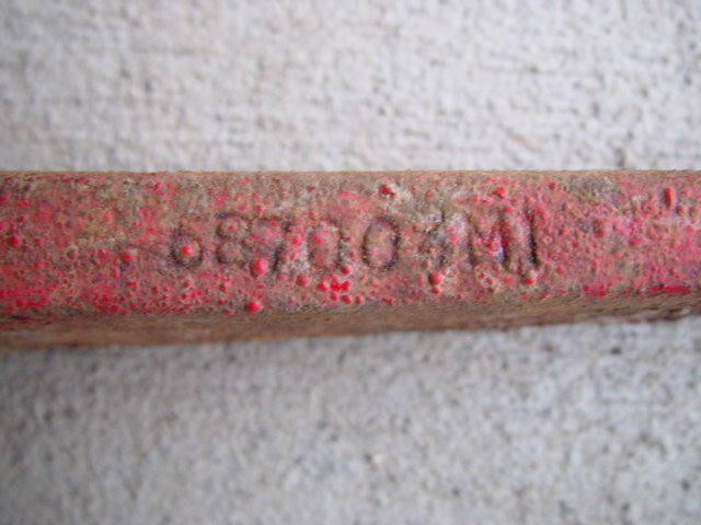

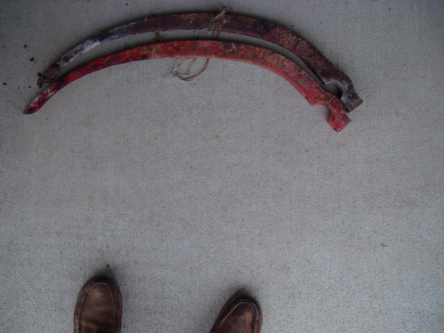

I drug these out of the barn. I am pretty sure they are from our old Massey baler that has since left the farm.. due to jumping time and eating itself.
