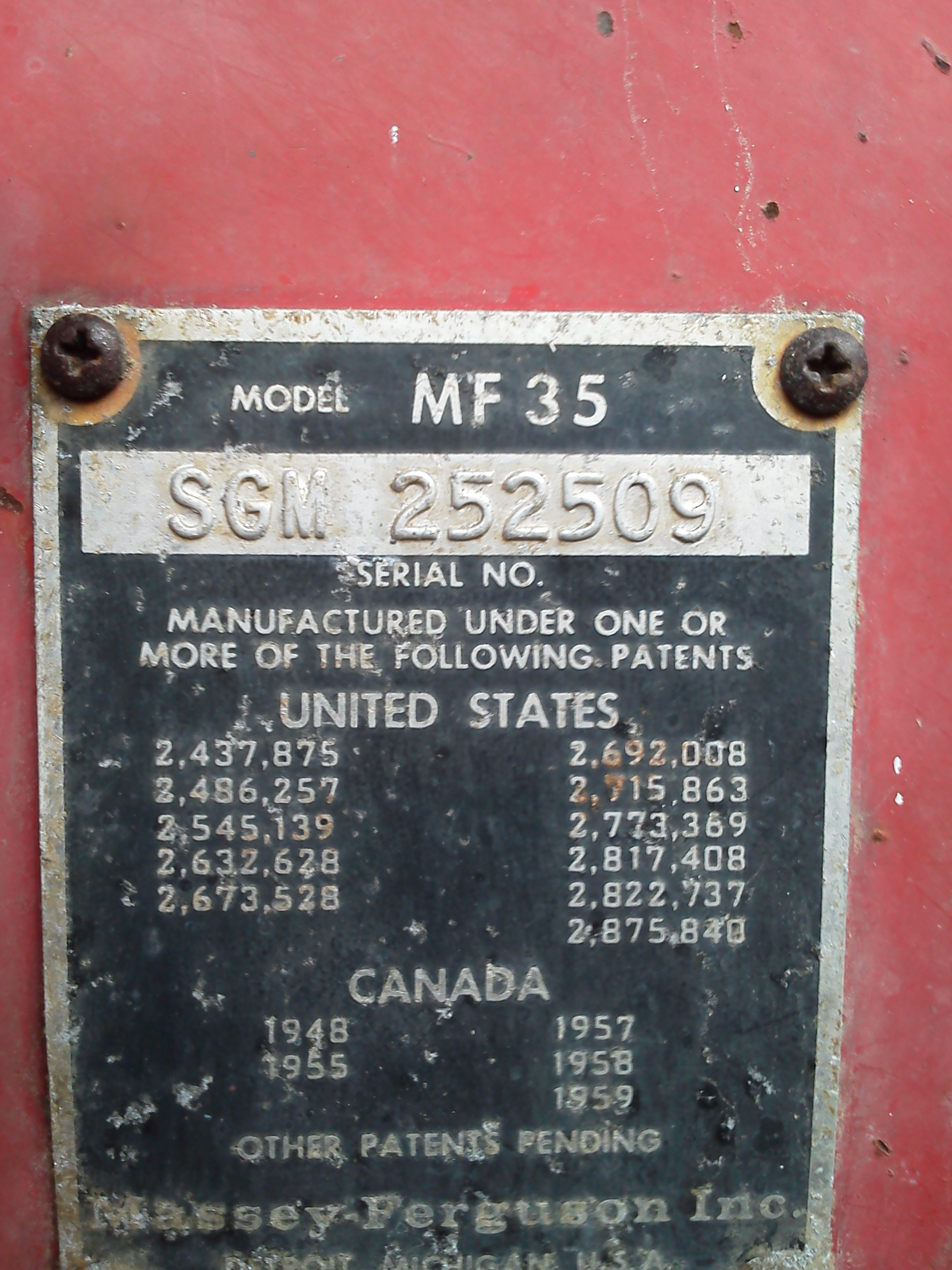

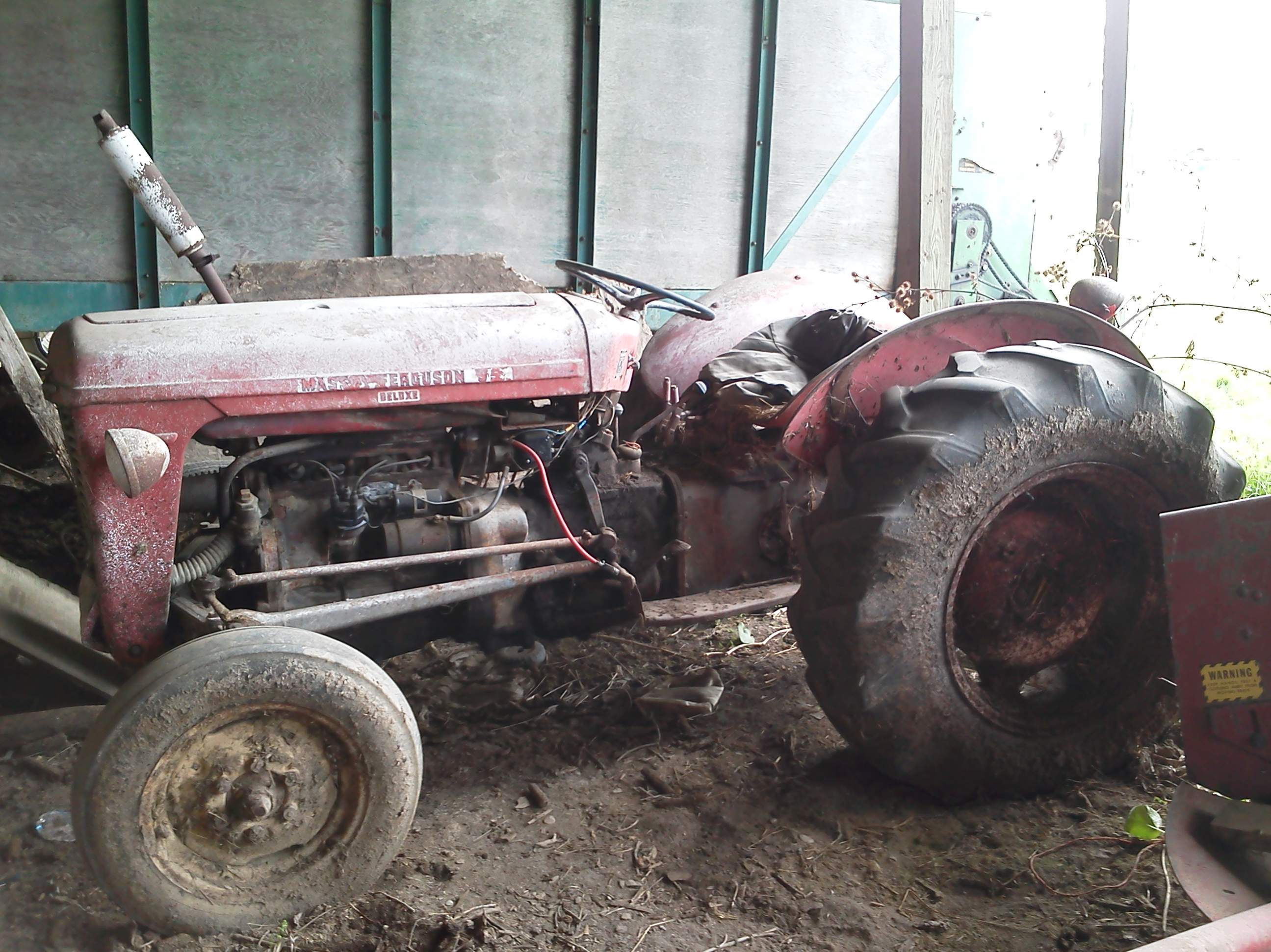

My Brother in Laws offered to give me this MF 35 Deluxe which I am going to take. I belive it is a 1964 based on the serial number data I found The serial number is SGM 252509. It hasnt been run in a few years but was running when the parked it. This tractor does have sentimental value to us since my father in law who passed away 3 years ago used it on the farm my wifes brothers and nephews now run.
I plan on doing (or attempting!) a restoration on this. I have never done a restoraton before but have been wanting to do one for some time.
Im trying to learn as much about these tractors as I can before I do anything to it. I have ordered a shop manual and some books on restoration. I plan on picking it up soon and bringing it home and giving it a good cleaning then attempting to get it running before I start anything.

Your tractor looks like an ideal candidate for a restoration. From the pictures, it appears that the Massey 35 has the Continental Z-134 4 cylinder gasoline engine. Parts are plentiful and reasonably priced, plus the older Massey tractors are easy to work on.

I own a mf 35 deluxe and they are good old tractors. I would worry too much about getting it running. Check your oil, Radiator levels, fresh gas and a full battery. Try to have a spare set of plugs and points on hand.But it might fire off right away.
If you get it running, lube all the zerts, check the trans level then put it through all the gears and run your pto. Use it a little then change all fluids and enjoy.
I am currently rebuilding my Z134 for my mf 35 its in the machine shop. All new Sleeves, pistons, rings bearings, rods reconditioned Crank ground if necessary, valve job. Restorations can be mild or wild if your turns out to be a good runner its very satisfyling work. If you are near Ohio I know a mechanic who specializes in professional tractor restorations. He has a2n Ford in the shop now that looks like a museum tractor.....
