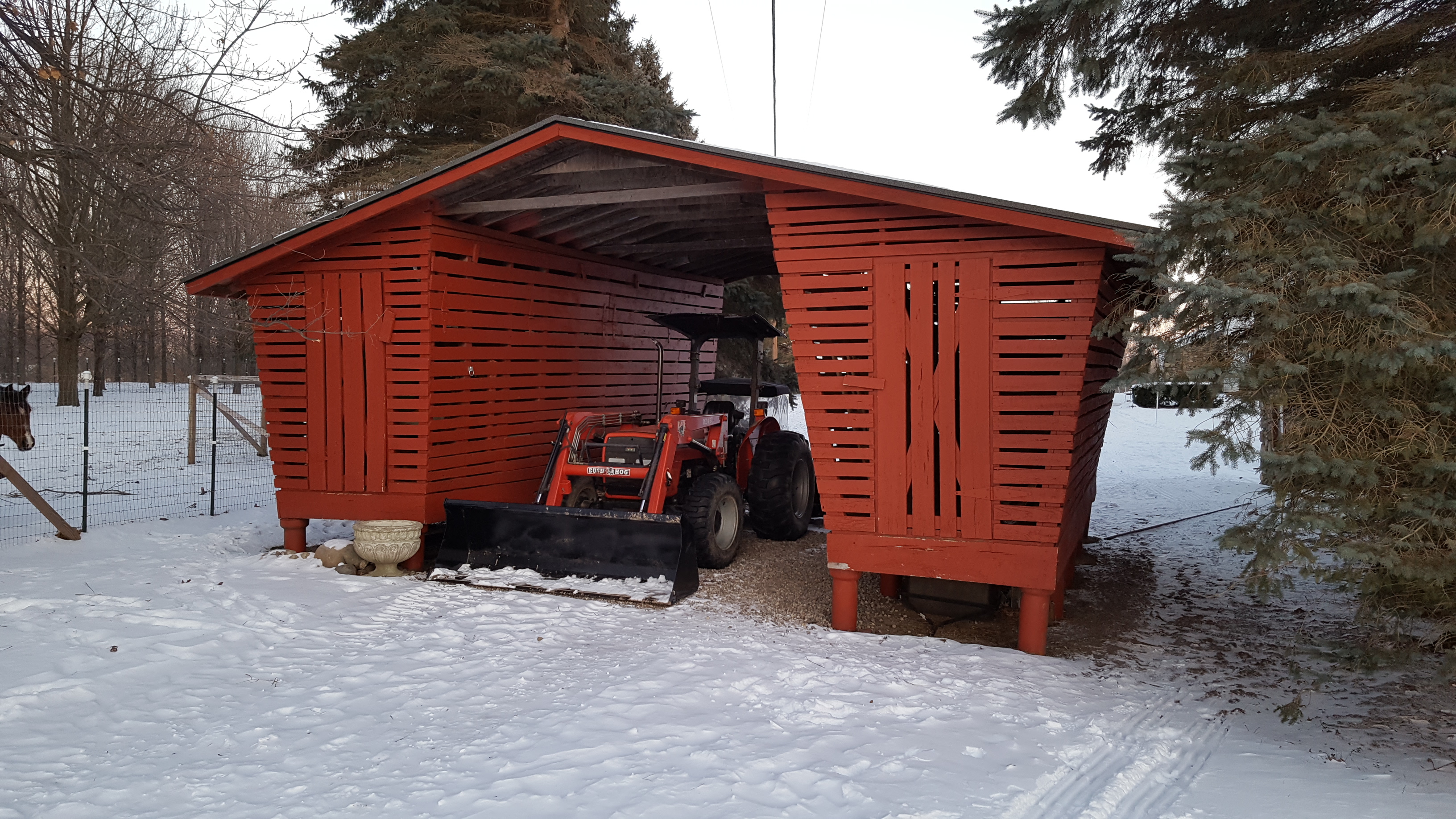

Here she be. Napping in her crib. Hopefully you can see the pictures. I think it spent a lot of time in the sun with the previous owner. A paint job is something I'd like to do in the future. For now it's grease, fluid checks, a small fix here and there, and all other maintenance. Just hope to understand the current issue soon. 1486163613435.jpg1486163625066.jpg
