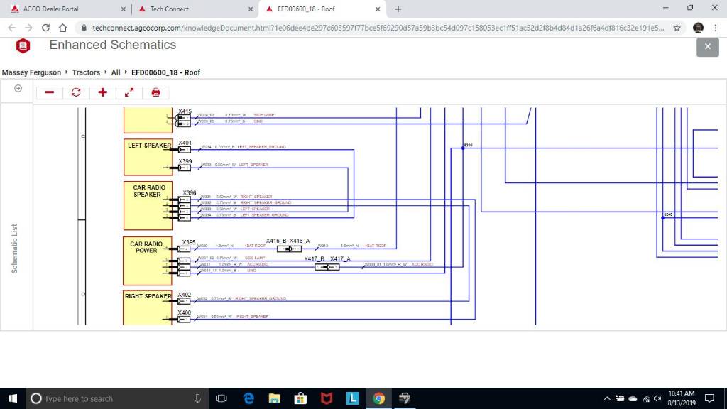

I figured this will help some of you guys out if you want to put a Walmart radio in your tractor. Screenshot-2019.08.13.10.41.51.jpg
