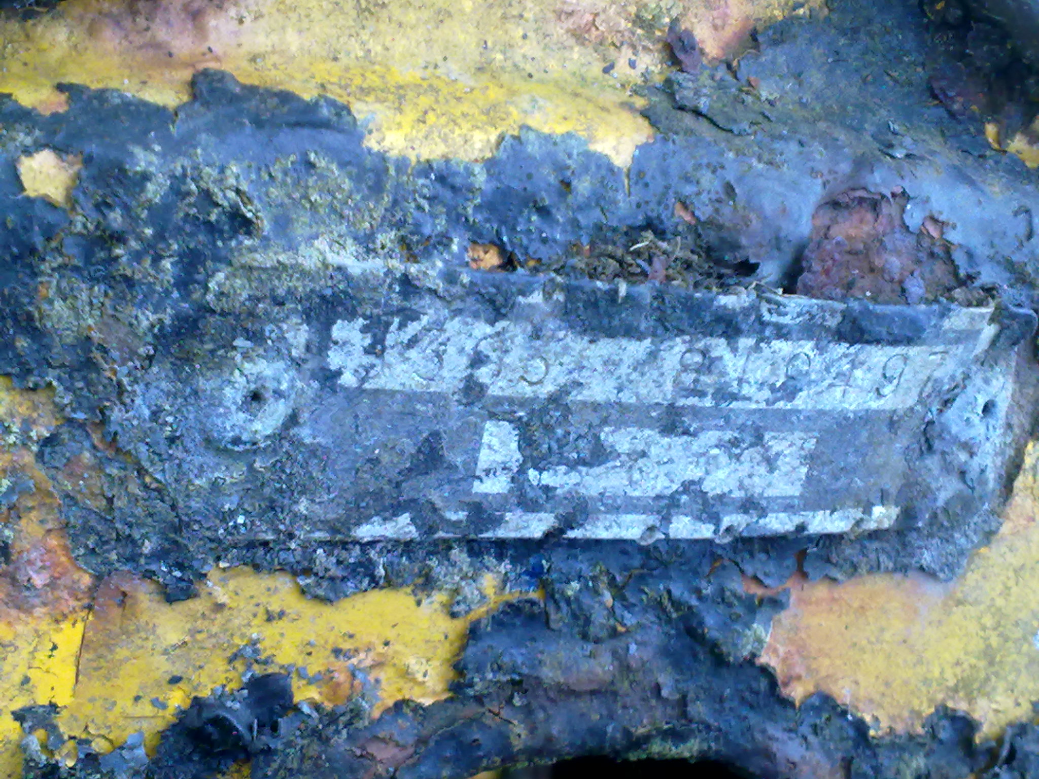

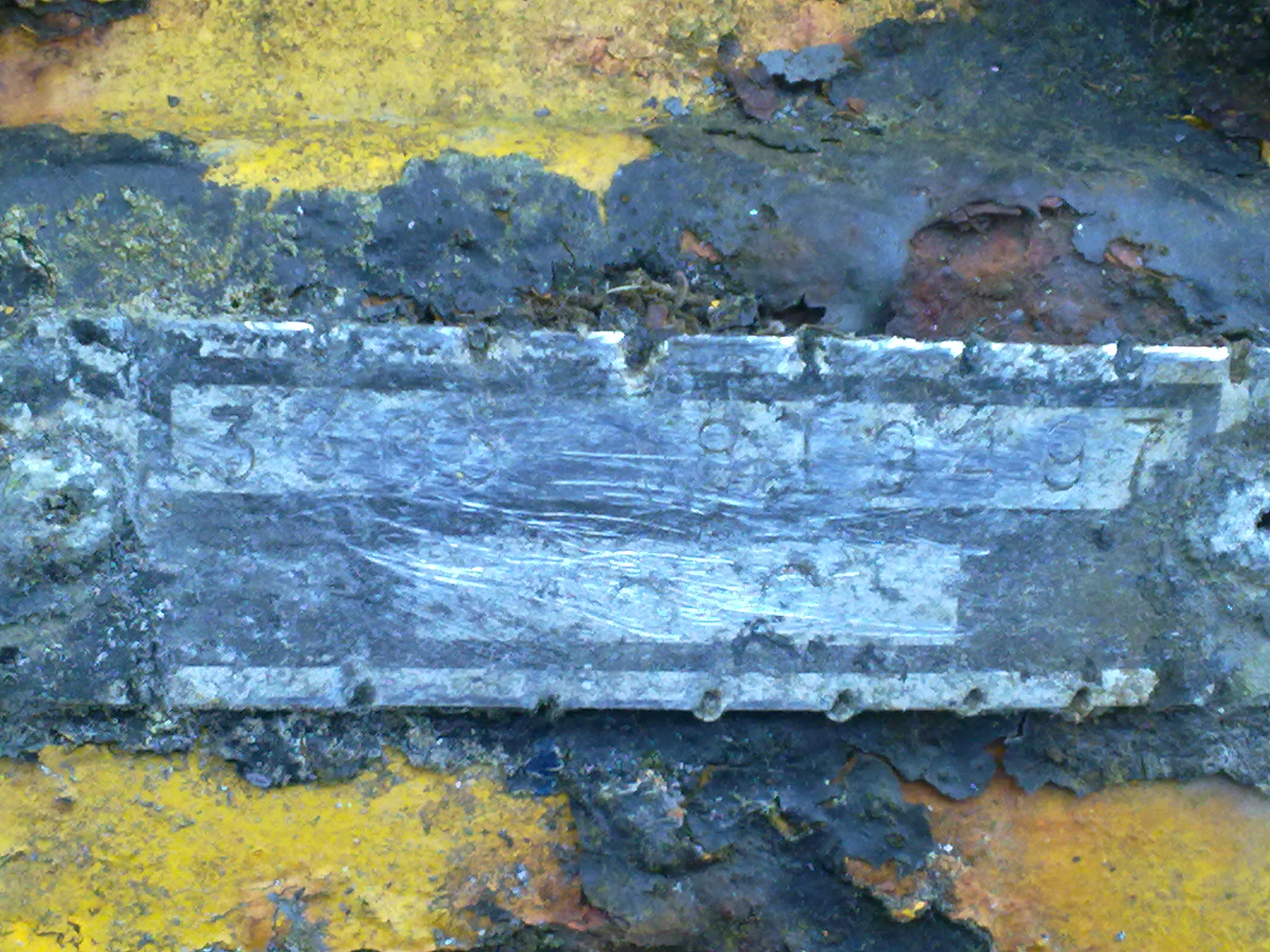

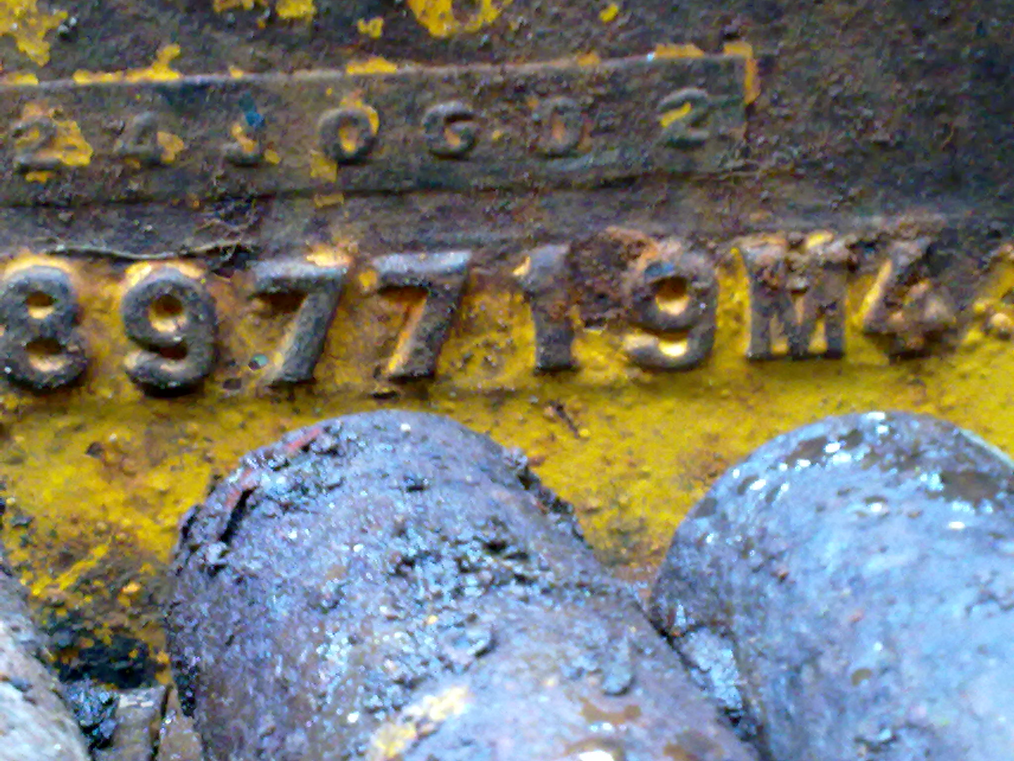

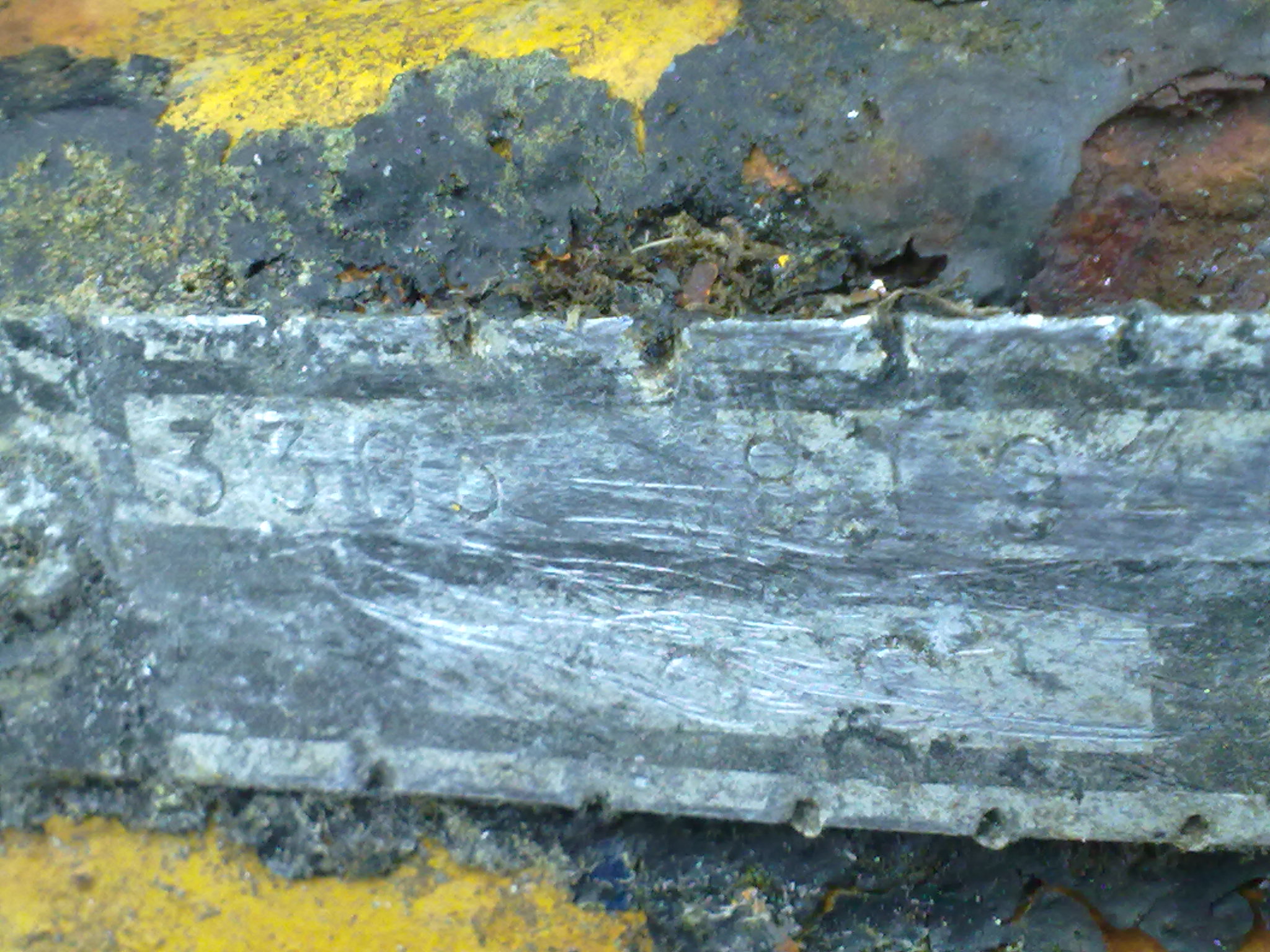

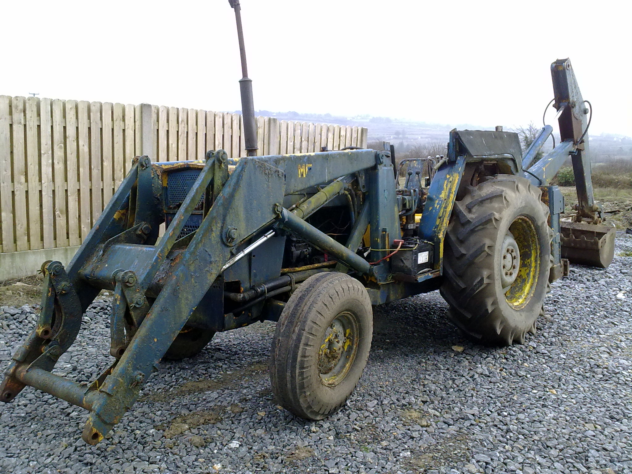

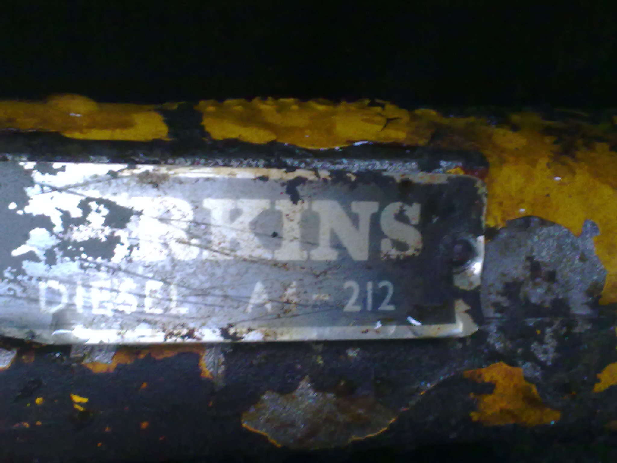

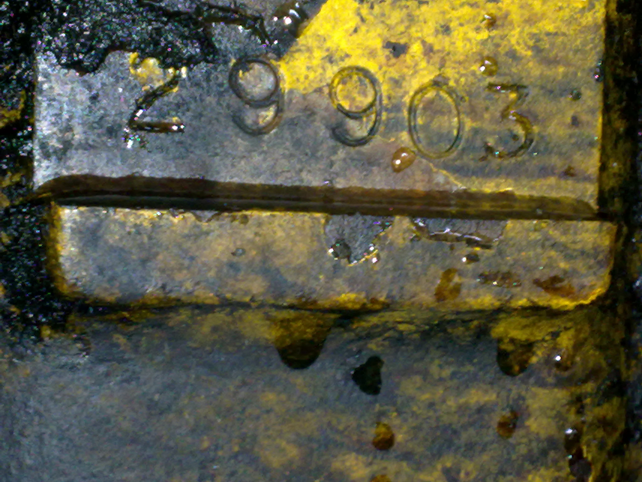

Hi Guys Great site, i just bought a MF tractor to restore and to do all the landscaping we need to do on our new build etc. I HAVE searched for 3 nights trying to find the correct ident for this machine and have found a few conflicting answers so here are the pictures of the numbers i have found on it, AQNY help is much appreciated, sorry if this post (My first) is in the wrong place.
I think its a Massey Fergerson 50B Duluxe Industrial? but i really dont know what year or what to say when i go to get all the new parts and service stuff im gonna need Please Help guys! Urgent!
T.I.A :thumbsup:A
sorry to admin if this is in wrong place?feel free to move to right one? thanks

It appears to be an MF-50 industrial tractor, because it has the Perkins A4.212 diesel engine. The MF-50A had the Perkins A4.203 diesel engine, and the MF-50B had the Perkins A4.236 diesel engine. I'm not certain of the exact year, but it was probably made in the mid to late 1960's.
Also, the 897719M4 number is a part number for either the transmission housing or the axle housing.

Using Photoshop, I managed to tease just enough detail out of the picture you posted of the engine serial number to identify it. I'm still trying to pin down a date, but here is what I came up with just in case anyone else may be able to help.
A4.212 Perkins Engine, LA (Family type)

You're welcome.
Engine Serial Number:
Wow Thanks massyWV your a genius! thats really helpful Thankyou

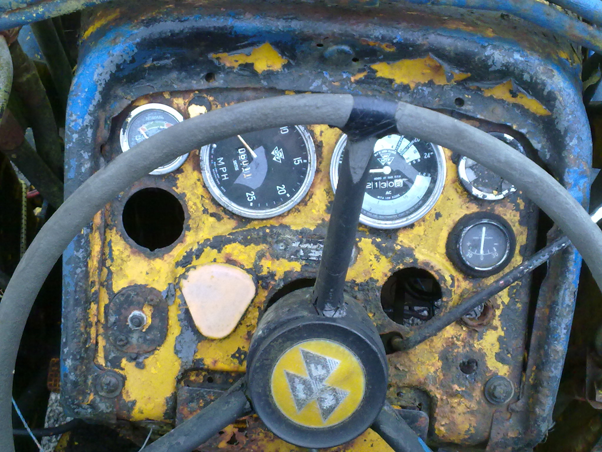

Bet you cant do the same with the one on the dash?
I read loads of other posts and |I apper to have the "Deluxe" vesion if the guy with the same dash panel (instrument panel) is correct, what ever "Deluxe" meant/included from new?:cool2::thumbsup:
I noticed the serial number plate on the dash, but it's partially hidden by the steering wheel and I would need a good clear picture zoomed in on the serial number plate to make an attempt. The tractor serial number on the dash could potentially reveal the year, and possibly more.
Judging by the number of gauges, I also tend to think it's a "Deluxe" model.
heres the best i can get:
