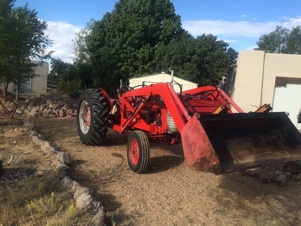

I currently own a MF 65 late model diesel.
I want to purchase a loader for this tractor but need to know what loader fits the MF 65.
I've heard Freeman 200, MF 99.
Can anyone please help me out with this.

Before getting too carried away searching out a loader, have you given much thought to how/if your hydraulics will operate it? Typically the older Massey's were less than ideal for external hydraulics.

I had a 59 MF65 gas tractor and it had a loader on it. The hydraulics was run from a hydraulic pump at the front of the tractor. A drive shaft was fitted to the front of the crankshaft drive pulley - simple and it worked. The hydraulic oil was completely separate from the tractor hydraulics.

I have a 59 diesel with a FEL. There is a diverter valve under the seat to switch from 3 pt to the FEL. Not the fastest, but it does work. Looked at getting a front pump but the steering would interfere turning left.

I personally would not put a loader on a 2WD, gear transmission tractor, especially if it doesn't have the optional power steering.

I have a mf135 without power steering, with an old tubular massey loader that was originally a trip bucket. It ran off the 4.5 gpm tractor hydraulics. I added a front pump that puts out about the same flow to free up the remotes. Added a brand joystick and hydraulic bucket. Not enough flow to operate both the lift and bucket at the same time, but I'm not trying to set any speed records either. Plan my turns with the tractor moving and its not too bad. Some of us are on a tight budget and can't afford the best equipment. It's still better than a shovel.
