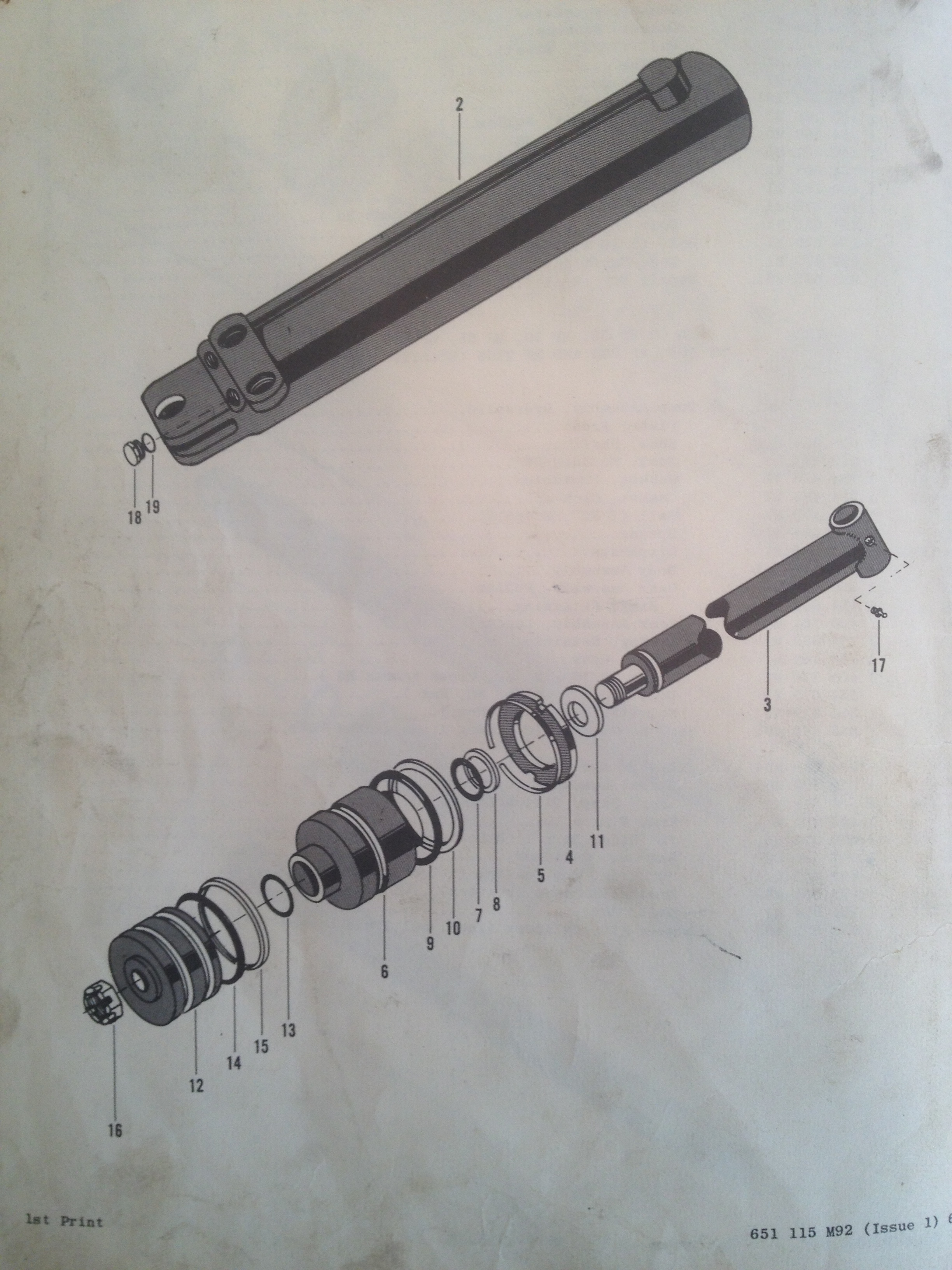

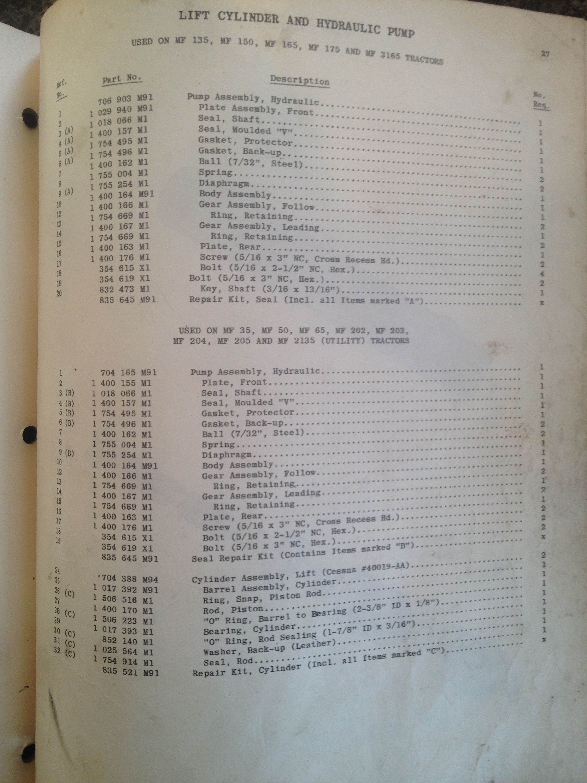

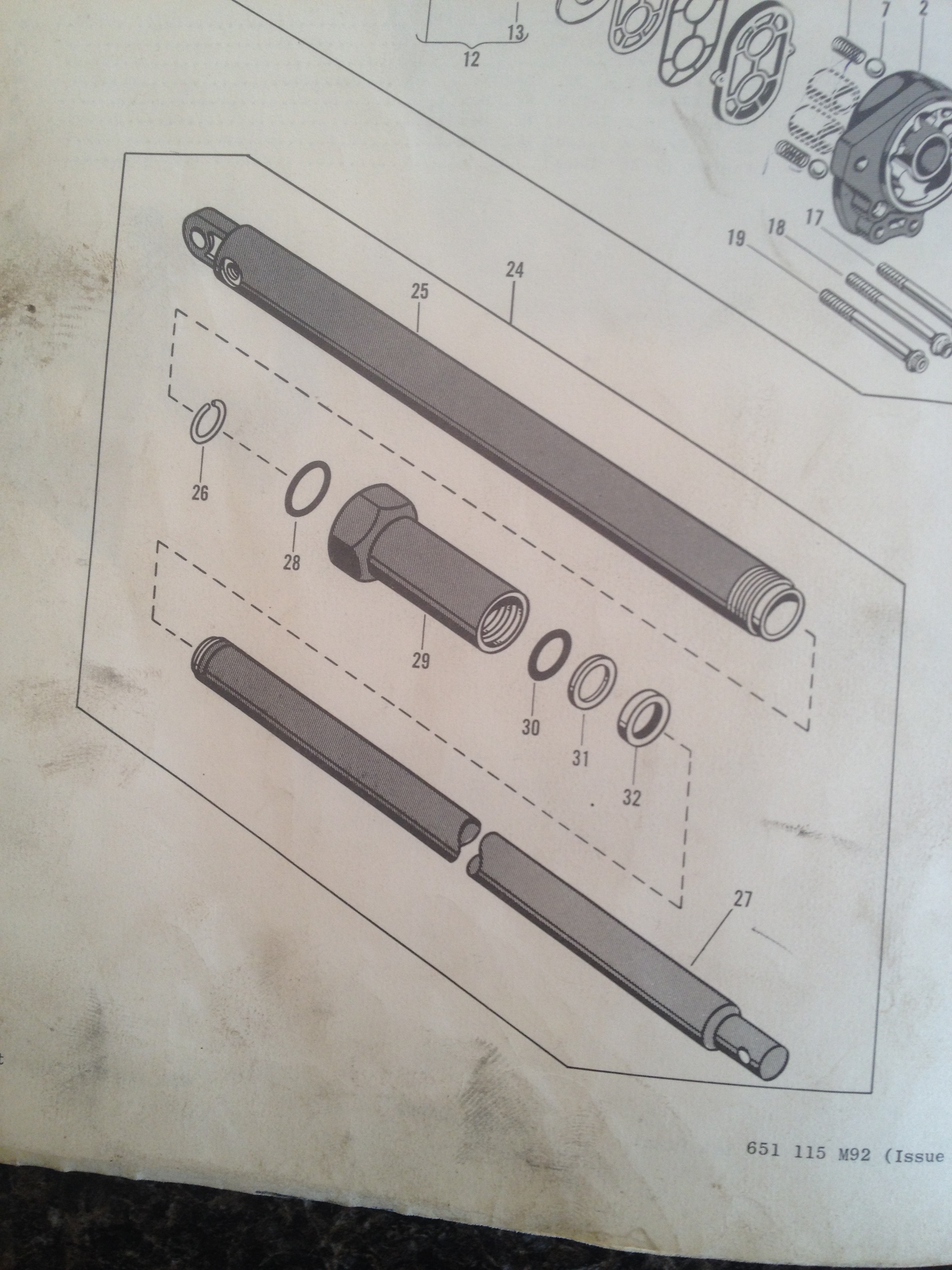

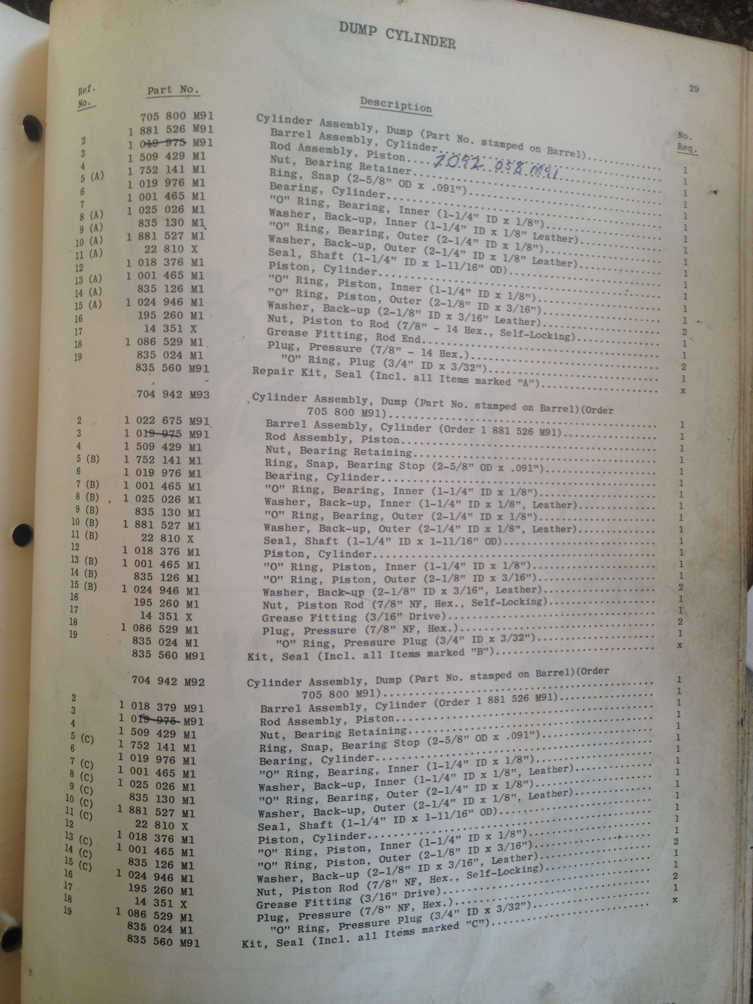

I have a Massey Ferguson 65 with what I believe is a Davis or Massey 99 loader.
Both the lift arms and bucket cylinder drop at a fairly fast pace.
I believe that both the cylinders and the control valve are leaking past the seals.
Are either or both of these rebuildable? If so, where would ba a good place to start looking for replacement seals?
Thanks!
