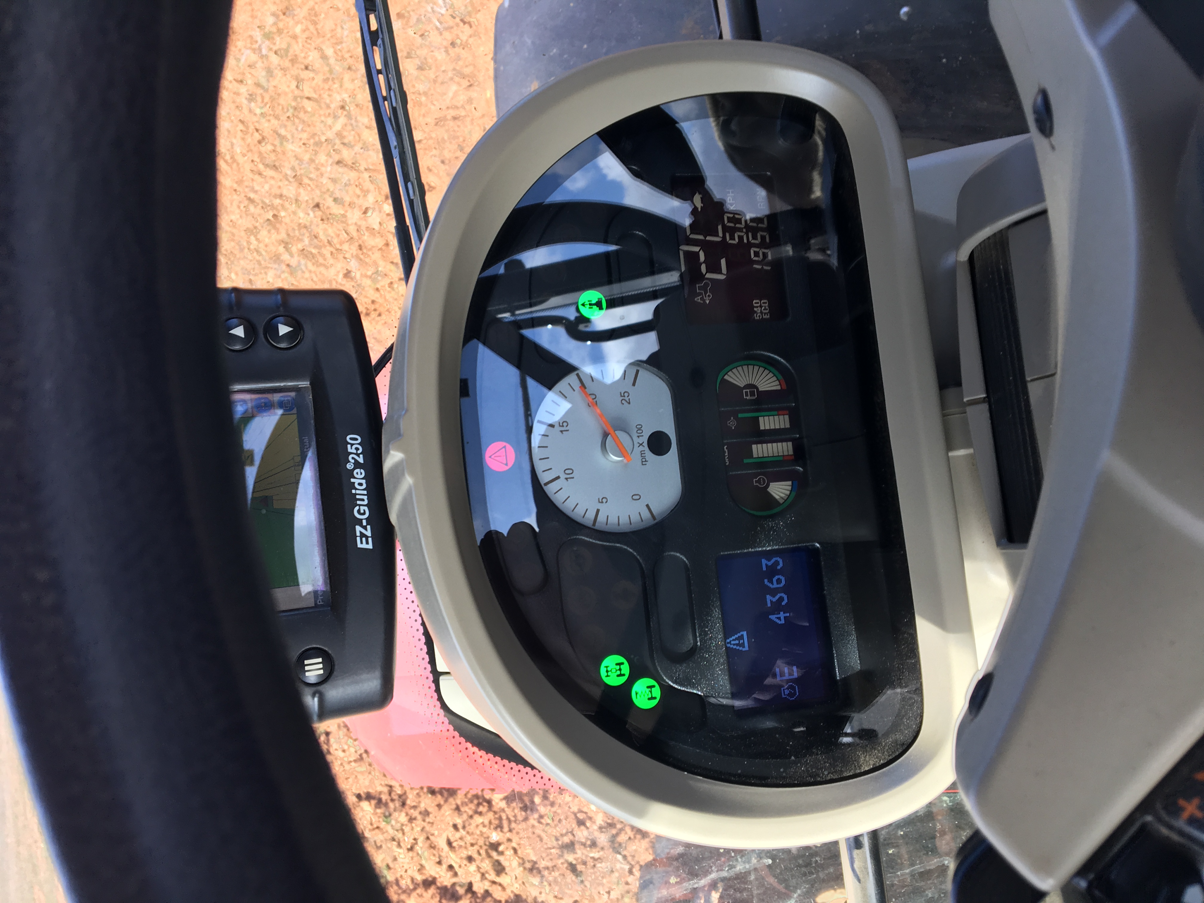

Hello everybody, my name is Luis , I am from Portugal and I have a Massey Ferguson 6613 Dyna-6 that keeps giving me the error code E 4363, with loss of power in addiction, the dealer cant seem to solve it, I know its related to DEF, anyone can help? Thanks

How are your engine temps? Dose your tractor run cool all the time?
The temp is normal, like in the picture, thats how it usually runs
   / MF 6613 DEF problem #6
You'll find regen and DPF issues are prevalent and unfortunately difficult to fix. Your dealer isn't the only one having a hard time trying to diagnose and fix these systems. My dealer has been trying to figure out what is going on with mine for nearly the last 200 hrs. The current thought is a stuck thermostat keeping the engine from reaching full operating temp thus not allowing regens to take place. That is of course why I asked about your tractors engine temps.
I see, its a pain in the a... been like this for 200h as well, but just got worse. The error code it displays is for high exhaust temp, they just figured that out. Whats your machine?
