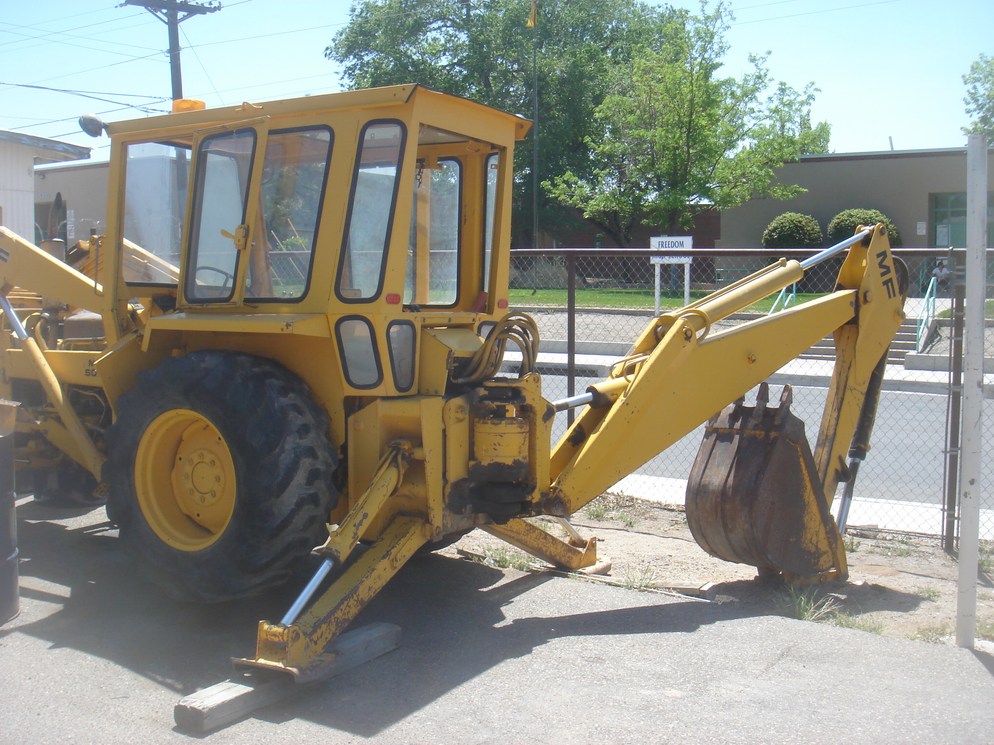

So, I've listened to your advice on buying an American made backhoe in the 5K range. that I shouldnt have to travel hundreds of miles. I found a 1975 Massey Ferg M50A with instant reverse for 5K! It does need a front pump or clutch, as it runs in reverse, but he uses the backhoe to push it into the pile to load the bucket. I'm trying to get him to pay for the repair.
It has an odd looking hydraulic unit that operates the hoe swing operation. It kind of looks like a small keg. It's round and has the hydraulic hoses coming off of it. Is this something anyone's familiar with? Any idea if parts are available if it need service? It seems to work fine now, but it does show leakage.

I'm guessing without firsthand knowledge of the unit, but it appears to be a hydraulic motor-brake-planetary drive unit. These units are used to rotate the turntables or turrets of cranes, and other boom type equipment.

Does it look like something parts may still be available for? I'm more used to straight hydraulic cylinders. Kinda makes me want to shy away from this machine.

Those machines were verry good and yes parts r still available. I have a customer that has 3 of them and he works them everday. I would however try to get him to come off the price some with the problems u stated
