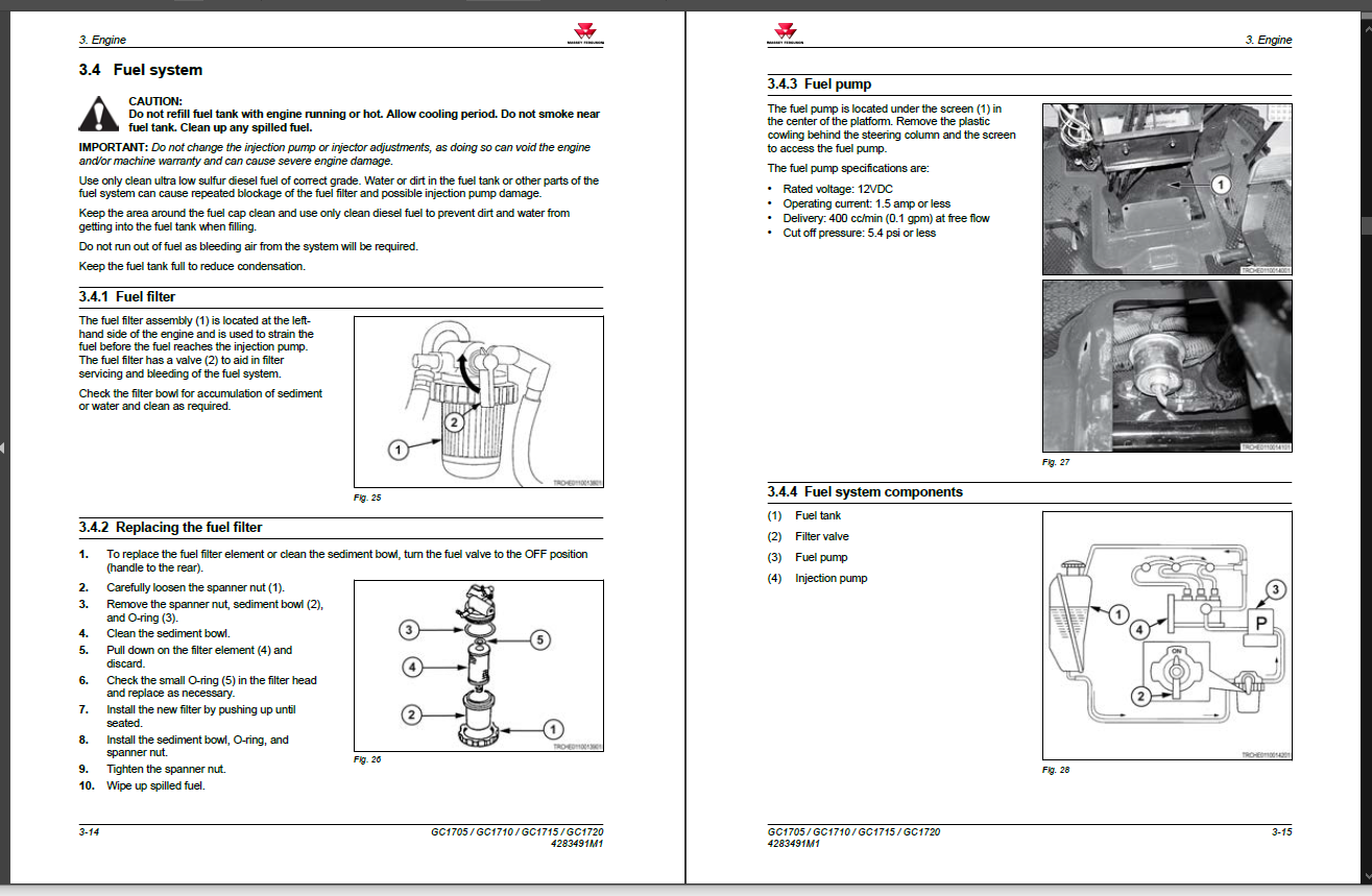

Further checking today, fuel flows great from tank to filter, especially w/ the new filter. Haven't found fuel pump location but it isn't "ticking" like it use to. Removed fuel line before injector pump and there is fuel there but it really isn't flowing, just vibrating or slightly moving w/ the "ticking" which isn't consistent now. Previously when I turned the key, the ticking immediately started steady and fast. Today, 1 key turn was getting a few "ticks" but wasn't steady and sometimes absent. The next key turn sometimes changed it but it never flowed fuel before the injector pump.. I need to verify I somehow haven't pinched something near the "lift" pump but it appears it might be the culprit.
Will keep ya informed as I know there is lotsa these GC series machines out there. Thanks for the simple, quick, route to figuring this out! Not as difficult as I woulda thought.

Here are the pages out of the service manual for the fuel system.
