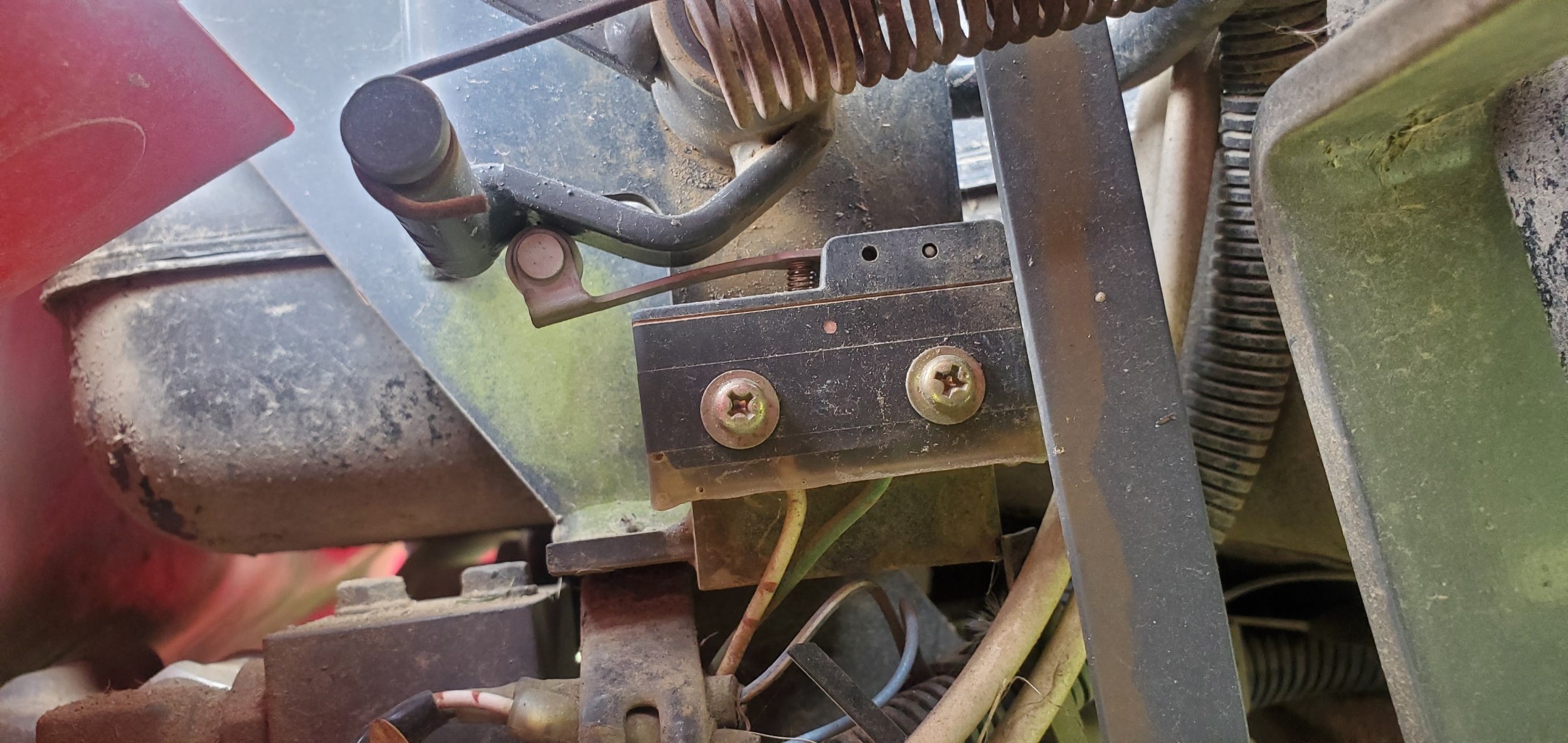

this is pic from 15 minutes ago on a 2010 GC2400 of the PTO safety switch with lever engaged, thats only time lever touches switch.
I would unscrew it, cable tie it up safely, see if issue goes away. would be good start point.
I’ll check this before my next round of cutting. Thanks for the suggestion and picture.
