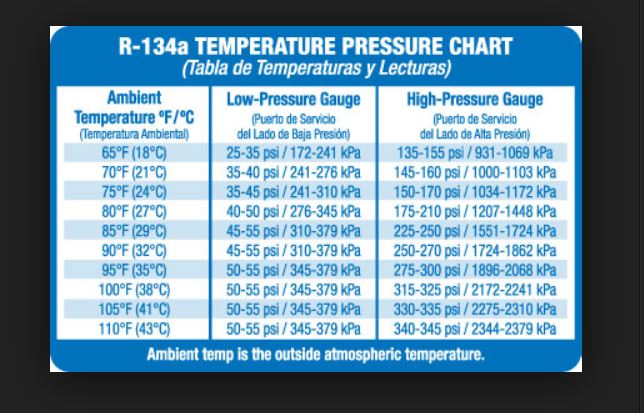

I have everything needed to put Freon in my MF tractor ac, but I need more know-how on what to do....steps, pressure etc.. Does anyone know of a place on the internet or on this forum that gives this info. I'm new to this site and I'm trying to get my hay baled in this Tx heat without an ac (I'm actually asking this for my husband at his request who is in the hay field as I type) I know the tractor is a Massey Furgeson, I think he said it is a 399. Any suggestions and or info is appreciated. I tried youtube, but couldn't find what I needed.

Yes it was hot in Tx yesterday & going to be the same today. Are you sure that evaparater,condenser & cab filters are spiffy clean???????????? Farm machinery AC systems operate under adverse conditions so AC components need to be cleaned regularly. Coolant has been known to be added to AC systems when indeed NONE WAS NEEDED. I'm assuming your MF 399 has R134A for AC coolant. Here's the pressure chart. Hose quick couplers are 2 different sizes for high & low so will only attach the correct way. When adding coolant only open low side gate valve on gauge cluster.

Thank you Jim and Sportsman. Good info. This is a great site. So glad I found this site with guys like you ready to share info. I've seen Freon added to my tractor a few years ago, but I didn't know the specifics to be able to do it myself. Jim, thanks for the chart and I will check the components you suggested.
