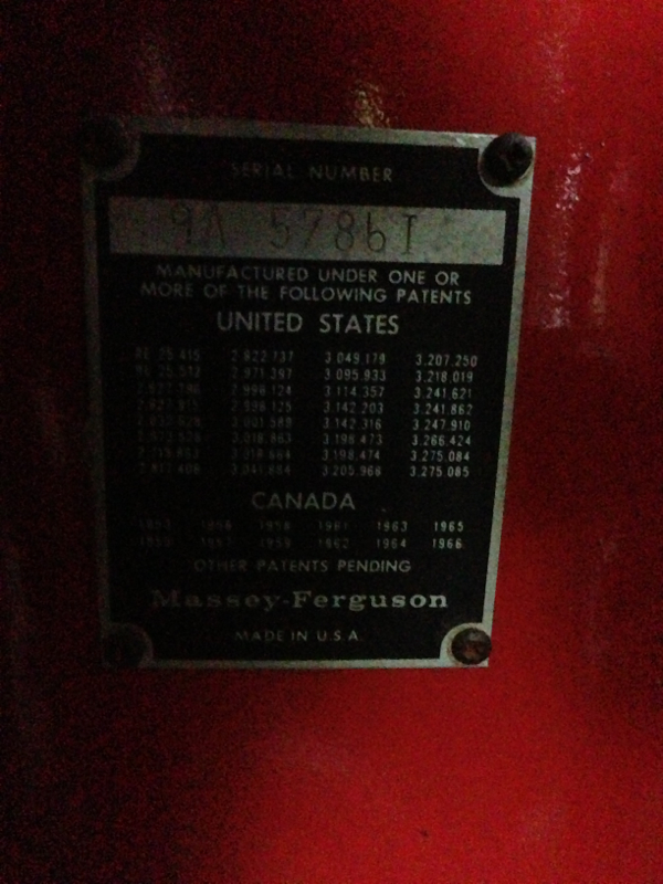

Thank you!! It is a 67 with a continental motor and a marvel carb. The tag was rotten on the motor. So not sure which one it is. There were only 2 right? I will do some calling this afternoon. Thanks again!! Btw. I'm in Maryland.

There ya go. You got all the info you need to buy/order a kit. You want to make sure your float is not damaged as in pivits or ruptured. I have in the past soldered a seam in a float and repaired it. Just make sure it floats evenly. or fix or replace. I'll make some copies of the OP manual you can use to adjust the air mixture and idle. Lay everything out and take pictures before and during disassembly. You can clean the outside with Kerosene and a paint brush and finish off with a can of spray carb cleaner. Send me your email in a PM and I'll copy those pages for you. My OP manual (original) is actually a 3/1967 I bought off ebay.
   / MF135 parts #6
If you have a tach, and a 2 stage clutch you have a Z145 engine...my '67 Z145 has a Marvel #882 carb..(there should be an aluminum tag with the # on it). BobG in VA

Yup. 2 stage and a tach. No tag on the carb though. Thank you guys for the help! Much appreciated.

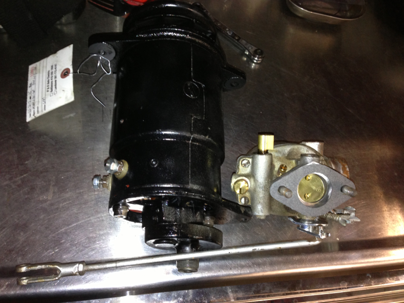

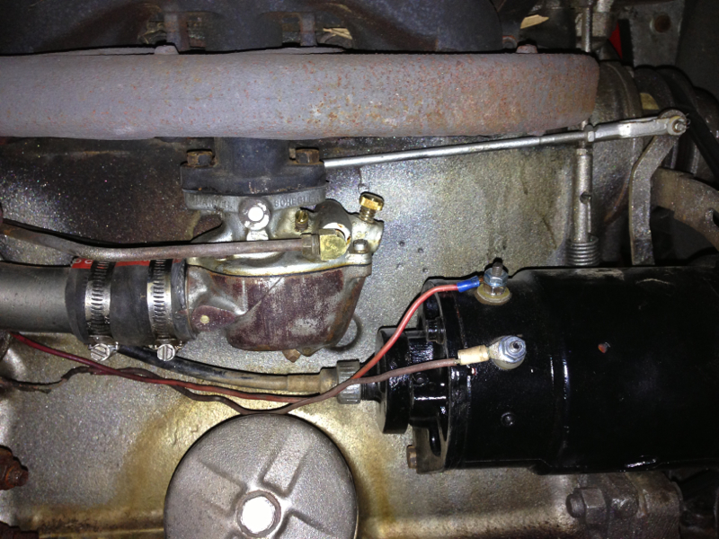

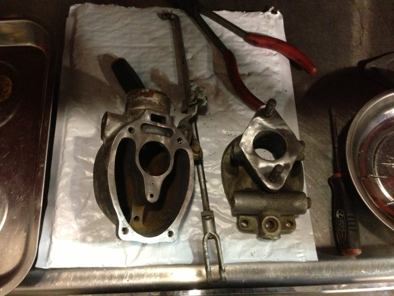

Thanks for all your help! I got the gen rebuilt and I just finished the carb. Will let you know how the tuning gos.

Got the carb back on and adjusted it to specs per the manual that the Kid sent me. Turned the fuel on and gave it 2 revolutions and she was purring like a cat. Now on to the temp sender/gauge,wiring and a seal. Dad ordered a new seat as well. This is a nice old tractor!
