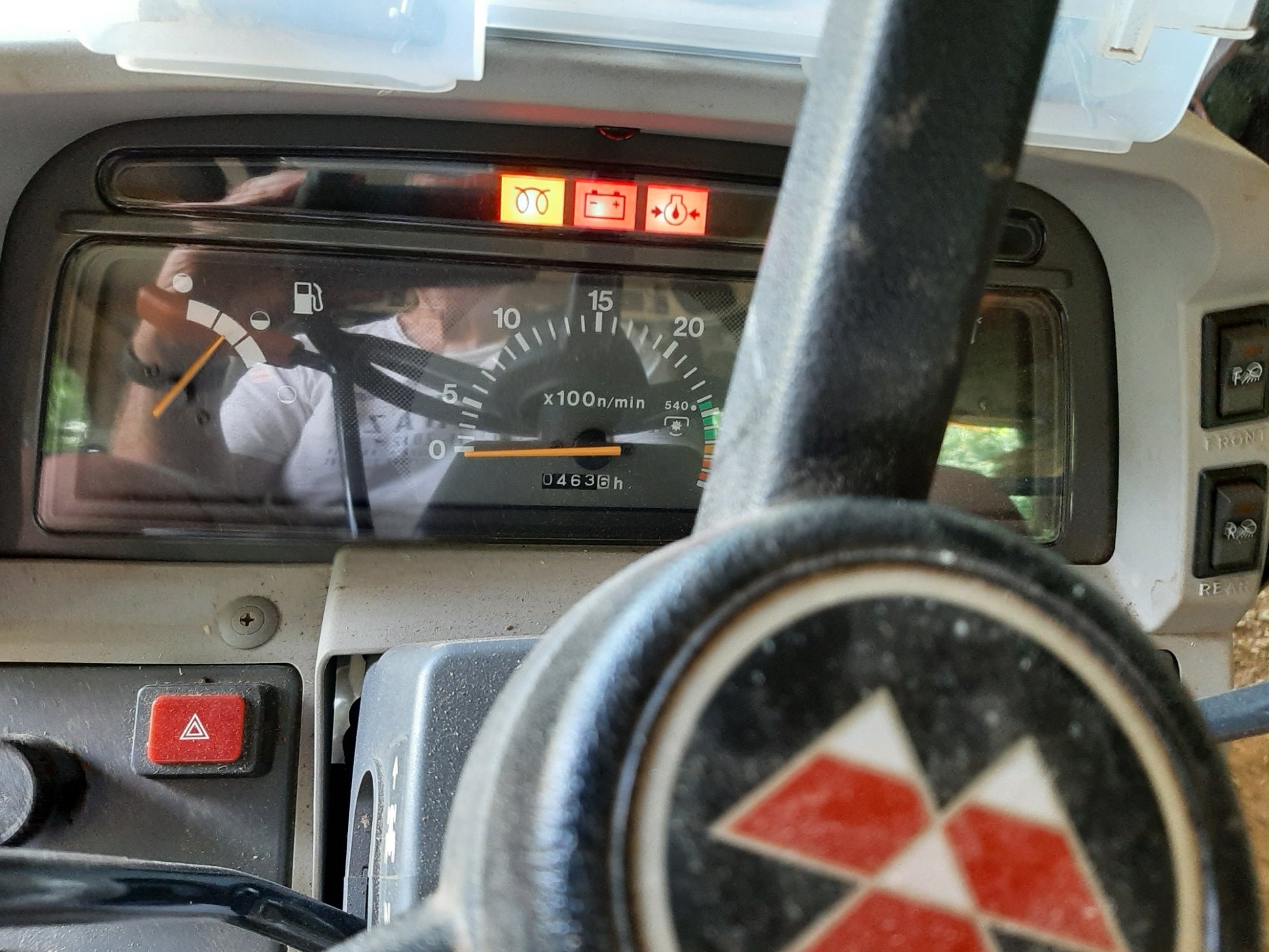

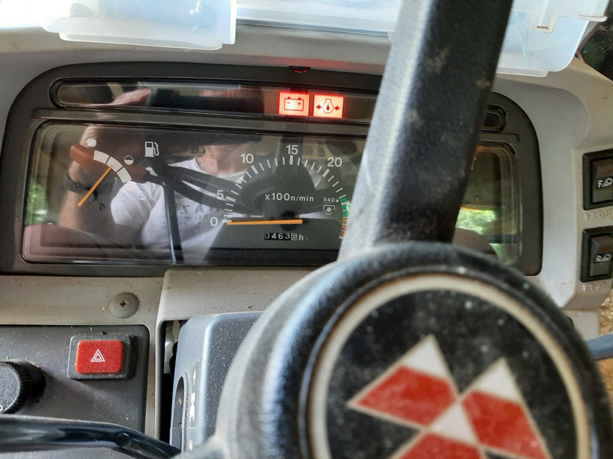

Hello all,
Have a new to me 2005 1528. When I go to start, it takes a few minutes to crank and then start. I had a JD4300 in which the glow plug light would come on when the key was turned to the start position. Reading the manual, it states the glow plugs are activated at the start position. However, is there a light, as mine does not come on? Just wondering how I can tell if my plugs are operating properly?
   / MF1528 Glow plugs #2
On my 1533, you turn the ignition key enough to light the dash lights but not enough to start, and then just a little more, but not enough to start, and that sends current to the glow plugs and a yellow light comes on in the dash cluster.
After the first turn of the key:
After turning just a tad more:

I have yet to see mine do that!
   / MF1528 Glow plugs #5
I don’t believe the 1528 has a glow plug light as my 1531 uses the same dash as the1528 and it doesn’t have a glow plug light.
   / MF1528 Glow plugs
I tried the key thing over the weekend and no light. But it did start rather quickly compared to before. But no light.
   / MF1528 Glow plugs #7
I have a brand new 1526 (15 hrs) and I've never seen a glow plug light. Surprisingly, it is also not equipped with "PTO on" or "parking brake on" indicator lights.
