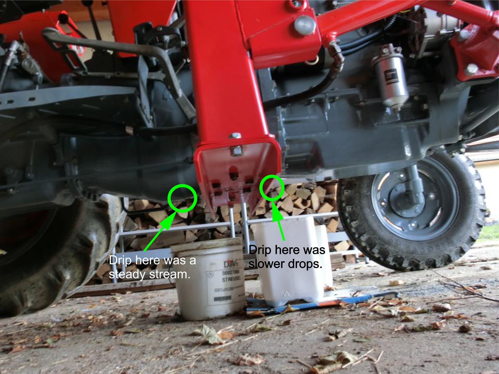

   / MF165 massive hydraulic fluid "weep hole" leak
Hi All,
Thanks for all the great feedback. I feel a little more comfortable about the issue now.
I've attached an image of the location of the "weep hole" leaks. I've also got a parts breakdown pic of the transmission. And based on the comments at this point is that when I was using the multi-power in "HI", there was plenty of hydraulic pressure that seeped out around the input shaft and seals due to those sealing rings possibly grinding into the shafts and of course the oil seals being as old as they are. I will hopefully have some time today to refill the transmission with oil and try running the tractor multi-power in "LOW" and see if I get a leak again. If not, I can switch to "HI" and monitor it closely and see if the leaking starts. I suppose if it does, then I know where the leak is.
Does this seem like a reasonable guess/test without harming anything as long as I don't go too long before I see a leak again? Is it possible if the leak is high enough around the input shaft that it could actually spray onto the clutch and cause damage?
Thanks guys! :)
#9
Thanks guys for all the comments!
SIMassey, when I was using the multipower in HI the other day before seeing the leaking, it was shifting smoothly and locking in just fine.
I ran the tractor today for about an hour. I rigged up a bucket underneath the "weep hole" to catch the drippings as I drove around and tested it. And while running it in low, the leak is definitely diminished, but not stopped. Now, once warmed up, I ended up with a drop per second or so.
As well, I've also noticed that there is a sputtering of oil coming out of a window in the bell housing where you can see the flywheel. So, that pretty much pinpoints the leak to the input drive shaft as it must be seeping through even without the high pressure applied in HI mode on the multipower pushing the oil.
So, it's pretty clear I'll need to split the tractor to get at those seals. But, also, what about the drive shaft that the seal rings go around, could the shaft be worn down now in the position where the rings are? And, if so... is it possible to weld and fill material back in the grooves and machine it back true or would I need to just get all new shafts?
And finally, I have a little bit of plowing yet to do this week before putting the tractor to bed for the winter. If I continue to run it, will I do any damage to the clutch/flywheel area in the bell housing if I watch and maintain my oil levels and just catch these drippings? SIMassey, as you said with your 135 oil leaking onto the clutch discs, were you talking about the clutch discs for the multipower or the main clutch? And is it possible in my condition now as I've described it for oil to get onto the main clutch and cause damage to it?
Thanks all! :)
Dan

Sounds like most of your problem is the main seals of the input shsfts and not the seal rings if it shifts solidly. Increased leakage may be due to increased temperature. Been six years since I had it tore down and dont have access to a parts breakdown but I do remember there is at least 1 rubber lipped seal in there. It seems the shafts the seal rings are on wear less than the bore they seal in.
Oil leaking on mine soaked the main clutch and replaced it with a complete rebuilt unit cheaper than the parts to rebuild it myself. The clutch discs on yours are likely oil soaked already and worn to a point that you should replace them while you have it split.
I believe on the 135 the original shafts and bores where the seal rings are located are no longer availble but a new design is at a high cost.
