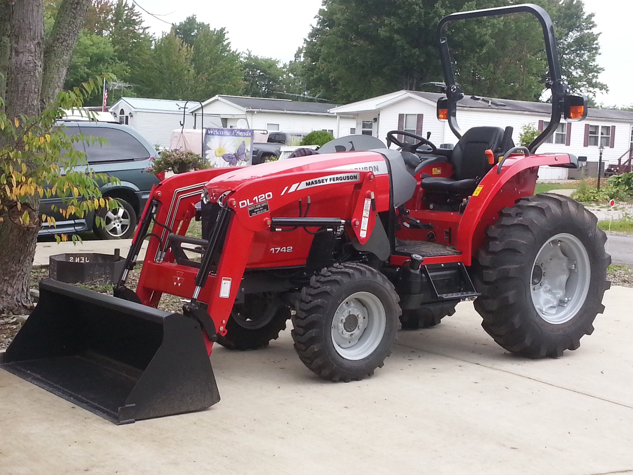

I've had my 1736 for a couple of months and have tried everything to change the speedometer digital display from km/hr to mph. I've read the manual and messed around with every possible combination of buttons. I've even stood on my head and tried it and still no luck. I know that mph exists on the digital display since it shows up when you turn the key on.
I am nearing the 50 hour maintenance period and need to get an oil and hydraulic filters. Can those filters be purchased from someone other than Massey Ferguson? I had lots of sources for parts when I owned my 4010 subcompact John Deere so was hoping Massey would be the same.

See or call your dealer, he has the procedure for making this change from KPH to MPH, it's done through the instrument panel. The speed display is only available for HST equipped tractors so if a tractor is a power shuttle it will not show speed.

I'm working on the same mph issue. Have you figured it out?

Yep, the dealer finally called me back and said that the guy that was supposed to call me back had been fired for not doing his job. The guy who called me said that I would have to bring the tractor in to the dealer so they could hook it up to their computer to switch it over. He said that tire size factors into their settings so that's why the dealer had to do it. He chuckled when I asked if Massey was going to pay for it since I bought a tractor in the US not Canada. Is yours a hydrostatic transmission too? Just ordered filters for mine for it's 50 hour oil and hydraulic fluid change. $175 for the hydraulic fluid and $90 for the two filters. BTW, how long have you had yours? When I bought mine there was only one 1742 in North America for sale. They must have produced a few more since May.

Contact the dealer and have them email you the KMP/MPH procedure from the service manual. It's called "Unit Set" in the service manual and is done through the dash, no reason to take it to the dealer. Takes about 1 minute and the dealer that said they have to hook it up to the computer due to tire size, etc. is wrong.
