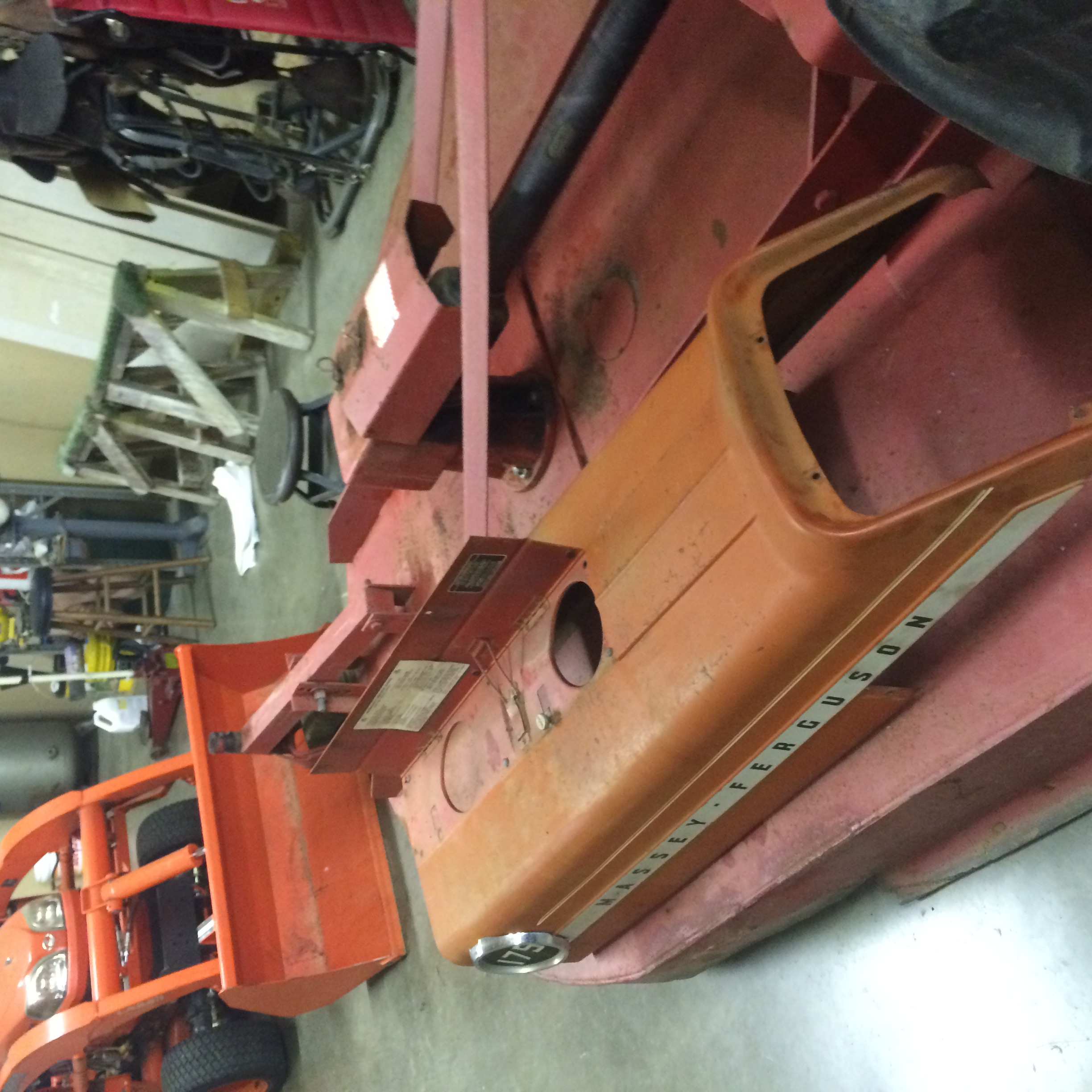

Thanks for having me, had been searching posts for answers and have come up with a few. Still looking for a shop/service manual for a 175. here is a few pics of the new project. IMG_0916[1].JPGIMG_0915[1].JPGIMG_0914[1].JPGIMG_0908[1].JPG

Thanks, my intentions are to restore it, since the evaluation on it seems good.
The Good
Brakes work good (a must have in the mountains I live in)
Starts right up and does not smoke (unless it is wide open cutting going up a steep incline then a little)
There are no oil / hydraulic leaks after changing all the fluids and filters everything was relatively clean after cutting for 4 hours.
The hydraulics are strong and responsive picks that 8ft bush hog up with no problem.
Multi-power works (never seen that function work on any of them i looked at)
Operates and runs smooth even under a load,
Temperature stayed consistent during the whole 4 hours cutting on steep inclines at 90 degrees F outside temperature.
The Bad
Needs paint
Some Dents in the sheet metal, I think I can get them out

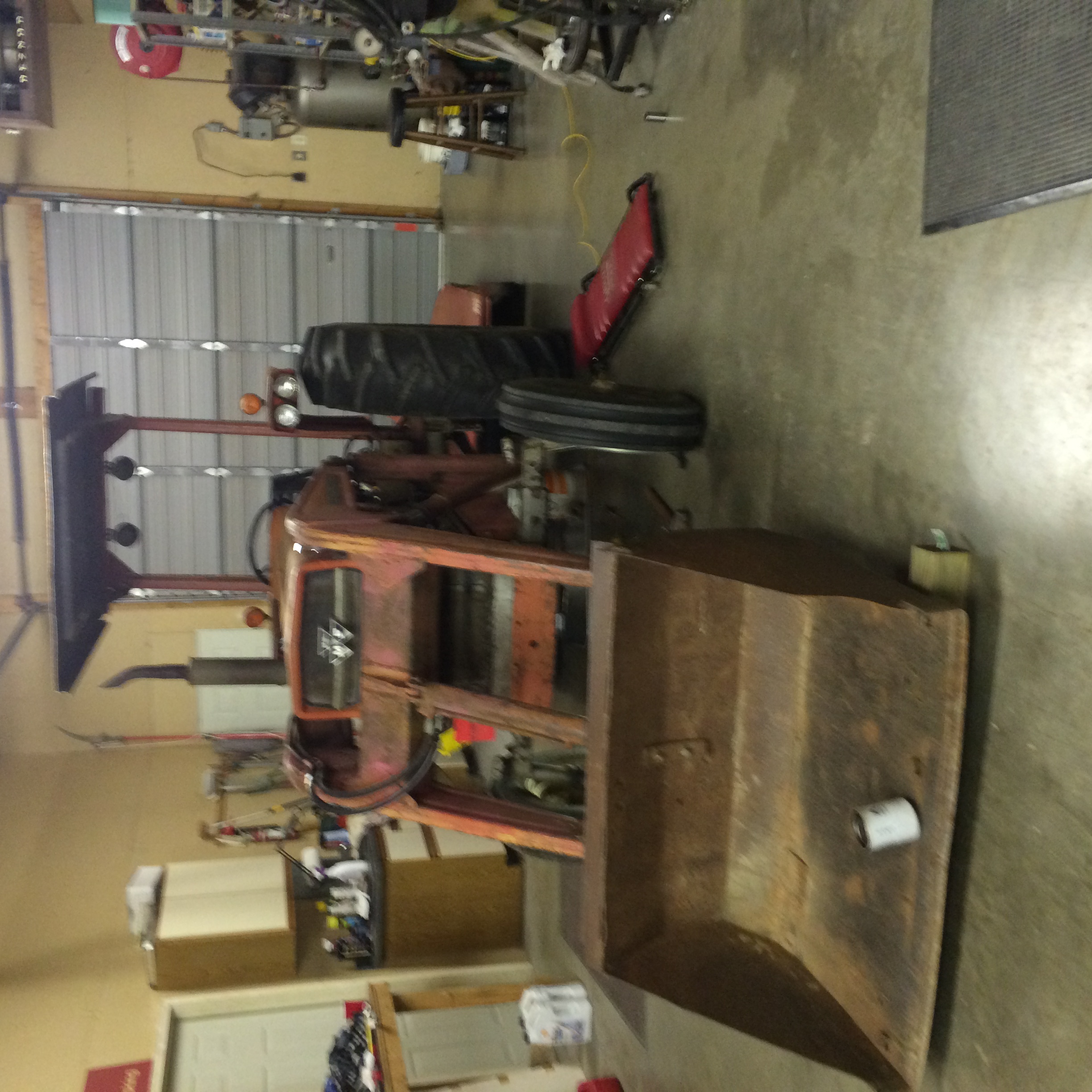

The front bucket is worn out, all the mounting pins have worn elongated holes

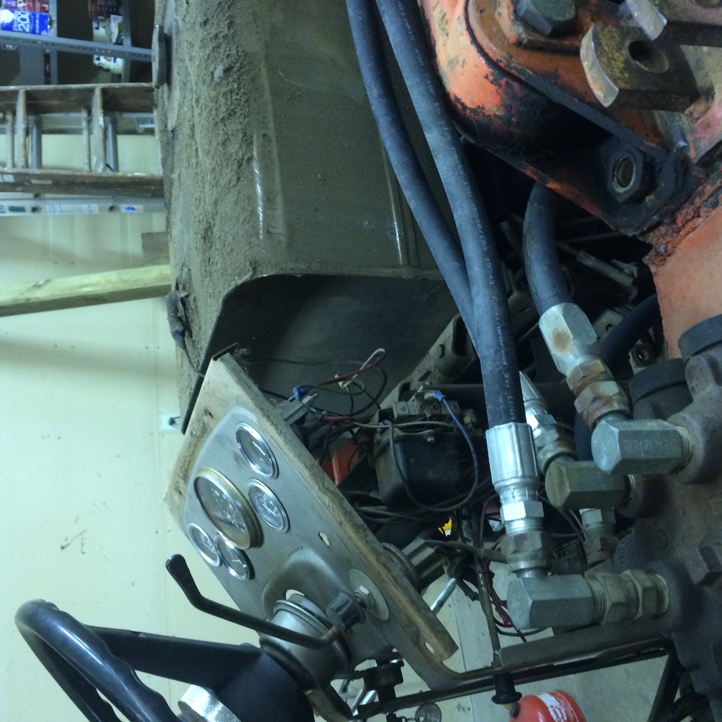

Needs to be rewired and some gauges replaced (lights work just messy splices)
It will need a clutch in a few years, not slipping but had to adjust it to get it to disengage (seems suspect

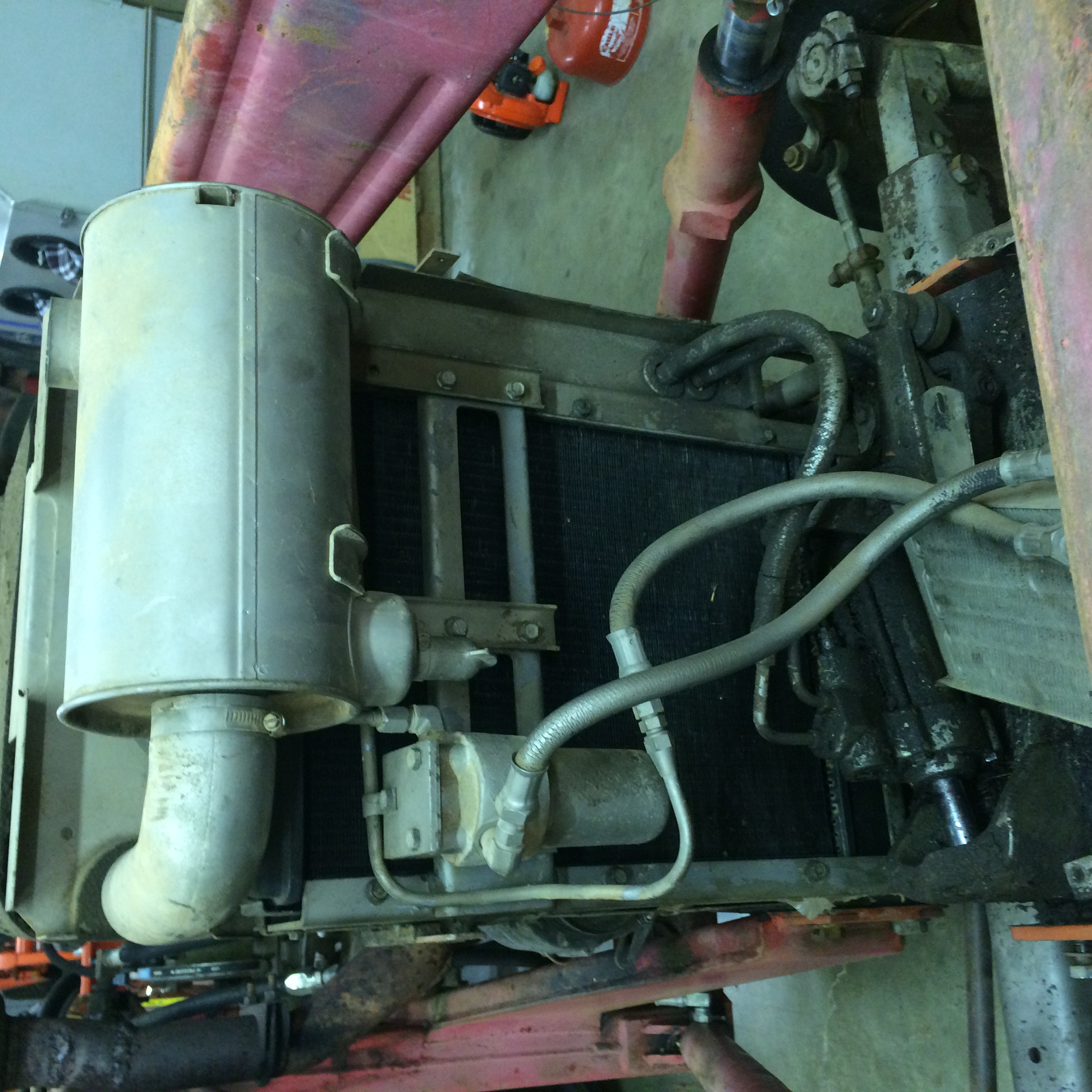

The plug on the top of the power steering pump is that where i add or check fluid (no reservoir found) what does it take and how full should it be?
Also do I need to turn the wheel a certain way?
   / MF175 #7
I use atf on mine 135, there's a filter inside the pump that probably should be replaced.
   / MF175 #8
On the 178 model the power steering oil reservoir is on the right lower front of the engine (below the altenator)and has a 4 or 6 sided bung in it. The early models had the 4 sided bung. (Note there are two different shapes of reservoir.)
