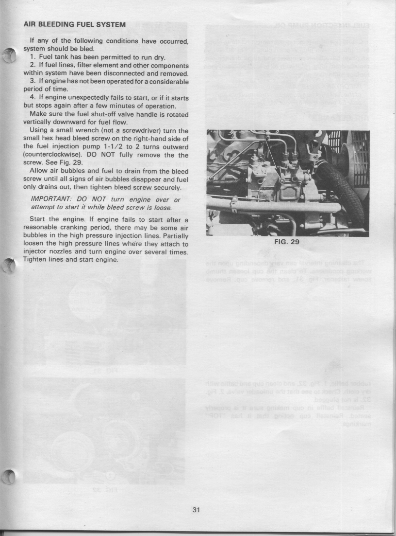

Hi, I decided to change my fuel filter on my own. I know bad idea. I thought if I bled the lines no problem, right? Wrong. Now it won't start. Anyone have any advise? Thanks.

I have a MF210 and the manuals. Here is the page on bleeding the system. The fuel filter is an easy thing to change BUT a diesel fuel system can be a pain if you have dirty fuel or algae in the fuel. I love diesels but still have a lot to learn. Assuming you kept everything clean during the change and no grass or dirt or leaf parts or ... got into the system then you need to get the last little bit of air out. Below is the link to the page. I hope it helps. Oh, is your battery fully charged as a diesel has to spin well to crank? MF210 Fuel Bleed page.jpg
If it still does not crank then my mechanic (when I gave up on by Ford 5600) slightly loosen the nut on several fuel injectors and bleed the air there. He also told me to be very careful with starter fluid as the intense explosion in the cylinder shatters the upper cylinder ring causing lower compression that makes it harder to start and it becomes "addicted" to starter fluid. Good Luck. Let us know how it goes.

Mr. Davis, you are a life saver. I followed the instructions and after waiting patiently it started right up. I don't like to use starter fluid unless I have to. So I kept it simple. Which manual do you have? I looked on line, but every description was vague; therefore, I have not ordered one. I am thinking of selling this tractor in order to purchase one with a loader. It has 1007 hours on it, and aside from the paint being faded it is in pretty good shape. I have limited knowledge of tractors. I was wondering if you could suggest an asking price for my MF210 and perhaps you could recommend a good compact tractor to be on the look for? Once again, I want to thank you for providing this information. I looked on line at YouTube, but all the examples were for models with bleed valves on the filter housing. God Bless America.
