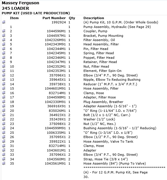

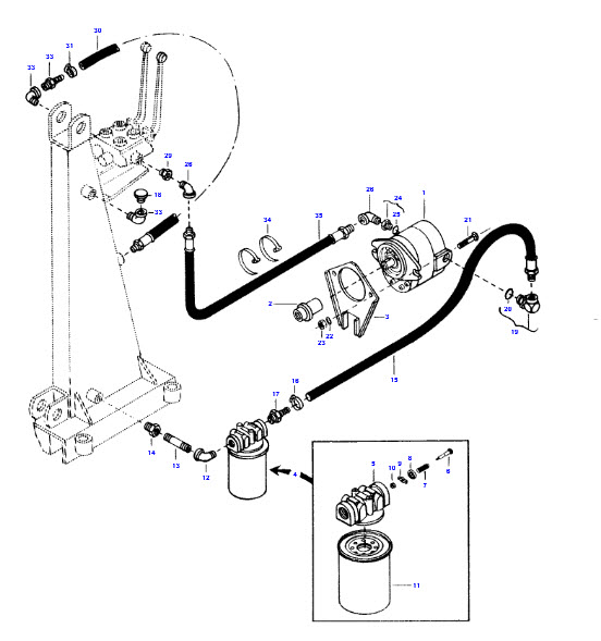

I have a MF245 my front loader is hooked up to a wetline currently. Which will not allow me to use the loader and 3 point hitch together. I have to hit the valve and choose between either, or. I'm wanting to put an Aux pump on the front of the tractor off the crank that will allow me to use both together. I have poured across the internet looking for the one I need and I remain unsure after reading about multiple pumps.
Does anyone have an Aux pump on their Mf245, to run their loader. If so what brand, etc..?

Here ya go, of course the pump looks like it depends on what year your machine is, but this should get you started. Check out Agco parts book online at AGCO Parts Books
Log in as guest user, then put in your machine. Looks like an SAE type A pump, you can get one pretty cheap through surpluscenter.com. Make sure the gpm is sufficient at your normal working RPM range. See pics:

Your a life saver. That's exactly what I'm looking for. Thanks.

No problem, let us know if you've got any other questions!
Edit: also, take a look at surpluscenter.com for a hydraulic pump, they've got great deals and you should be able to find something that fits your budget and machine pretty easily. Again, just pay close attention to gpm flow and the RPM that flow is measured at.
