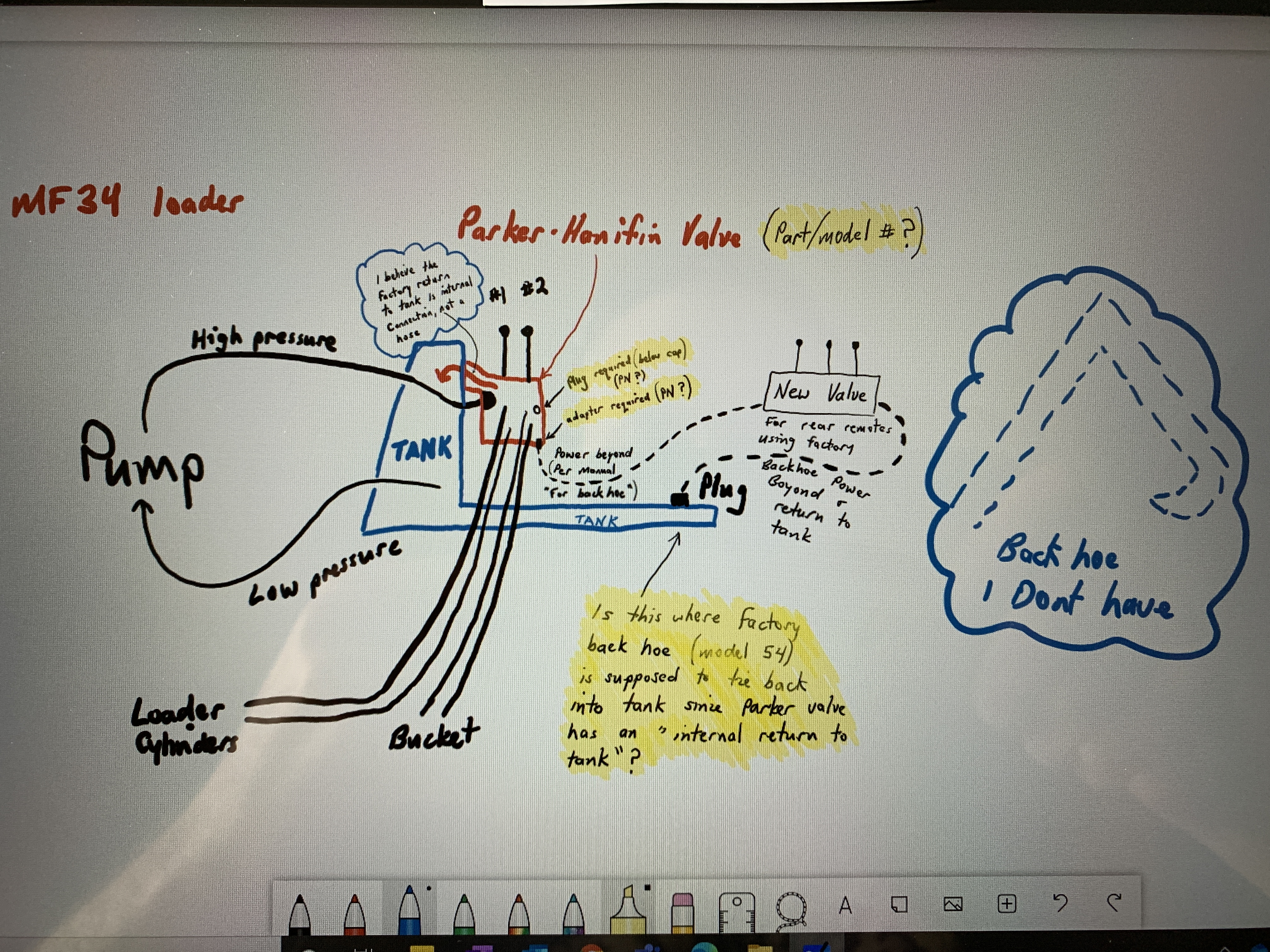

Massey Ferguson MF30, no backhoe (has loader, PTO and 3 point). I’m looking to tap into my loaders power beyond port, to run 2 or possibly 3 rear remotes, using the power beyond port which the manual identifies as for backhoe hydraulics. However I am unclear on where my return line from new rear remote spool valve is to be plumbed back into the tank? The manual shows a check valve required on the return to tank line from backhoe, no problem, and it shows the return line not being tee into the loader return line to tank, so where does this return line from backhoe supposed to tie back into the loaders hydraulic tank?
I noticed a port on top of loader frame/tank on passenger side, below floor board, where frame extends back to the rear axle, (behind the tire), might this be for backhoe return line to tank? not sure if that is actually the tank or just a structural member of frame

I should think...Normally the return line after the added valve would be same location as it is now, you simply connect (in series) new valve "P" port (power) to existing valve PB port (power beyond) and new valve BP port to existing tank location ...Be sure return port has proper "plug" in to allow power beyond port to function properly...

The PB port of your new valve would connect to the PB line leaving the loader valve. The new valve is inserted in line, not tee'd in. You can tee the tank port of the new valve into the tank line going from the loader to the tank.

Thanks for the comments and support everyone, great feedback on my hydraulics. I don’t think I was clear on what I need help with.

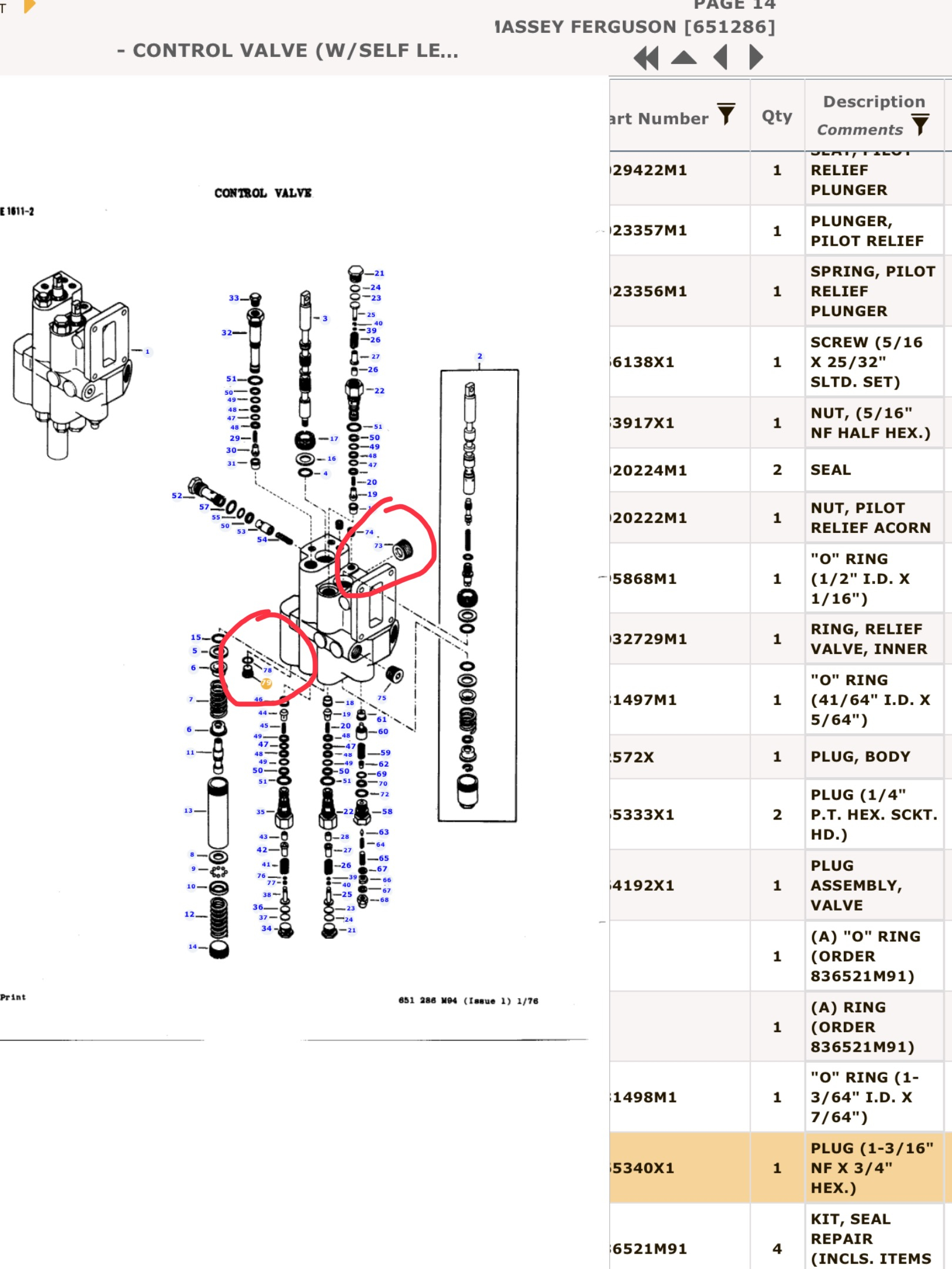

Can anyone confirm “where the factory backhoe units return to tank hydraulic hose connects to on an MF30 loader/reservoir?” I think it gets plumbed to the rear axle support as per attached but would like to confirm

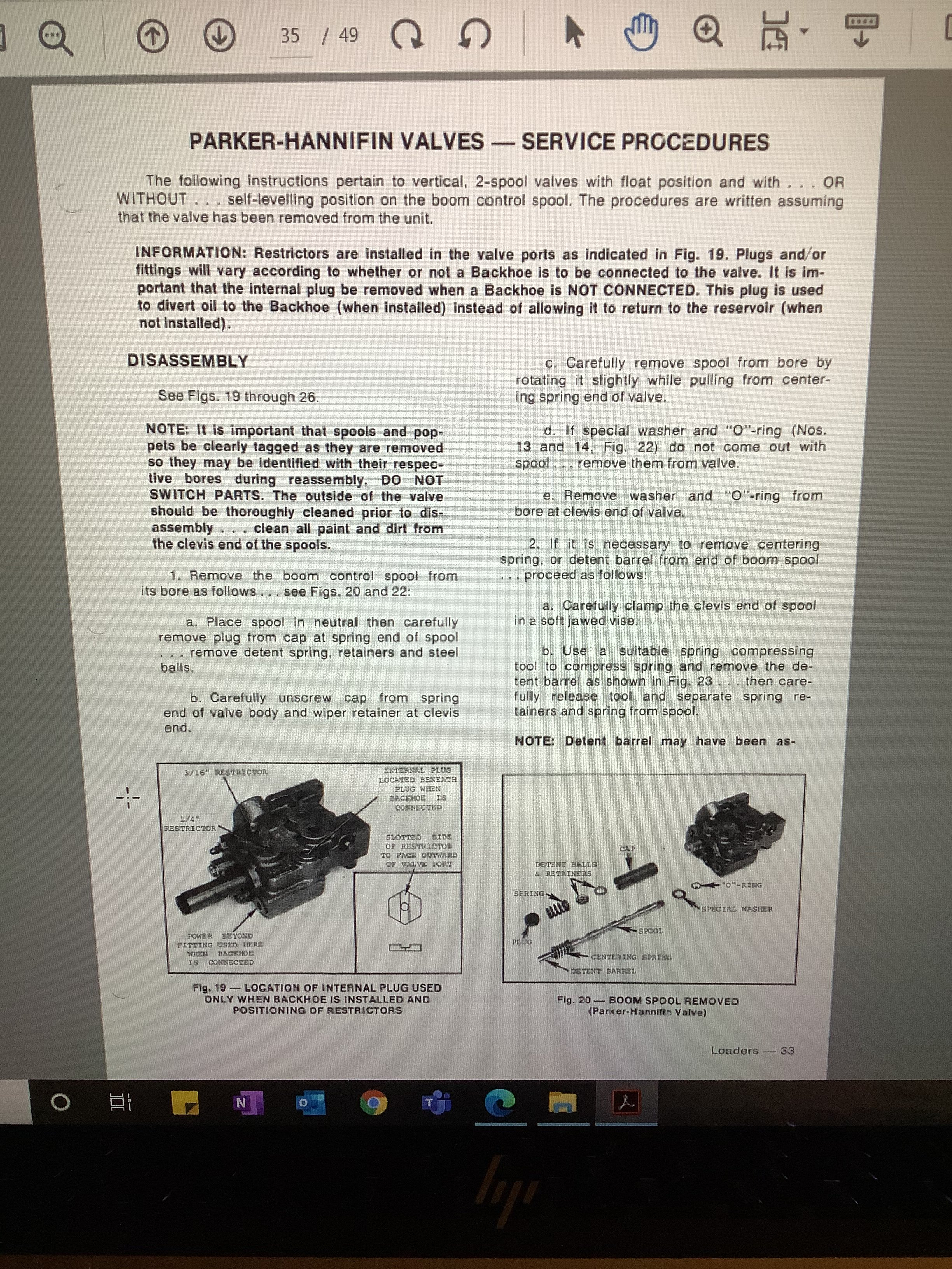

And secondly, Unfortunately my tractor has a cab on it, so I can not see the identification plate on the back side of my Parker Hannifin loader Valve. In order for my local dealer or hydraulic shop to get me the plug, and power beyond adapter for the PB hose connection, Does anyone have an MF30 and could post a picture of the plate? Or advise to the information contained on their name plate? perhaps others have done this change and know the part numbers I need?

That's what I said, though in a possibly confusing way. The PB out of the loader goes to the new valve (into the P port as you noted). The new valve's PB goes into the line that was connected to the loader's PB port. You're just inserting the new valve into the chain.
For the OP, there should be seven ports on the loader valve. Four go to the loader. One is P (input) from the pump. The other two are PB and Tank. PB will go back to where the BH gets plugged in. Tank will go to the transmission somewhere.

after some more digging I spoke with a dealer who was able to advise of the part numbers and even helped me locate the parts I need. The diagram I sketched above is correct, the rear support on loader frame is part of the tank and has a 1” PT plug on top which gets removed for the return to tank hose, when using a second valve in chain. This requires a check valve due to location at bottom of tank. the Parker Hannifin loader valve has a 1/2”PT allen head plug, part number 70917970 (crossed referenced in MF system as PN 356035x1). And gets installed below plug # 73 on exploded valve diagram, per the manuals instructions when using power beyond. Lastly, the power beyond “adapter”, is part number 366851x91, which allows for the hose connection into the bottom power beyond port once the plug is removed, (plug #79 on exploded diagram). Agco/MF have discontinued the adapter, however based on photo from dealer, it appears like it might simply be an adapter for different pipe thread/size of the hose end, allowing for the hose to thread into the loader valve.
