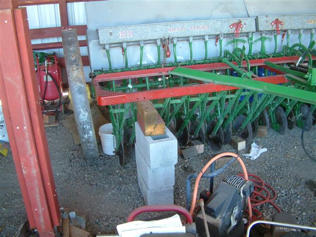

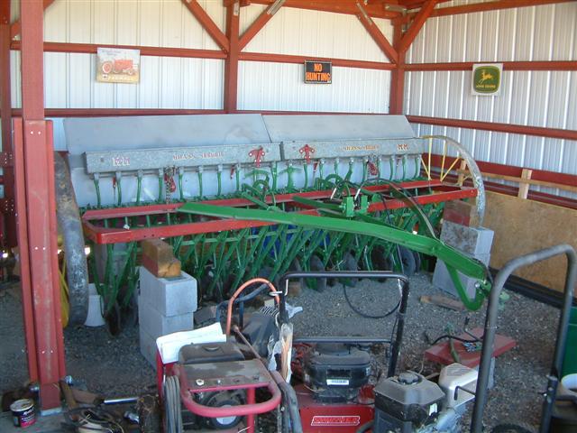

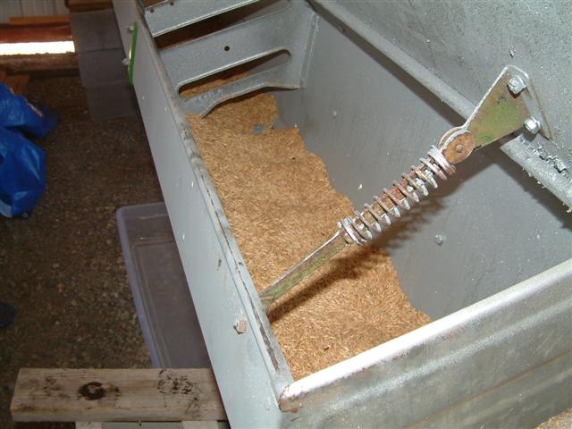

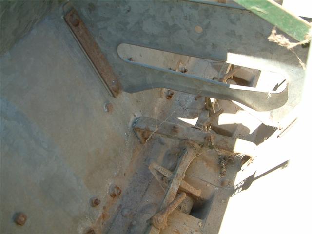

The agitator isn't a critical component. Just remove it and tape over the seed holes.
Last year I restored an old Minneapolis Moline P3-6 grain drill (10 ft wide, 20 drops, single disc openers). I used it to plant Kanota oats on 5 acres last Oct. No problem getting the oat seed to feed properly without the agitator.
Here's the agitator before I started refurbishment
After refurbishment and during calibration
