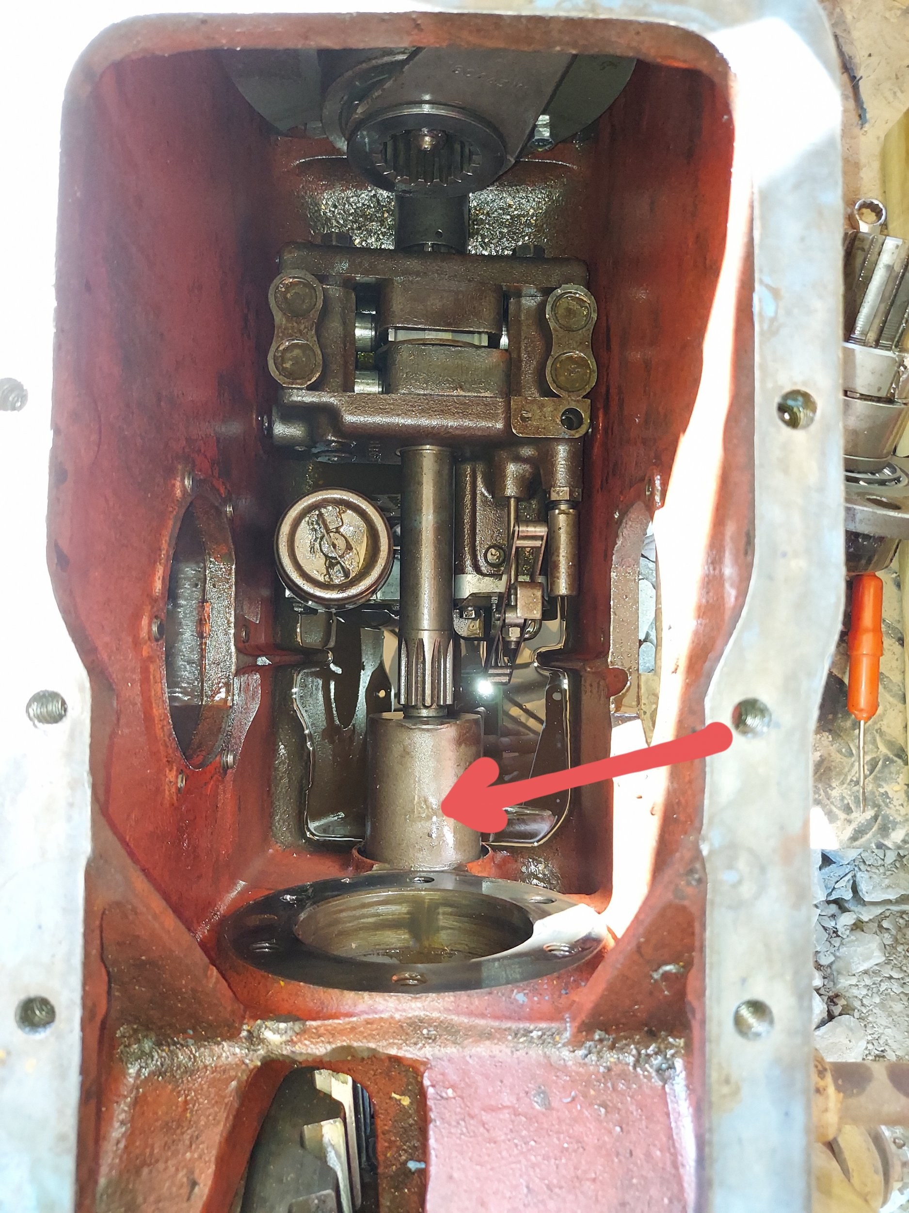

Hello all,
I bought an old tractor. It's a 63' MF35 perkins diesel with an MF100 loader. It had been neglected but still loaded on my trailer under its own power. I have done repairs to the front loader pump shaft and coupler, rewired everything, it runs pretty good but the rear lift doesn't work. I ordered a lift pump rebuild kit. I'm attempting to pull the old pump. Got the top plate off, the side pins out, the drive shaft removed, and the cotter pin pulled from front coupler on pump. This is where it goes sideways. All the videos and diagrams I've seen are of mf35s that have PTOs. Mine doesn't. Instead it has what appears to be a live center with a roller bearing in it where the PTO should be. Any ideas how it is supposed to come out? I can't find and bolts, keeper pins, or snap rings that are holding it in.
