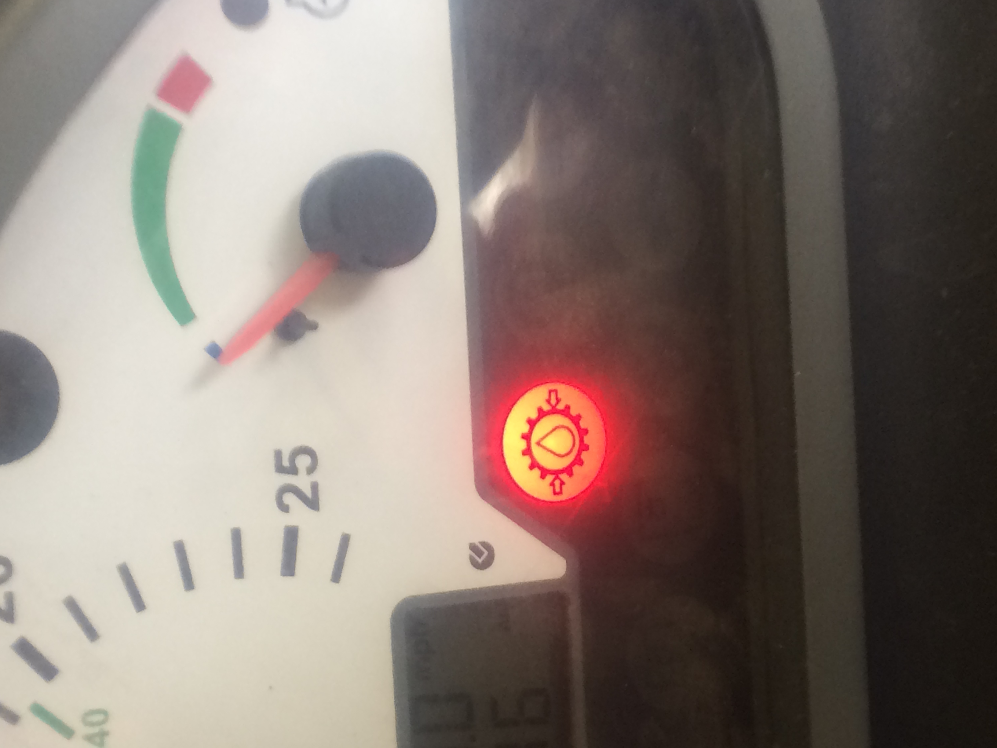

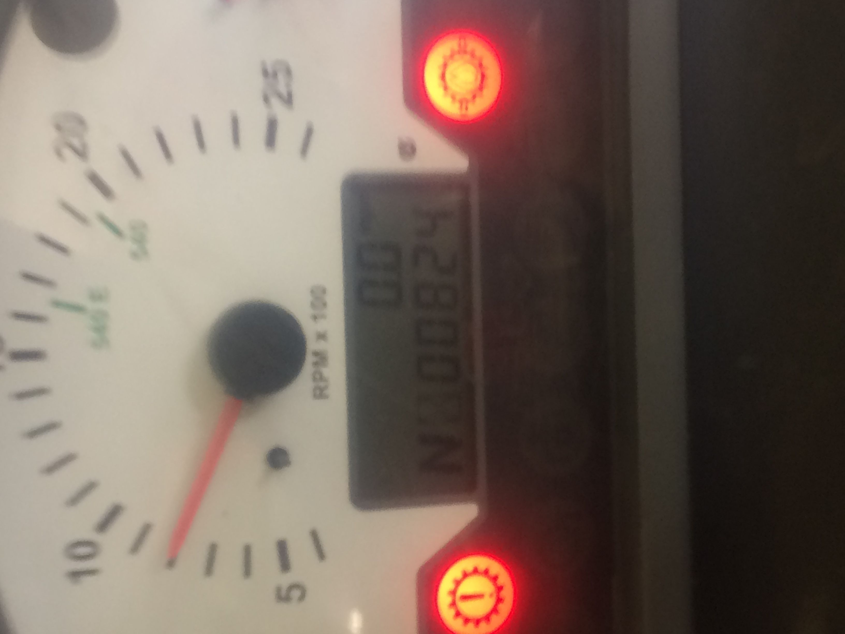

I have a couple of lights that have showed up on the tractor I just bought. I'll try to attach a pic of the two lights. We pulled into the shop, and have been tinkering on it adding tool boxes, hooks on the bucket and stuff like that. Got on it today and it won't move! Anyone provide some insight on the lights and what can possibly be done to resolve the problem? Help please!

Here is pic of the two lights that are on.

Does it crank when you turn the key to crank?
   / MF3635 won't move #4
Looks like a oilpressure warning from the transmission.
   / MF3635 won't move
Yes it cranks fine. Loader worked as it should. Just won't move. If it is an oil pressure for the trans, what should I look for the remedy?
   / MF3635 won't move #6
Found it. Sensor located on right side of trans just behind and forward from FEL valves, cleaned and replugged wiring connector, everything is good. :)
   / MF3635 won't move #7
Good to hear it was a simple repair :)
   / MF3635 won't move #8
Yeah, very lucky for it to happen sitting in the shop rather than in the timber.
Also very lucky to find such an easy fix. Your suggestion as to what the indicator might be led us to look for a sensor on the tranny. :)
