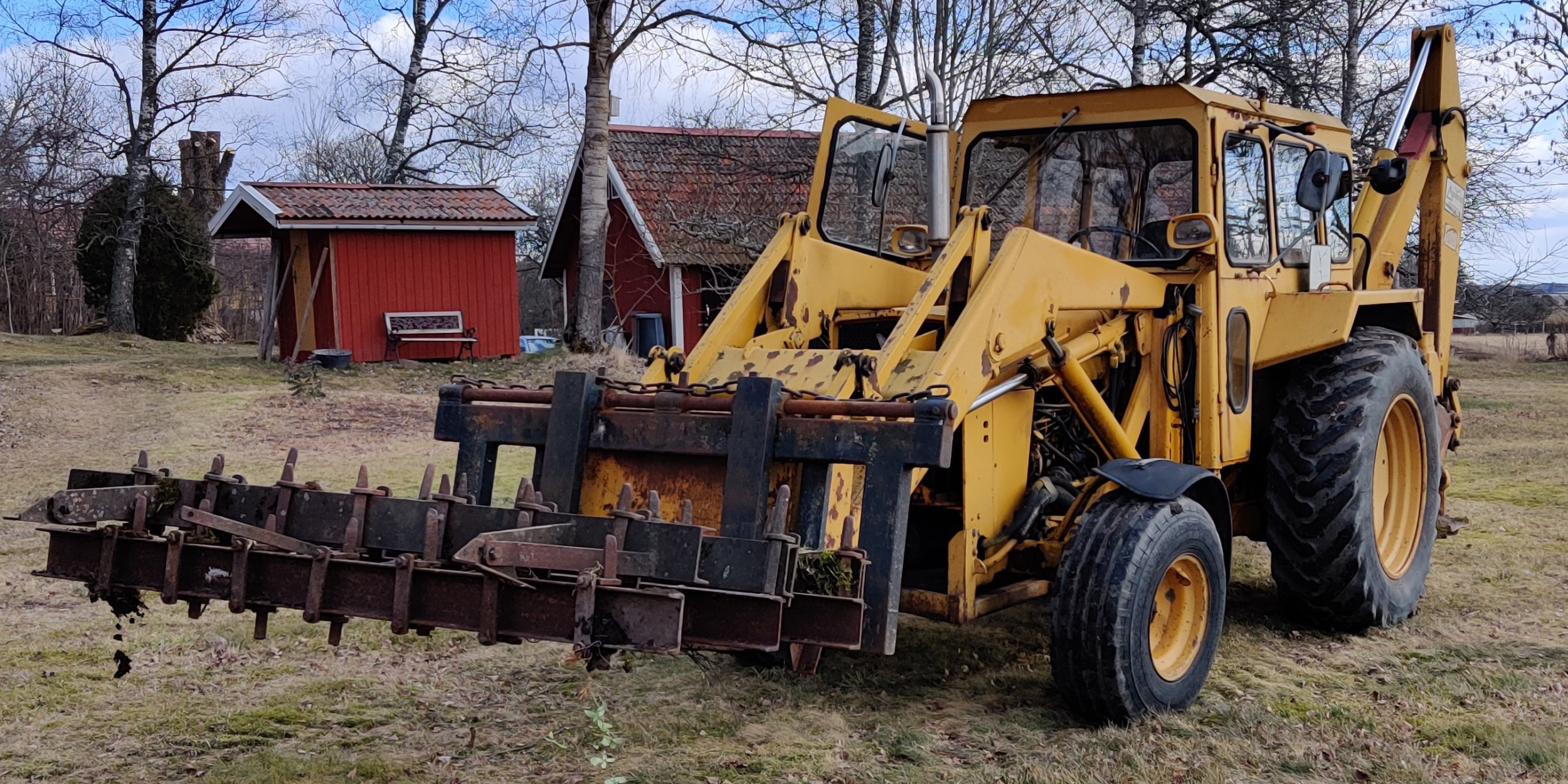

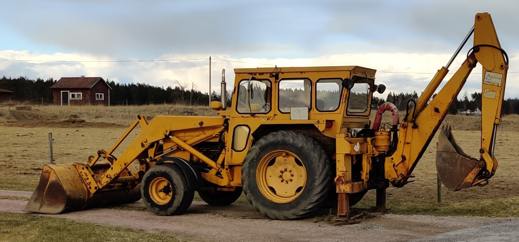

Hello all,
I'm new here, so I think a small introduction would be good. A couple of months ago I have bought a 1971 Massey Ferguson MF50 industrial (backhoe) tractor, here in Sweden. The label actually mentions the type MF50R, but I think that might be the name the Swedish importer gave it (I can find no references to a model R on the internet and the serial number on the dashboard starts with MF50). It has a non-standard cab and lights, which were apparently done by the Swedish importer at that time.
The tractor is in a reasonably good condition, it has the Perkins A4-212 diesel motor which is running super smooth.
Now here is my problem: I have driven the tractor for the past few months without any issues at all. However, yesterday while I was driving it, all of a sudden a very loud grinding noise started to appear. I immediately stopped the tractor and that immediately stopped the noise as well. When after a few moments I started driving again, the noise was gone.
I then drove it for another half hour or so without issues, when all of a sudden the same thing happened again. Very loud grinding noise, I stop and the noise goes away, when I hit the gas pedal afterwards no problem.
Since the tractor was in a bad position, I had to drive it back to storage again, during that small drive, the same thing happened again and again and again. Sometimes after driving only a couple of meters.
Each time, I stopped the tractor immediately after the noise came up.
It must be noted that this tractor has the 'instant reverse transmission'. There is only a fork shaped gas pedal with reverse and forward directions (it serves as a clutch and accelerator in one).
Is there anyone that has a clue where to start looking for the problem? And possibly knows what is causing this exactly?
Something with the transmission seems logical.
So far, I have checked the oil level in the transmission, which was completely full, so that looks good at first glance.
/Hugo
