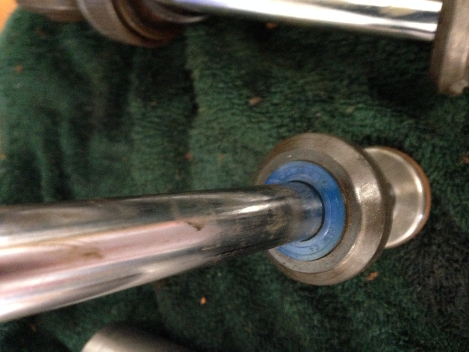

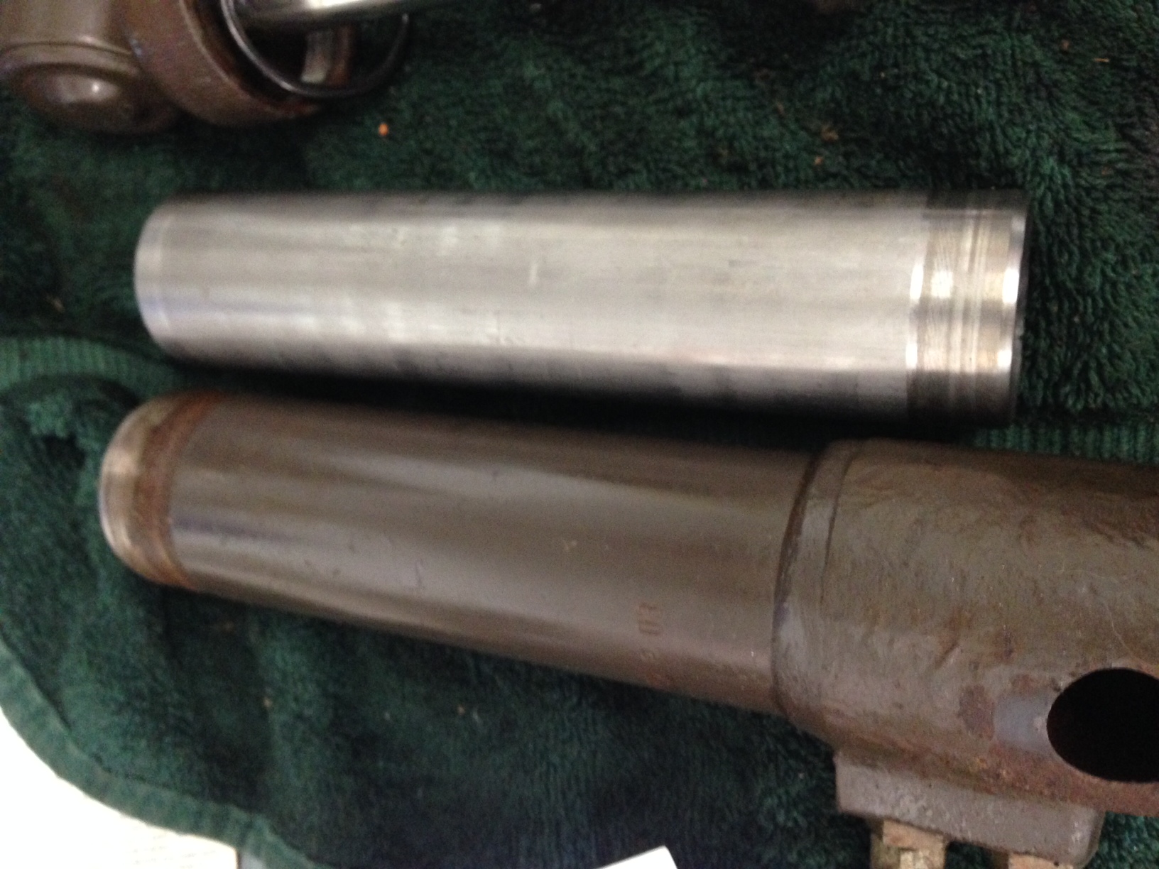

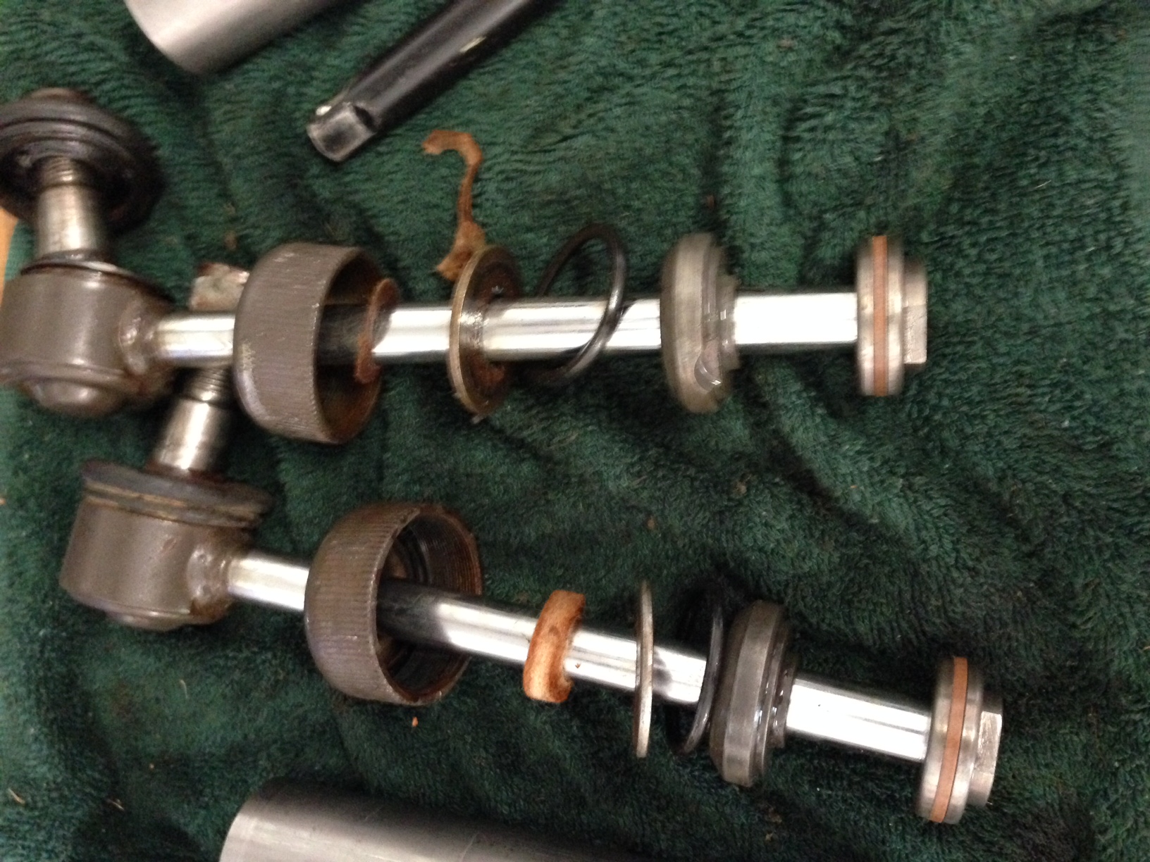

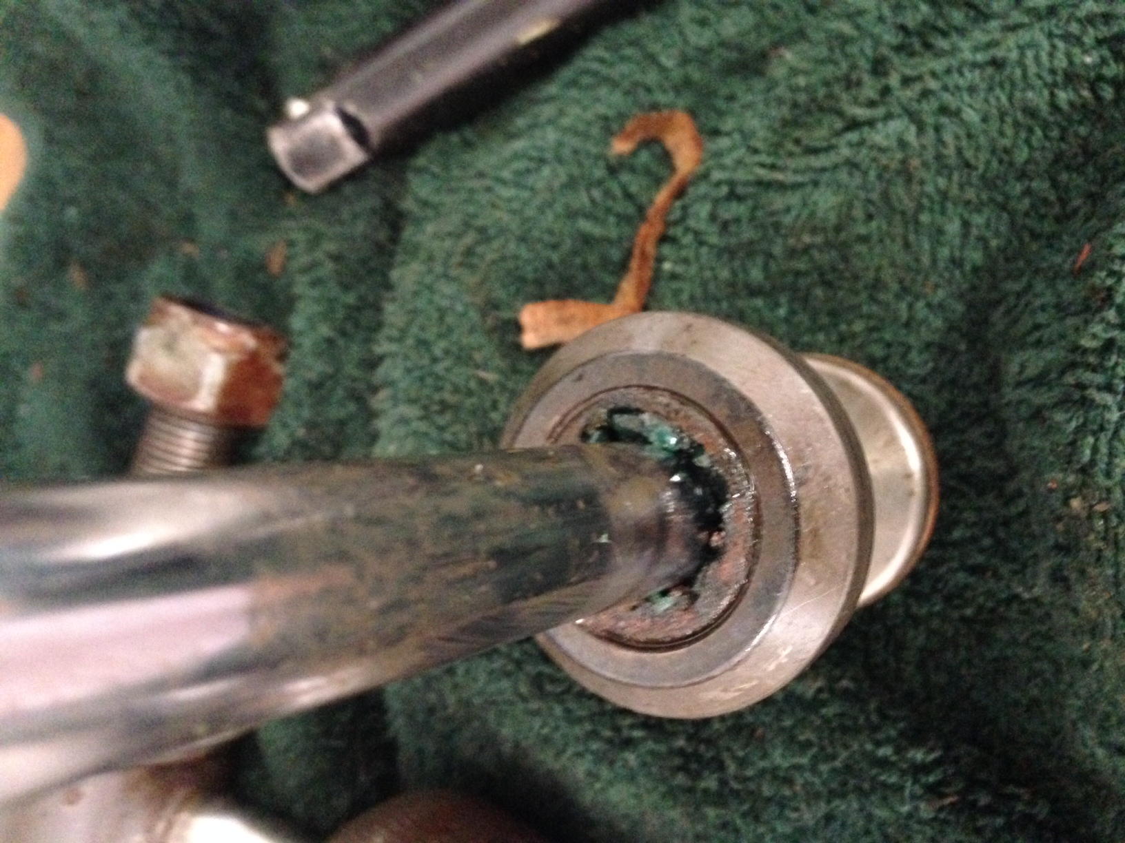

   / MH 245 steering #3
So you have two steering cylinders?
It depends how fast the one cylinder is leaking. If it is a steady stream, that could be your issue. If you wanted to rebuild the cylinders it is not that difficult to do with basic hand tools. And to do both sides it is less than $60 in parts.

   / MH 245 steering #6
Replacing the pump did not fix the problem. I am currently working on replacing the seals in the steering cylinder.
