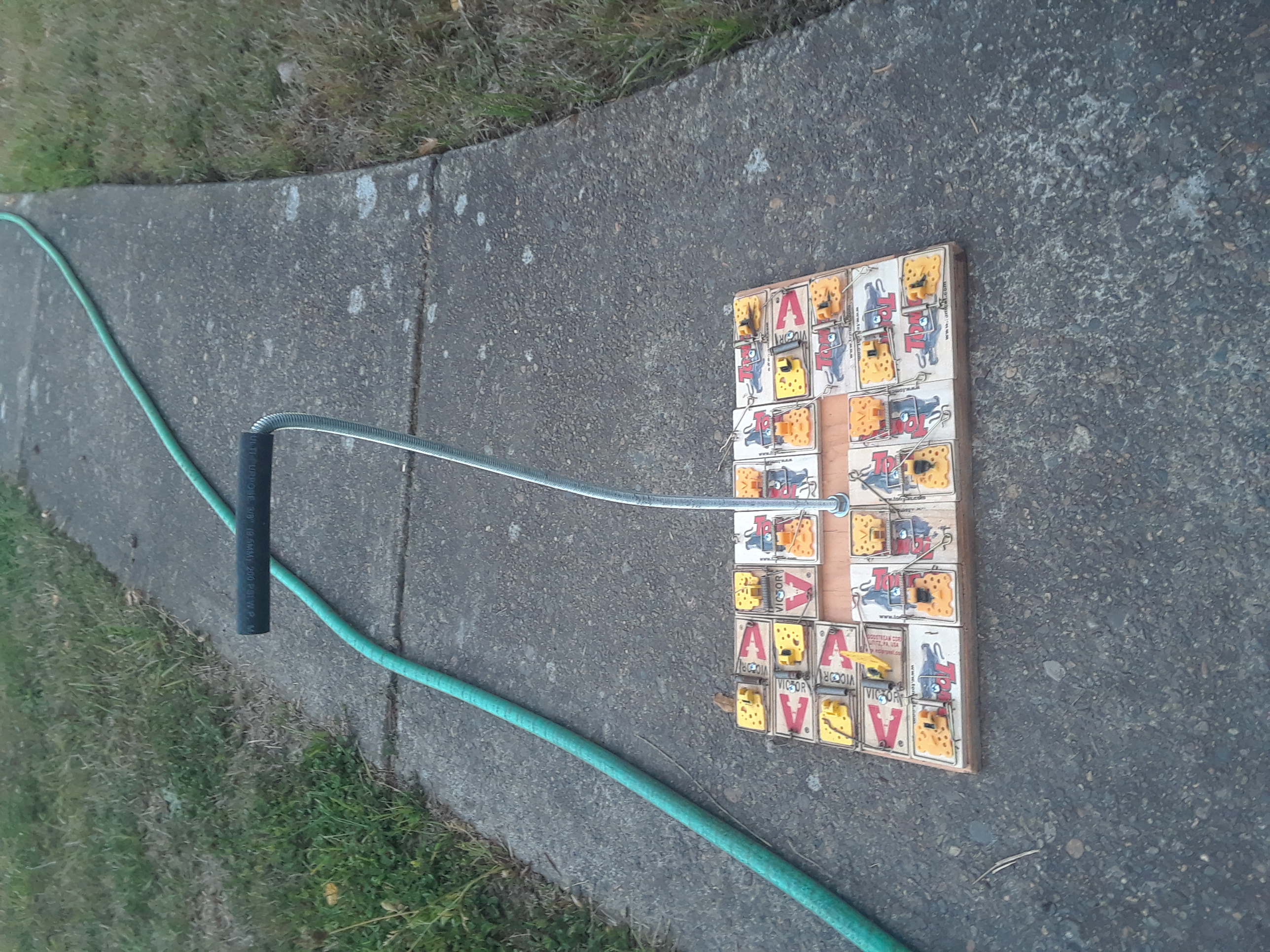

This is my mousetrap setup, works great, don't even need bait, don't have to bend down... I made two of them with 7 rat traps too to get the rats from my wood shed, worked good, caught both rats. also caught several mice in the rat traps...
Simple, go to Amazon or wherever and get some traps (for mouse traps the Tomcat brand with the yellow flap work best, I found rat traps in a box of I think 12 for $16 on Amazon), get a scrap of plywood, go to home depot/lowes and go to the electrical section by the steel conduit and grab a 10' stick of 3/8" allthread (most employees don't know it's there and it's $6 for 10'), grab some T nuts and regular nuts and some sheet metal screws 3/4" long and assemble... arrange the traps in alternating directions, you'd be surprised at how many are caught on the inside!
I've caught as many as 4 mice at once, sometimes they are caught in multiple traps...
