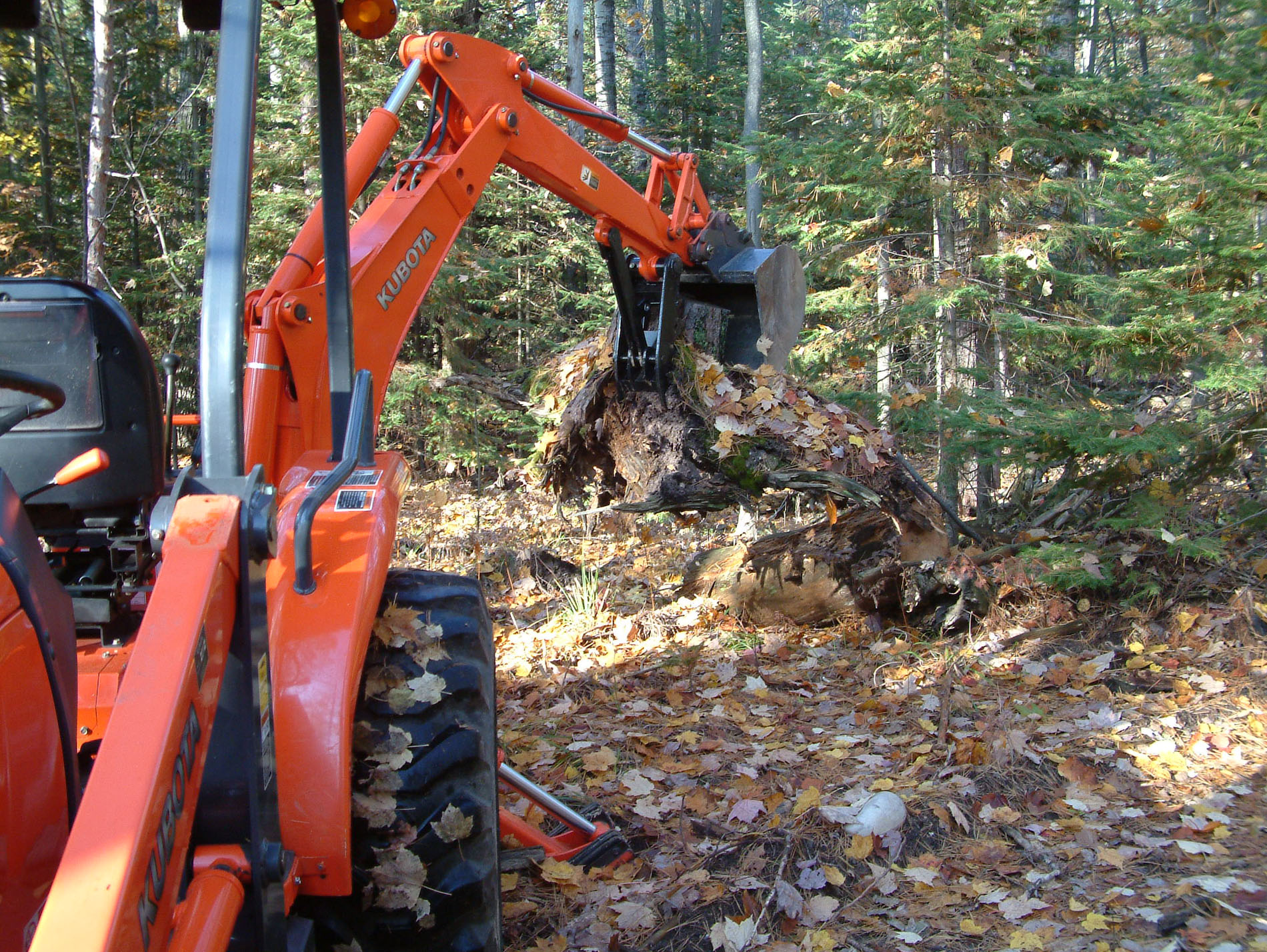

I put a manual thumb on my L39. It works good, but if I had to do it again, I would go with hydraulic.

I have the hydraulic thumb on my B26 and it has nothing to do with the bucket or the QA pin. The thumb cylinder attachment points are already on the boom and are separate from the bucket pins so that end is easy to fit. Adapting the control lever and all the hoses will be a bit time consuming and the major part of the expense of any hydraulic modification.
