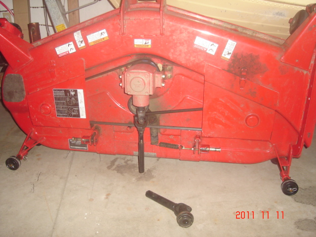

I have a GC 2310 TLB and I recently purchased a MF 2326 MMM from a guy on craigslist. Of course it only came with half the drive shaft (male splined portion that attaches to the mower) - I'm missing the female splined portion of the shaft on up to the quick-connect where it attaches to the tractor's Mid PTO.
Does anybody have any ideas on a good aftermarket solution or a source for this part? Called the dealer and they want $800 (!!!) I might as well buy a new mower.
It's an 18 spline shaft so I'm having a lot of trouble sourcing an aftermarket alternative, everything seems to be either 6 or 21 spline. I'm even having trouble finding an 18 female to 6 spline male adapter to try to get a more standard aftermarket PTO shaft to work.
Any advice is much appreciated!!:D

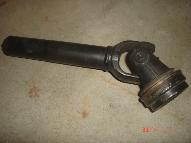

Is this the part you're looking for?

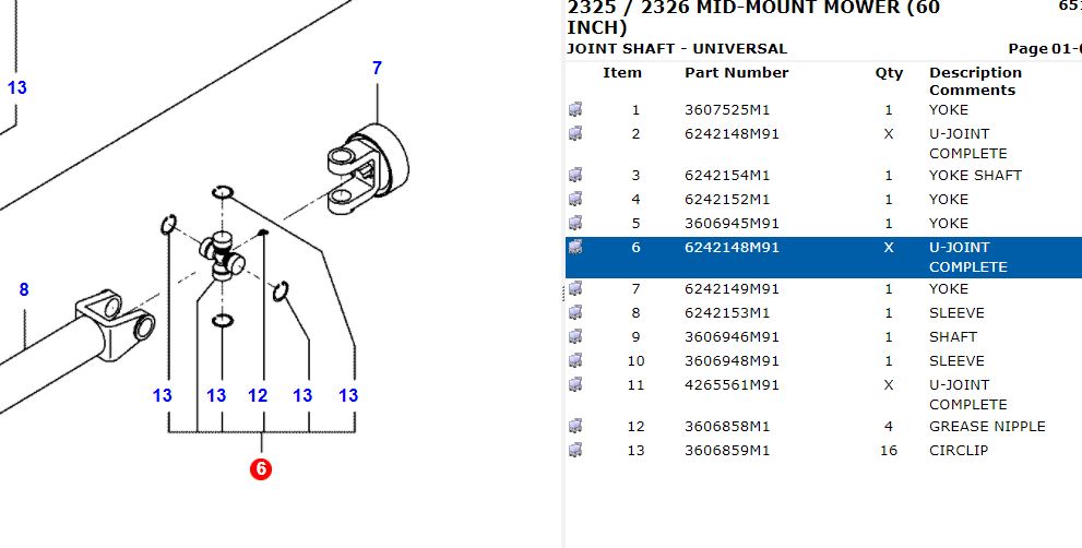

Sounds like you need items 6,7, and 8? Seems to be a bit more than $300 in part from Jacks small engines... Your dealer was probably quoting you an entire new shaft, not just the half you need.

Yup, that's exactly the part.

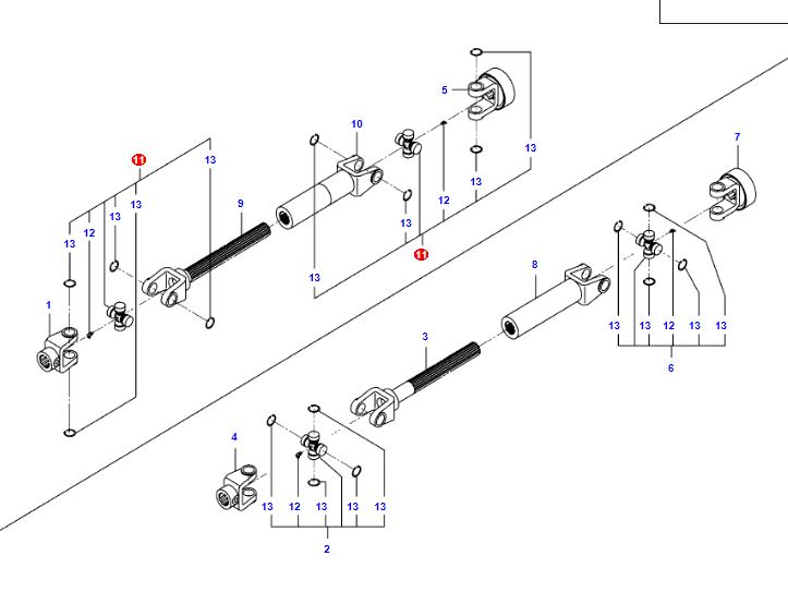

Any idea why there's two different shafts shown for this mower in the AGCOPARTSBOOK Site?
As you say, the parts 6,7 and 8 add up to just under $330 at Jack's, but part #11 is over $600! I'm guessing that's why the dealer's price was so high, he was probably including part #11. Both 6 & 11 are called "U-JOINT, COMPLETE"
