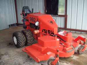

I'm not sure I'd want to take a heavy tractor out on a golf-course type lawn, and you'd be giving up a lot of traction with turf tires for regular tractor duties.
Have you considered getting two machines, perhaps used would keep you within budget. One designed to manicure fine lawns and do it fast, like a ZTR or similar, and one for the real tractor work. If you went this route, the tractor would not have to be as big in HP, maybe could down size to as small as 25 hp. The ZTR will cut more grass faster than just about anything.
A lot of options to choose from. Just look at this beast (used right now for $5500).
