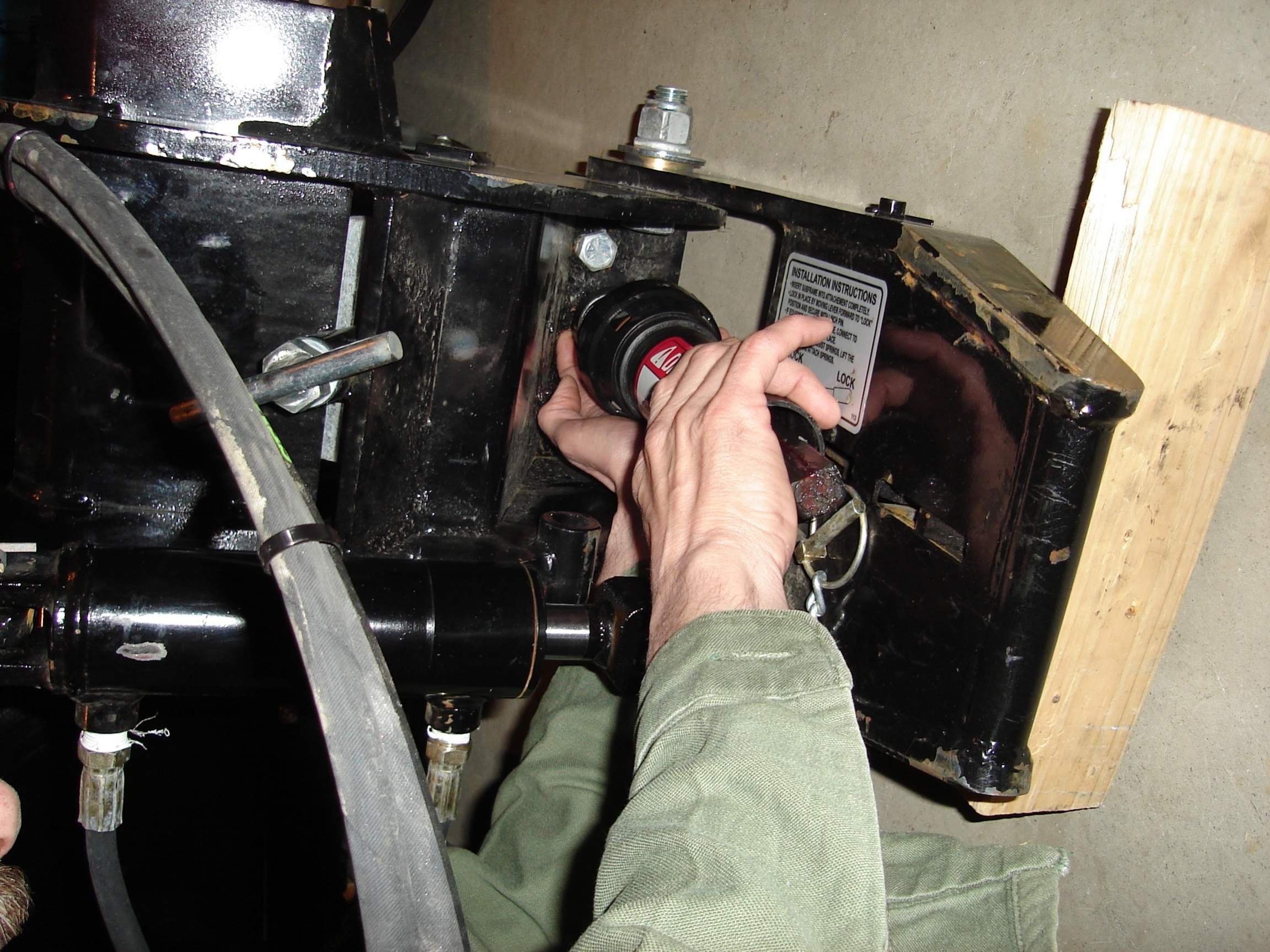

timbrehse-- IF the broom set-up is the same as for the 2360 blower, I respectfully disagree with wallace.... I do occasionally switch from blower to FEL, and the sub-frame & driveshaft assembly does not interfere with FEL operation. One thing I will do, however, is remove the frontmost stub driveshaft, to prevent packing snow or dirt into it- it has a quick disconnect located way back in there.
I raise the shoe, disconnect the quick-hitch hydraulics, coil up the hydraulic lines and simply lay them on the floor while the FEL's on. But this is just for a quick, temporary FEL job. The sub-frame is very easy to remove if you choose to.
The only other detriment is that you won't have the grille guard in place, so you need to be careful when pushing the FEL into a pile. Not so much of a problem with snow, but dirt/stones could impact the front of the tractor if you're not careful.

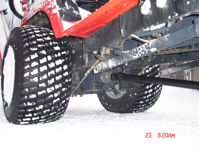

timbrehse-- we got about 18" last night, so I've been blowing... here are some better shots of driveshaft extension, sub-frame, and T-bolt with hanging lip that supports the subframe. (For the first time, I snapped the impeller shearbolt... now have a small job to take care of! :()
Hopefully you can see the quick release at the rear of the driveshaft, as well as the splined slip-joint at the front of the drivesahft/rear of subframe.
