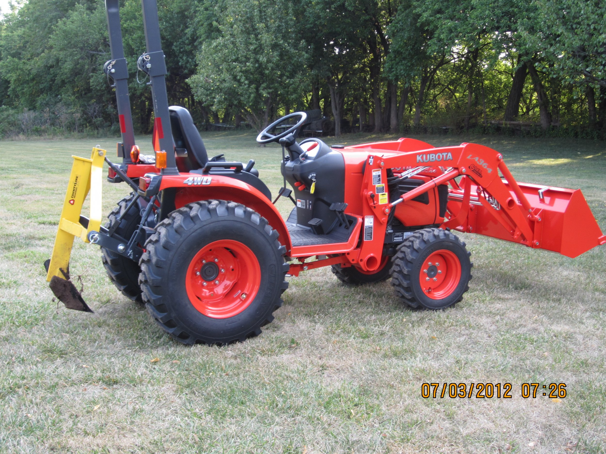

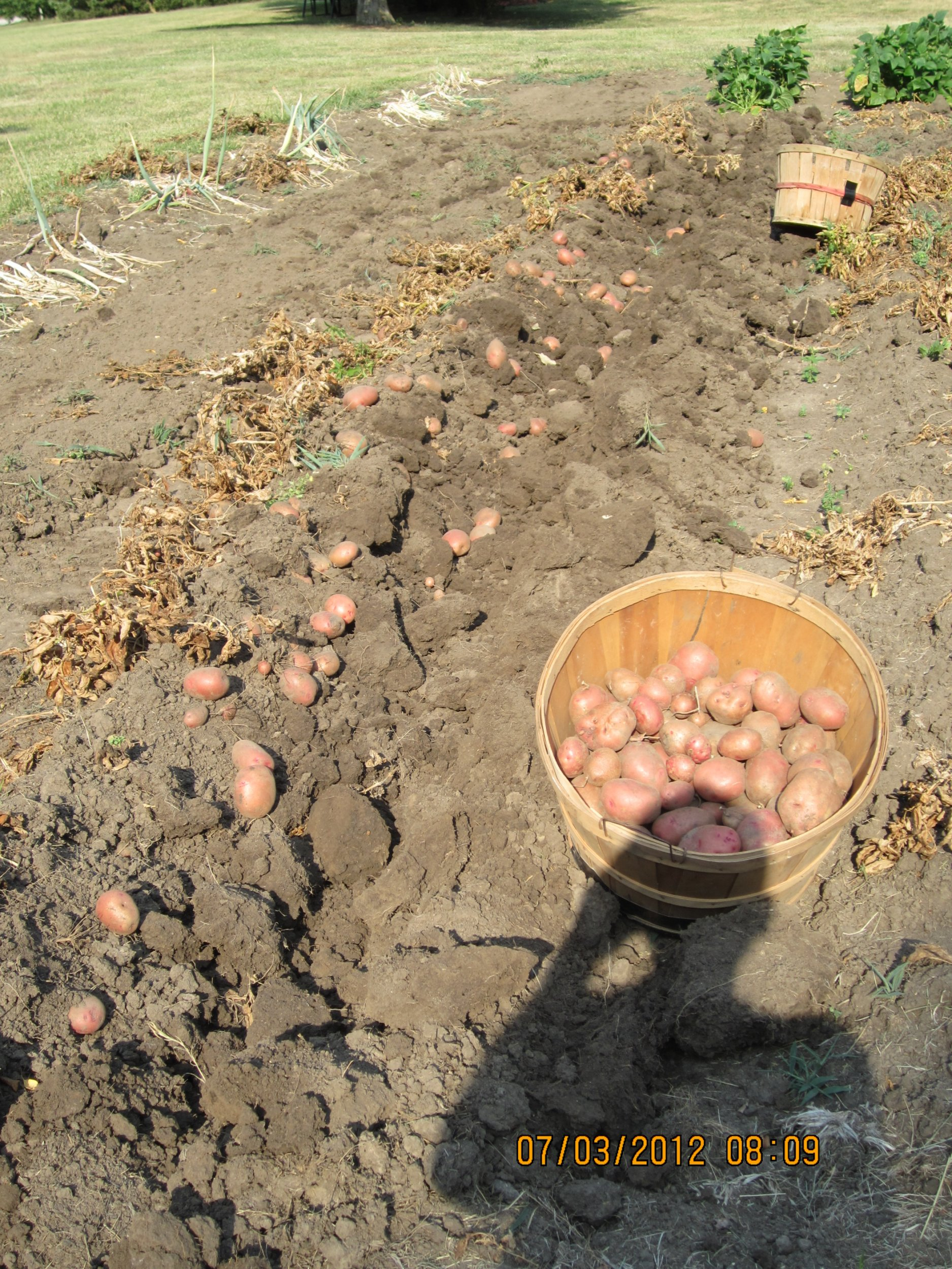

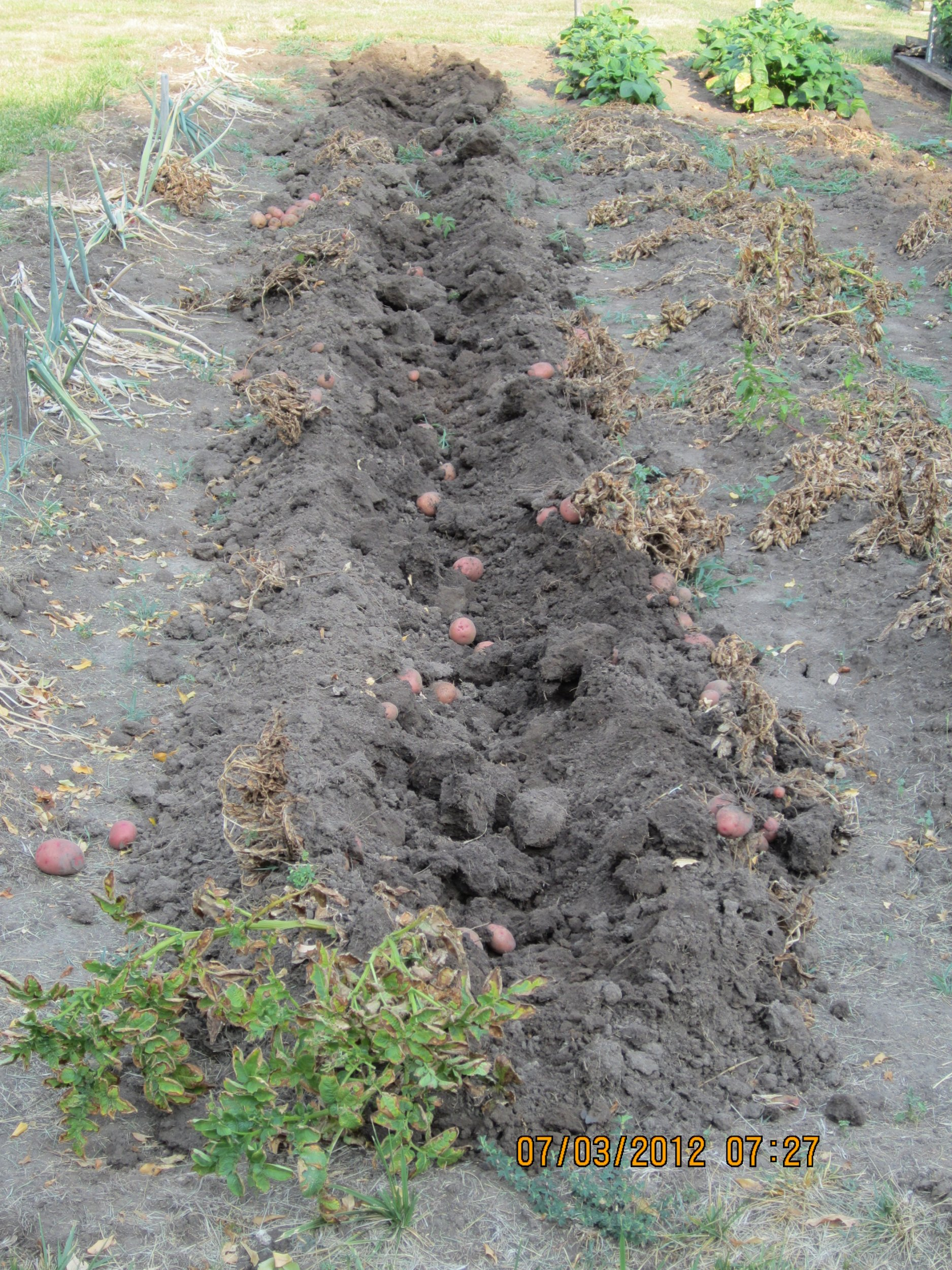

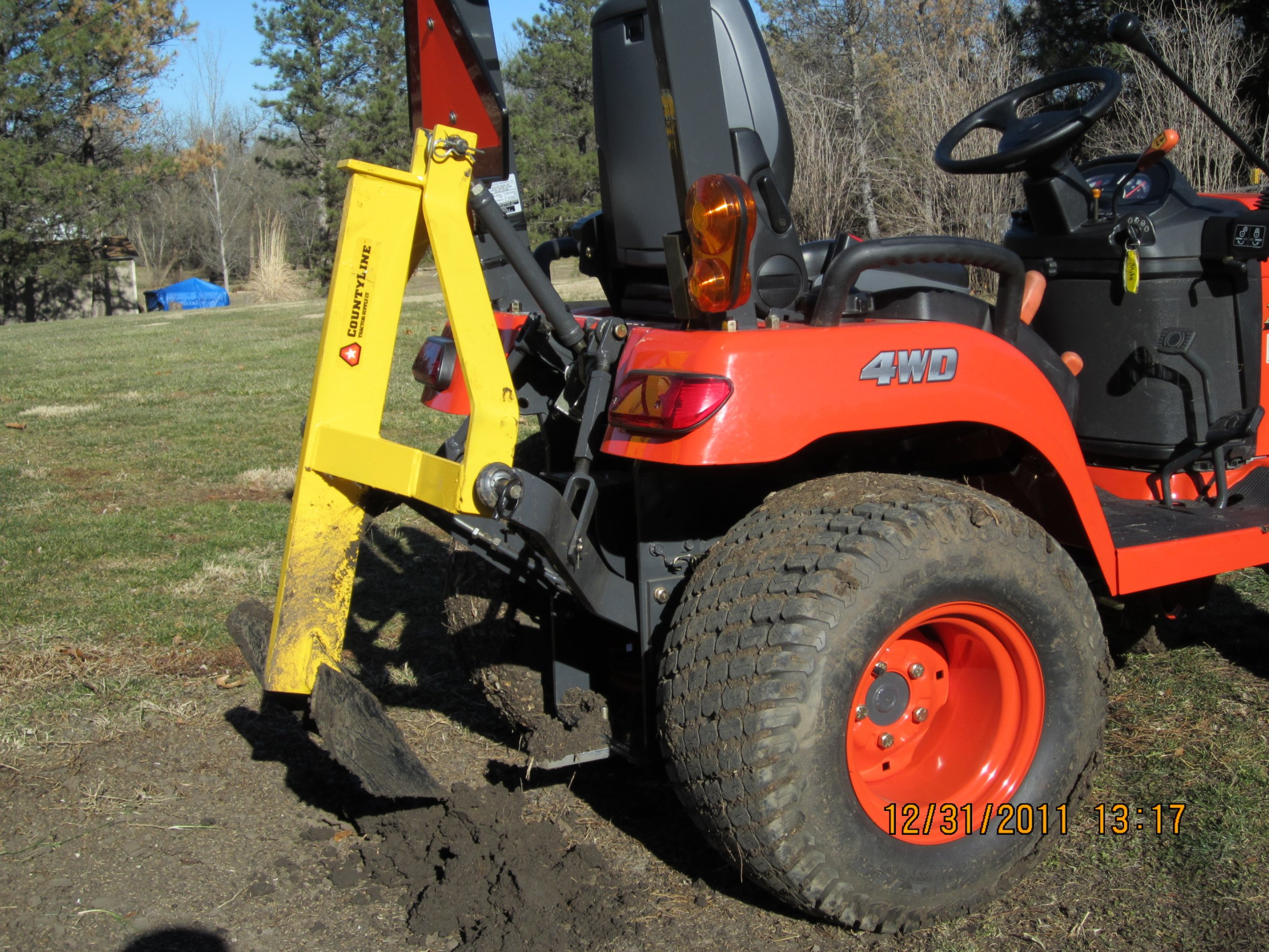

Here's some pics that might be helpful............What oldnslo said too........Later on I moved up to a B2620 that has more ground clearance....the last pic. First pic is a BX2660.
Cheers,
Mike

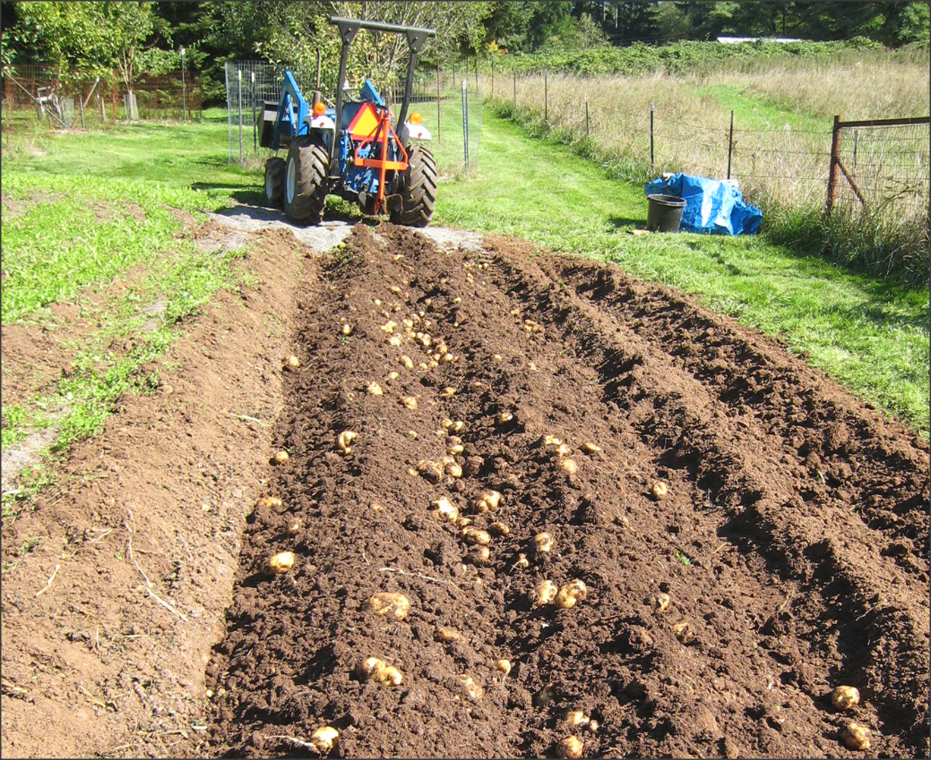

Potato plow works great and we've not seen hardly any damaged potato's.
Way more damage if dug out manually with shovel etc.
It usually takes two or three runs per row to get them all out!
