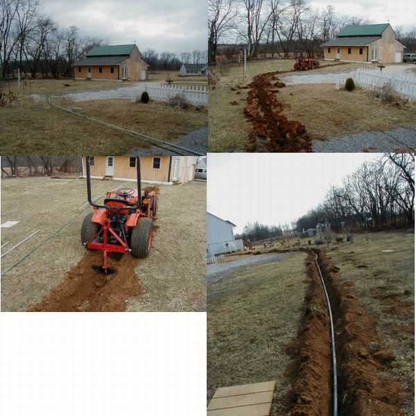

   / Middle Buster & Subsoiler #6
And here is a picture that WVBill posted using his middle buster to make a trench.
Both can be purchased at TSC, Northern ect.
Hope that helps...

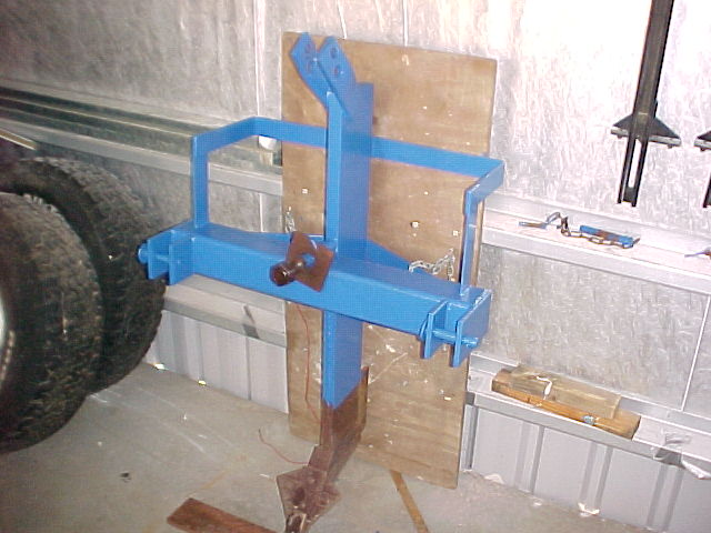

Aha
Sort of like my ripper with pipe layer. Except mine can dig a bit deeper. Sounds like the subsoiler. Refer photo.
The wide blade would never get thru my hard ground.

Neil, a subsoiler normally is longer overall length than a middle buster, so it'll go deeper, and the blade is angled farther, although there are a few "combinations" on the market on which you just change the blade. I have the middle buster (great for digging potatos), and sometimes change the blade to a single heavy duty chisel plow blade, to dig narrow trenches.

I have used mine to create furrow for planting potatoes and then for havesting (pops those spuds out just real fine!!), trenched around my property to bury a hidden dog fence, trenched a friend property to bury electric line. Will be using it to trench to replant some hazelnut shrubs and rhubarb plants.

<font color=blue>trenched a friend property to bury electric line</font color=blue>
How deep can you get with the implement?
