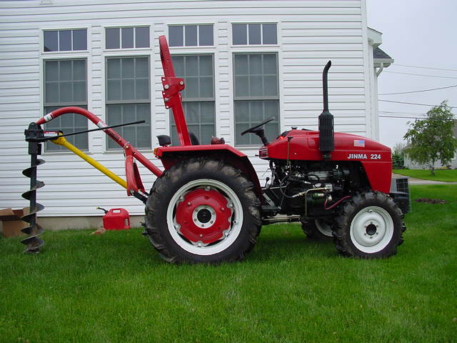

I have a one bottom plow and was wondering if a middle buster would do the same thing just twice as fast for turning the soil. Also could the middle buster be used for making ditches to lay 4" PVC drain lines? Thanks.
