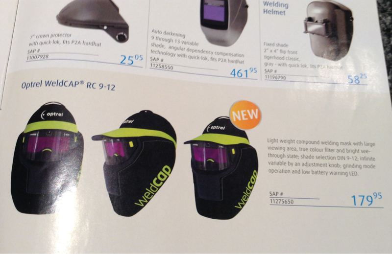

Maybe someone can post a link to the new Optrel Weld Cap. It's a redneck welding helmet if there ever was one. I'd like to try one.
   / MIG, TIG and a new helmet... #2
Not a link, but here's a pic for those who haven't seen one.

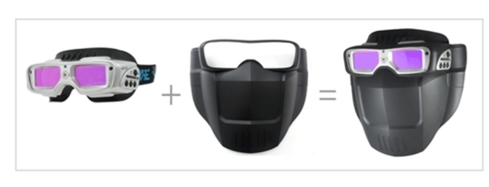

Here's one I'd like to try :)
I can think of many times it would haven been great - tight spaces - or no fogging from my breath.
Servore arc shield-513

Might be my next one. lol. But that could come in handy in more ways than one, including help protect the lens cover from my habit of laying it face down, and prevent spatter from flying up and back down, and of course, shield the sensors when using out door from being too sensitive to the sun.
