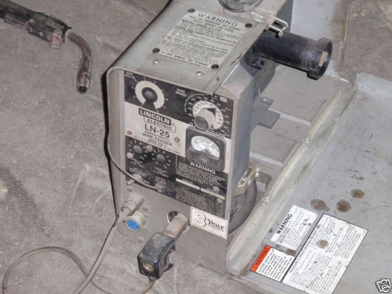

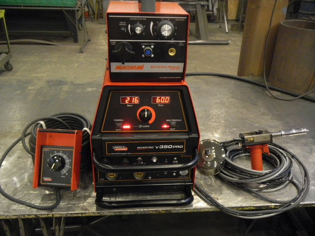

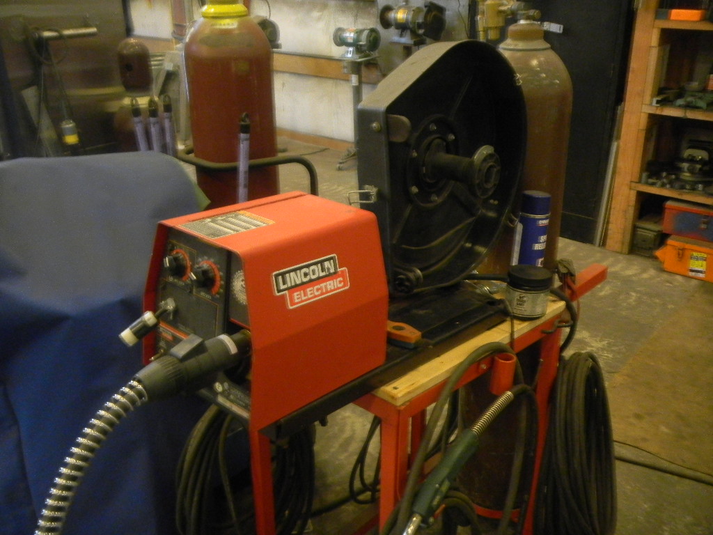

I've been very happy with this setup.

Sheildarc, that looks like some serious gear you have there!
   / MIG welder advice
#9
Shield Arc, that looks like some serious gear you have there!
