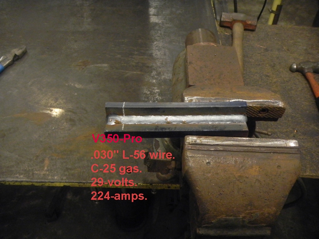

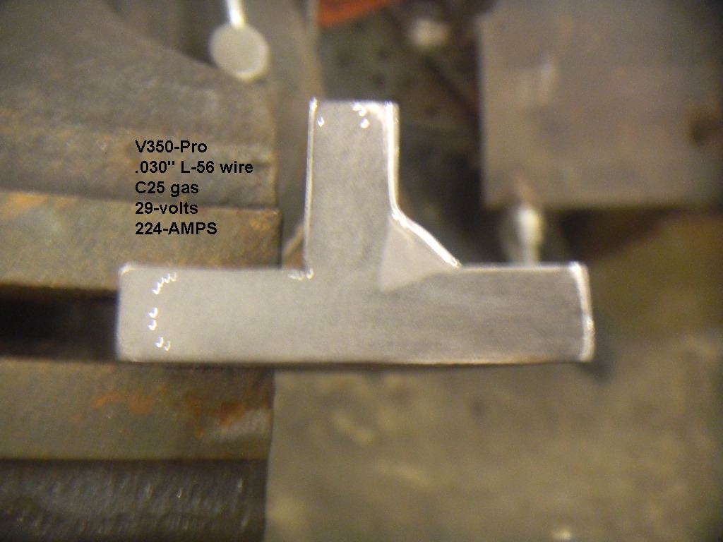

   / MIG Welder Recommendations for Newbie #2

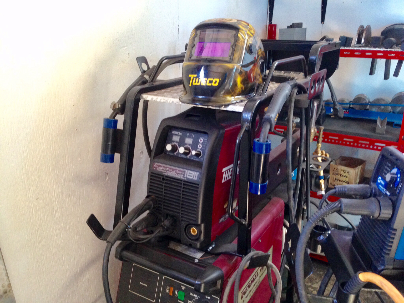

Still seems to be the 2 best bang for the buck units out there are the Everlast iMig 200 or Tweco 211i. Both 115/230v for portability and both stick weld as well. Both under $900.00. With other great features. Bare bones units would be Hobart, Lincoln 185, Tweco 181 and Miller 230v at approx. 130-150 true amps all calling themselves 181-185's. None of the welding equipment is USA made anymore so check around and you will find a good unit in your price range. Be sure to budget for an auto darkening hood too.
For value, I can vouch for the Tweco's. I bought the 181i (220v only) strictly for running .023 mig wire and spool gun for light gauge aluminum.
Terry
